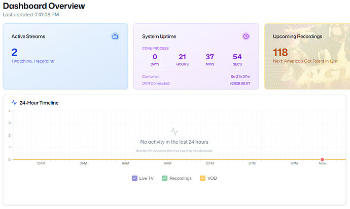

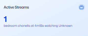

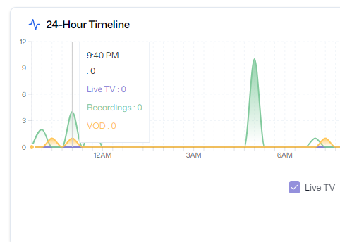

@JefferMC Thanks again for the detailed report. The timeline count, tooltip time, zero-marker, and Active Streams Unknown issues you identified were corrected across v1.0.3 and v1.0.4.
The timeline now clearly represents detected activity events within each 20-minute interval. Your screenshots were very helpful in reproducing and verifying these fixes.

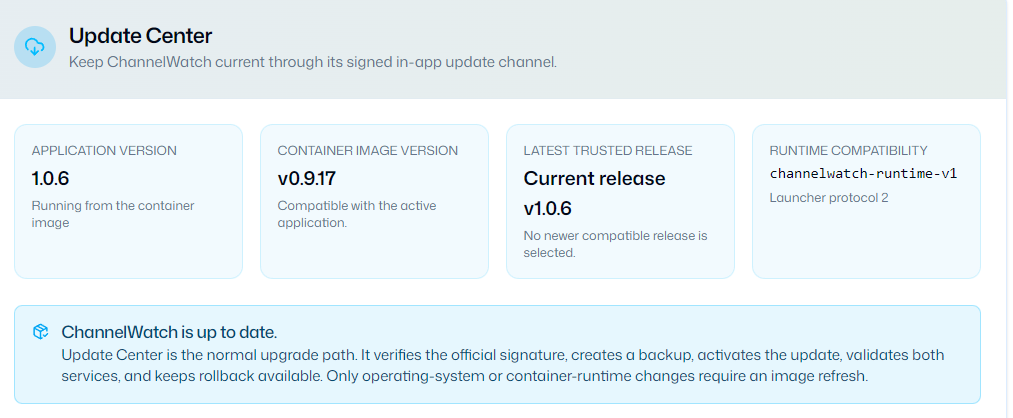

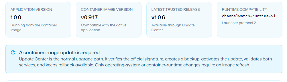

FYI, I upgraded to 1.0.0 by pulling the latest container image, so I expected I would have gotten a 1.0.0 container, etc. However, the upgrade page is telling a different story. I'll upgrade by pulling a new image, but, IMHO, I should have been able to go from 1.0.0 to 1.0.4/5/6 on the Upgrade page:
Update, after the manual upgrade via image pull, the container version is the same
Can you submit this as an issue with the debug bundle?
I can. Or I can wait until 1.0.7 comes out and see if it refuses to update again first.

Since the newly fetched 1.0.6 won't upgrade to 1.0.8 without a new container pull, I did give you a bug report from the app. I also reported another issue with Recording Events. FYI.

Updating from an older version
If you're still on v1.1.3 or another image older than v1.4.0:
Use your normal container update process to move directly to the v1.6.0 image. Back up and retain the existing /config volume and any external encryption-key configuration.
You do not need to install each intermediate release.
If you're on v1.4.0, v1.4.1, v1.4.5, or v1.5.3:
Open Settings > Updates, check for updates, and manually install v1.6.0.
This does not mean every future update can avoid a container image change. Updates to Python itself, operating-system libraries, or the image-owned launcher still require the normal container update process.
If you run into a problem, include the app version, your installation method, and what happened. Please keep credentials and private diagnostics out of public replies.
