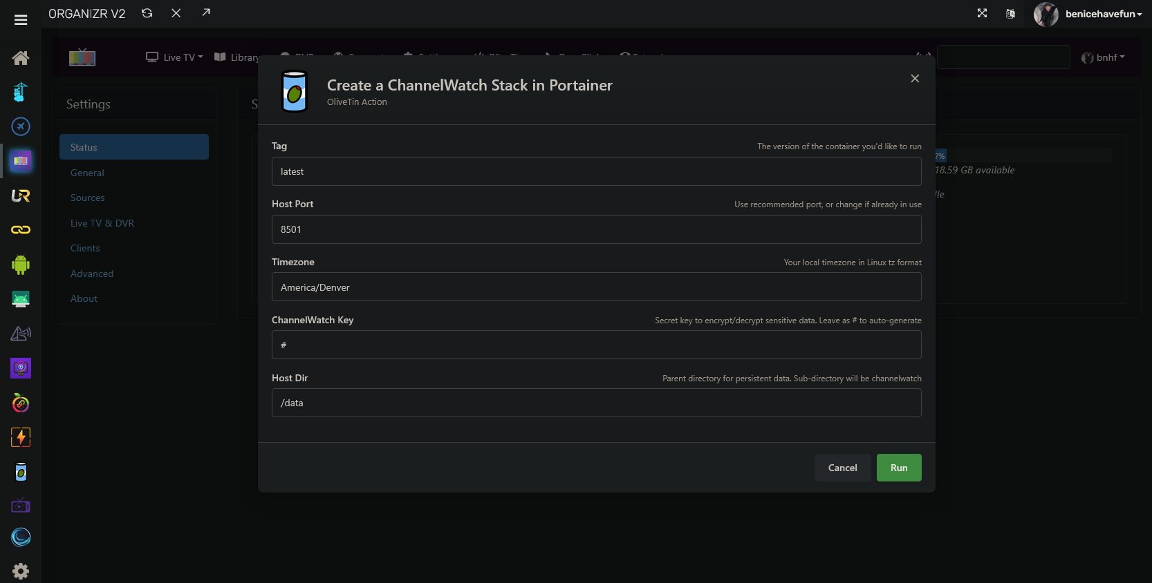

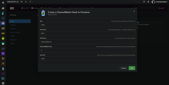

If you want to bypass the one-click project setup, you can run the image directly. Replace /opt/channelwatch/config with your existing config path:
docker pull coderluii/channelwatch:latest
docker stop OLD_CONTAINER_NAME
docker rm OLD_CONTAINER_NAME
docker run -d
--name channelwatch
--init
--network host
--restart unless-stopped
-v /opt/channelwatch/config:/config
-e TZ=America/New_York
Then check the logs:
docker logs -f channelwatch
Open http://SERVER_IP:8501 afterward. Just let me know whenever you want to proceed.

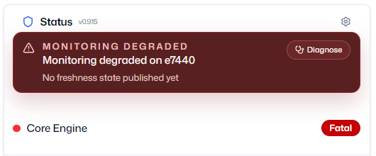

I'm trying to give this a whirl. Not getting off to a great start.
  1. I tried to do a diagnostics upload from the app, but it failed (I think it said it took too long to make the report). That was the second try; the first try disappeared mid-process (though it did keep part of the information; just lost the screen shots, etc.) So... I'm going to try again here:
  2. On container startup, I see some errors in the log. Will paste at end:
  3. Once up, and I visit the page, let it find my DVR install and give it a user/password, the home screen displays this under status:
  4. I clicked on Diagnose and don't really see anything wrong. I clicked on the self-tests and the alerts fail. I set up Discord as a notification target and now they all pass. Though nothing ever shows up in Discord... actually, I retract that. Two warnings have arrived: ":warning: [TEST] Low Disk Space Warning" which is not nothing, but I did a lot more tests than disk space.
  5. I currently have live TV watching set up to alert. I watched live TV through Channels for 3-4 inutes and nothing arrived at Discord.
  6. I did a restart to see if that would fix it. It counted over 35 seconds and then said restart failed. F5 did work to bring it back.
I'll stop here and see if it's something simple and holistic. Container and app logs follow:

core.helpers.atomic_io.SecretStorageKeyUnavailableError: CHANNELWATCH_SECRET_STORAGE_KEY must be set to at least 32 characters before writing local secrets.
2026-08-21 15:42:36,338 WARN exited: core (exit status 1; not expected)

@JefferMC I reproduced the problems in your report. Your DVR connection was working. The API checks against 172.21.0.1 passed. The main failure was that ChannelWatch’s background monitoring process stopped because the One-Click installation did not include the storage key ChannelWatch required. The interface stayed online, which made the installation look healthier than it was.
The notification tests were also incorrectly reporting PASS without delivering, report preparation could time out and lose attachments, and the restart screen could report failure after a successful restart. Those issues are fixed in v0.9.17.
@bnhf you were also right about hostnames. My earlier response was incorrect. LAN, .local, single-label, and Tailscale MagicDNS names were being rejected by the wrong security check. v0.9.17 now supports them through a DVR-specific validation path.
For v0.9.18, I’m removing the external storage-key requirement from normal installations. ChannelWatch will create and manage its own internal key automatically under /config, so new One-Click installations will not need another variable or key to preserve. Existing installations will migrate safely without replacing their DVR credentials. That change is planned for the next release and has not shipped yet.
Thanks to both of you for the detailed reports. They helped separate the startup failure from the hostname and diagnostic problems.

Quick release catch-up: ChannelWatch v0.9.16 and v0.9.17 are available now.
v0.9.16 improves the monitoring core. ChannelWatch now keeps reconciling DVRs when none are configured or one is offline, retries unavailable DVRs automatically, applies notification rate limits across the whole installation, and handles monitor reloads and Update Center recovery more safely.
v0.9.17 addresses the problems reported above:
  • LAN, .local, single-label, and Tailscale MagicDNS DVR hostnames now work.
  • Notification tests no longer report PASS unless a destination accepts the alert.
  • Failed report preparation keeps your text, screenshots, and debug bundle.
  • A successful restart is no longer reported as failed just because DVR monitoring is degraded.
  • Missing storage-key deployments now show a clear setup-required state instead of repeatedly crashing the monitoring process.
Both releases require a normal container image update while preserving /config.

FYI, I didn't use project one-click to install this. I just copied the compose YAML and set up the stack in Portainer. I don't know what difference that makes, but thought you should have that information.
It appears that this means I am responsible to creating a secret key. Just use OpenSSL to create a random key and set it in the environment var?
I looked at the container log first. I now see the message on the site. It's nice and clear.
After setting up the secret key in the YAML and environment vars and deploying that, It now looks more like I expect it to. The "degraded" warning box did come up for a minute or so, but then went away. The alert tests I have done instantly showed up as expected.
yea, im about to tap out of this project. its too complicated just to see who is streaming what. it never monitors and now you have to add a secret key? it gets more tedious as updates roll in and hopefully this gets much easier to use.
@JefferMC Thanks for clarifying! This was not specific to Project One-Click. In v0.9.17, ChannelWatch was not automatically generating its credential-protection key, so monitoring remained blocked until one was added manually.
I’m glad monitoring and the alert tests are now working. Starting with v0.9.18, ChannelWatch will handle the key completely by itself inside /config. Users will not have to generate it, view it, copy it, add it to Portainer or Compose, or think about it at all.

@AeroR1 I understand the frustration. You’re right, this became way more complicated than it should have been just to monitor who is watching what.
The storage key was supposed to be handled automatically, but v0.9.17 required users to create and add it themselves. Without the key, the interface could still load while monitoring stayed blocked, which made the problem even more confusing.
I’m fixing this in v0.9.18. ChannelWatch will create and manage the key automatically inside /config. You will not have to generate it, find it, copy it, add it anywhere, or even think about it.
I’m also improving the monitoring diagnostics so if something still does not connect, ChannelWatch will clearly explain what is wrong instead of just looking like it is not monitoring.
