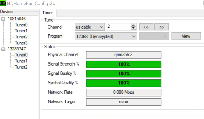

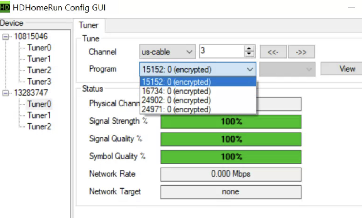

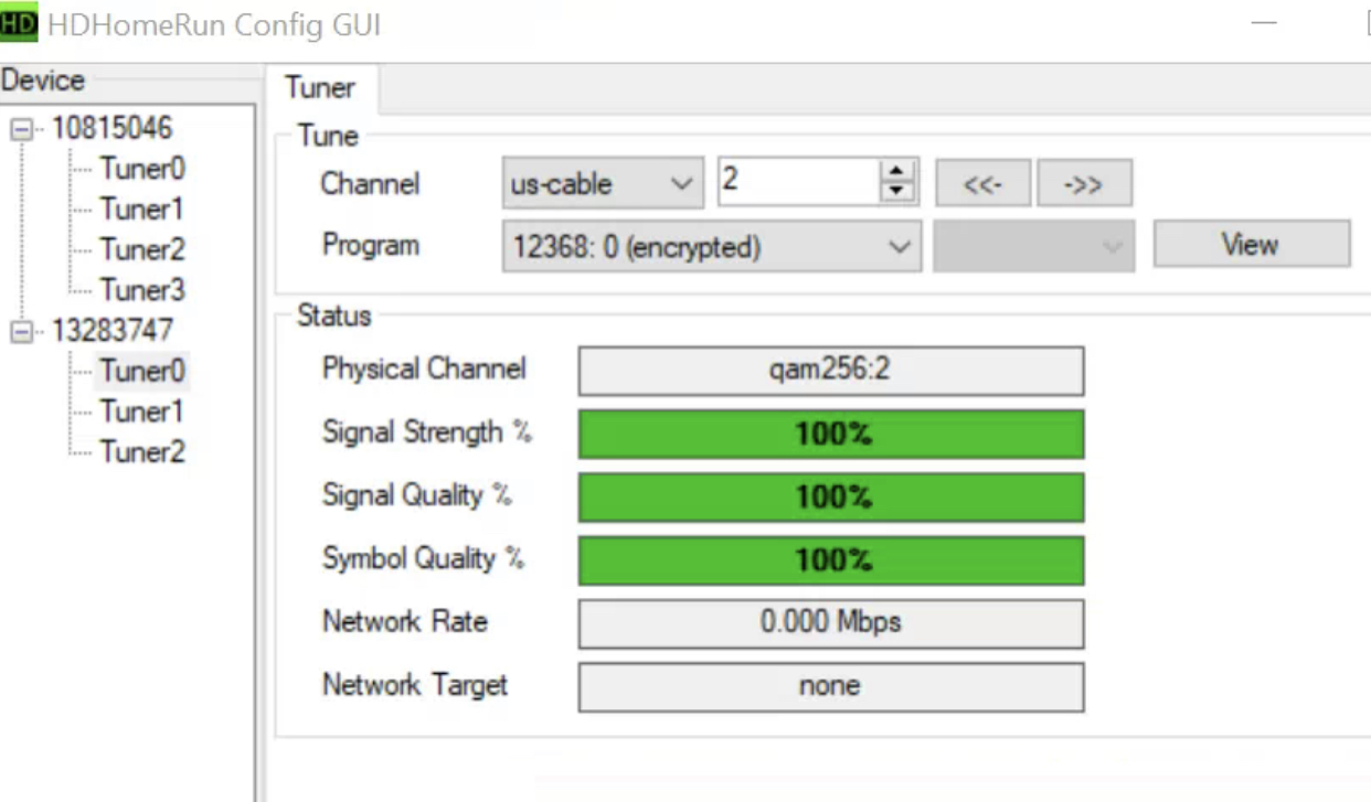

All channels in the HR GUI app show encrypted with the CableCard only.
Do they have "DRM" on the right side?
Just to be clear - they can encrypt channels (this allows them to go all-digital), but they can't DRM them. There is a difference.

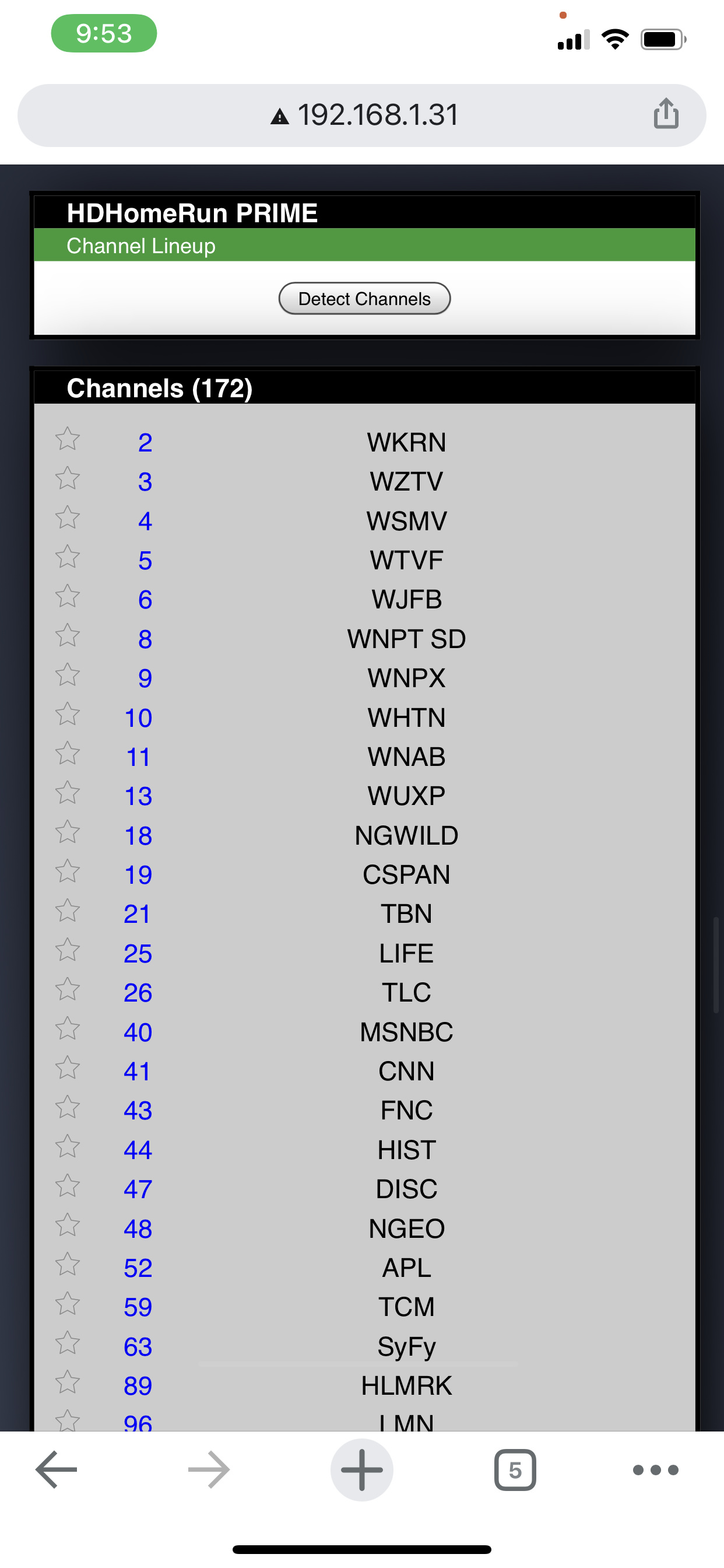

Yep, the "encypted" piece isn't what I'm after - go to your HDHR's web-based gui, then channel lineup, to see "DRM" stats.

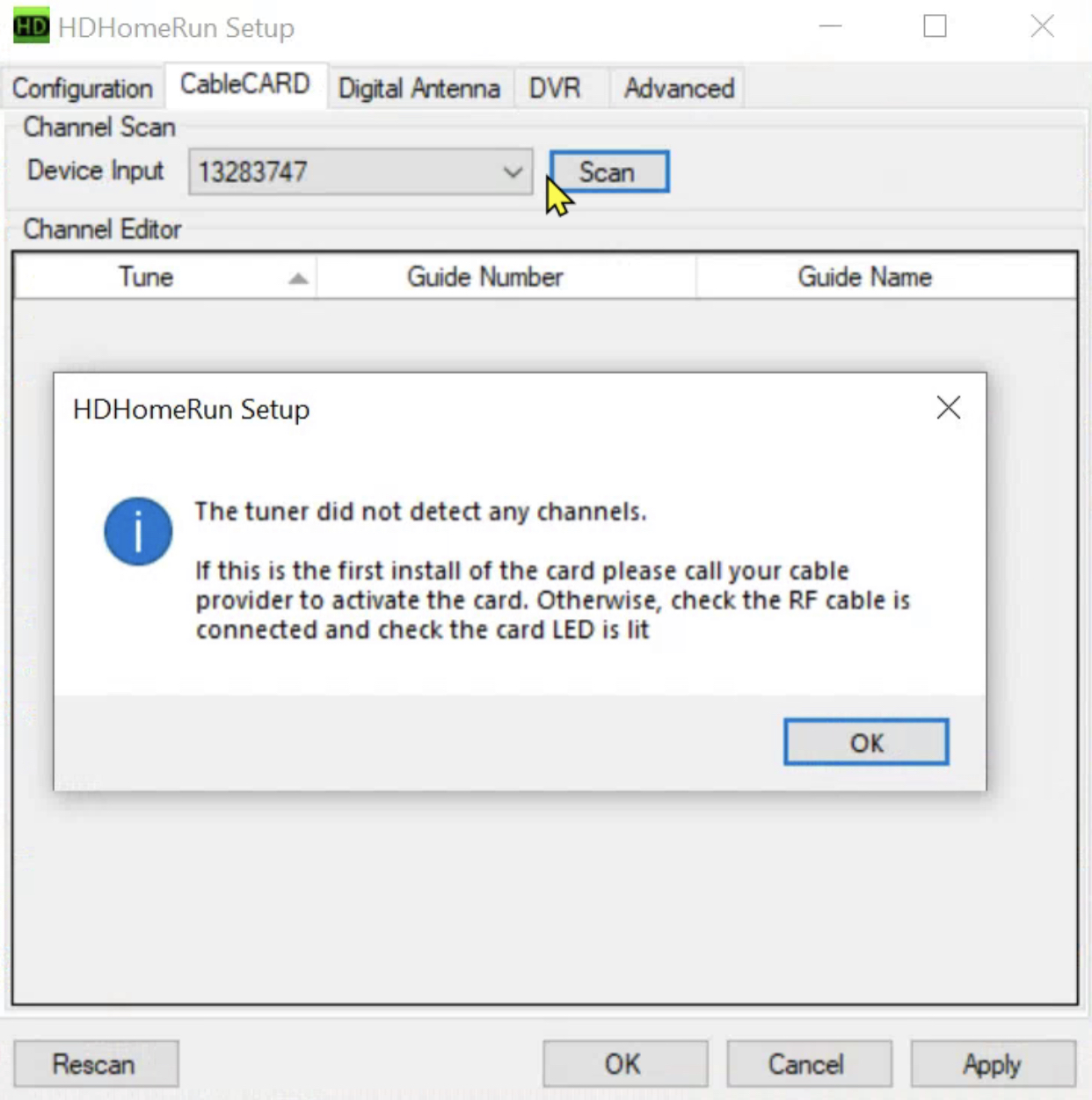

Same. I have OTA for "most" locals. But I can't get some of them. Also my mother needs cable. I have Spectrum Choice (A-LaCarte) package, and cDVR. But that's hers. I use ChannelsDVR, TVE, and now CableCard. I too only care about the locals, as I can record cable from TVE just fine. I'm on the phone with Spectrum now again. They wonder if the activation isn't going through right. It doesn't help the PCMCIA card has a dent in the bottom of the casing. If I should be getting something then I want to know. I have NO premiums, or channels that are beyond basic cable either. Sure recording from there would be nice. But It doesn't matter to me where Cable channels come from. But Antenna based locals HAVE to come from Spectrum.

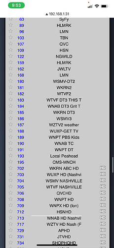

Does your locals come in HD without the TA? I'm in a Charter legacy market too. So SD versions are in the basic cable number range. HD are 702+
Yes, I do not have a TA at all, and get all locals and the Select channels in my list.

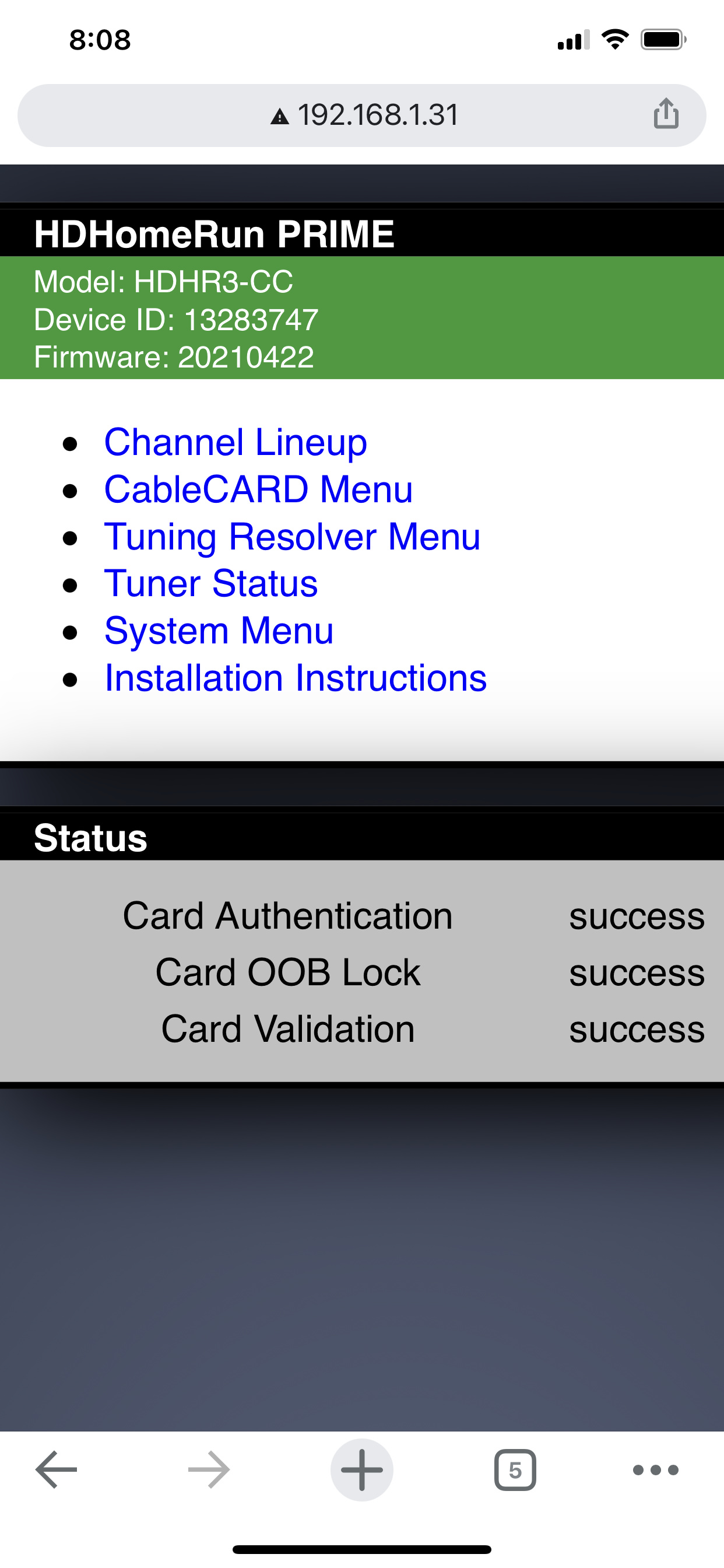

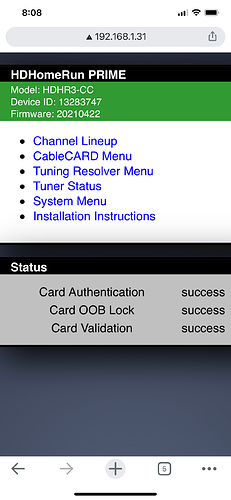

I would absolutely have them confirm the authorization. These things are squirrelly on a good day, so it's worth making them absolutely confirm everything is matching what they see
The card wasn’t active correctly. Now it’s working. All channels show up. Even better NO DRM!! Still need a TA for BBC WSN.
