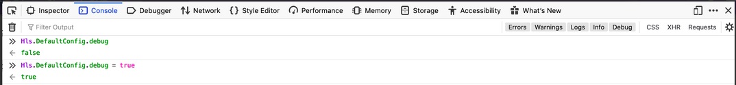

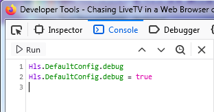

I didn't realize there was a warning showing in the top of the console window after I copied and pasted
Hls.DefaultConfig.debug = true
I didn't see it show up, so assumed it wasn't working.
"Scam Warning: Take care when pasting things you don’t understand. This could allow attackers to steal your identity or take control of your computer. Please type ‘allow pasting’ below (no need to press enter) to allow pasting."
Once I typed allow pasting it worked.
Will try again this week.
Wow interesting, didn't realize firefox was doing this for javascript pastes.

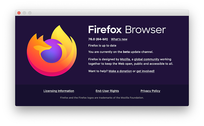

I tried it on Firefox 76.0 on my mac and it works:
Actually in firefox it works even if I change to true after having used the player already in that browser session.
OK, not sure how you got that result.

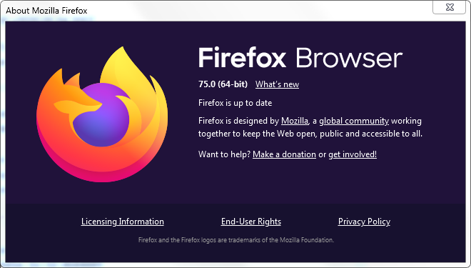

v75.0 is the latest?
Firefox

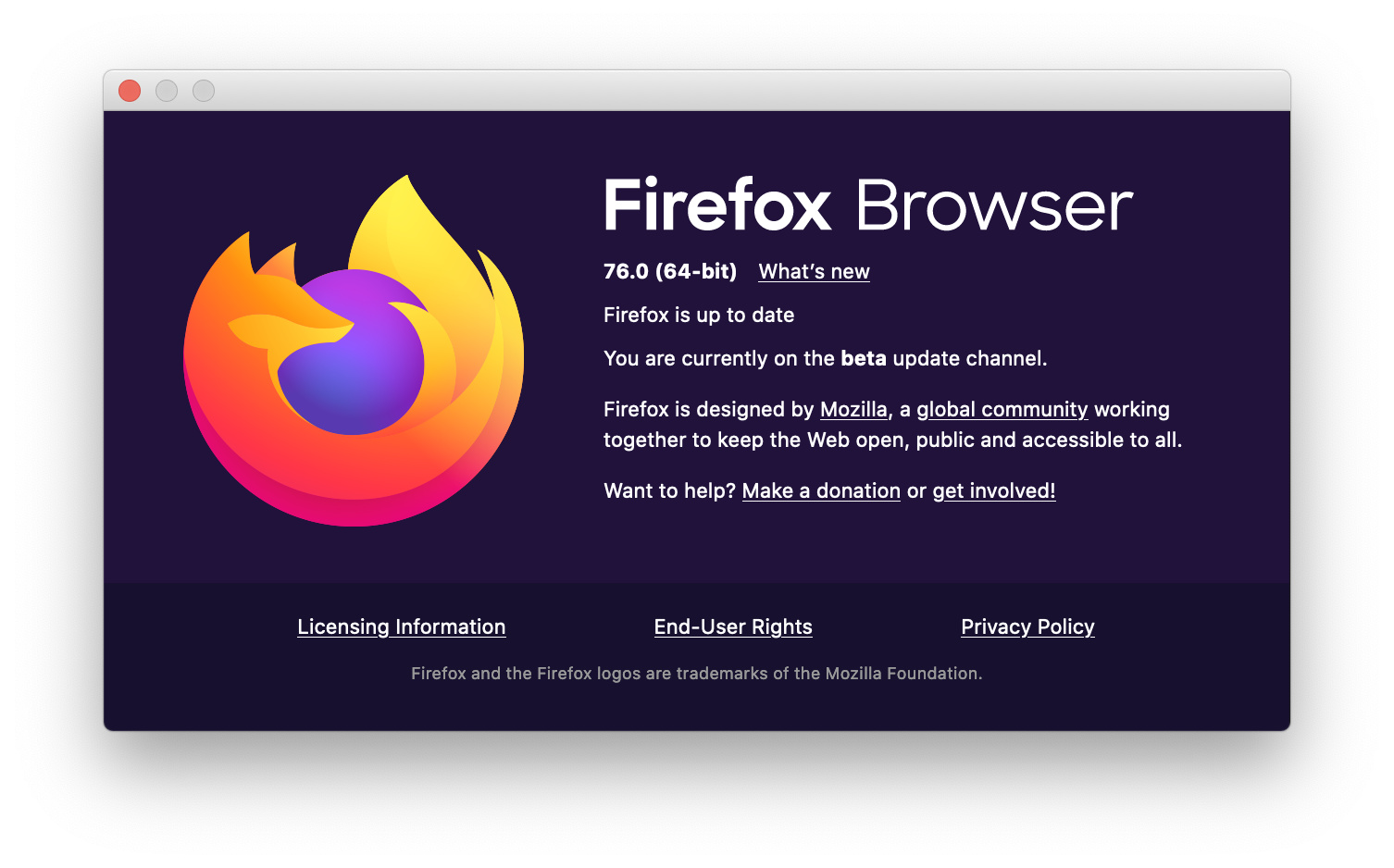

And I don't get that when I do the same thing
Here's mine
Capture2
I guess I'm on a beta channel somehow. I don't use firefox much. It should work on stable. I can try downgrading.
Worked in v75 too. Strange it's not working for you.

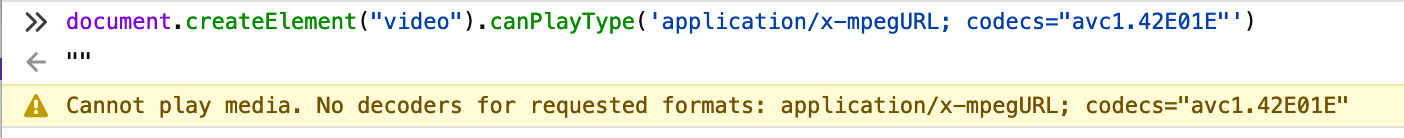

Can you try this:
document.createElement("video").canPlayType('application/x-mpegURL; codecs="avc1.42E01E"')
