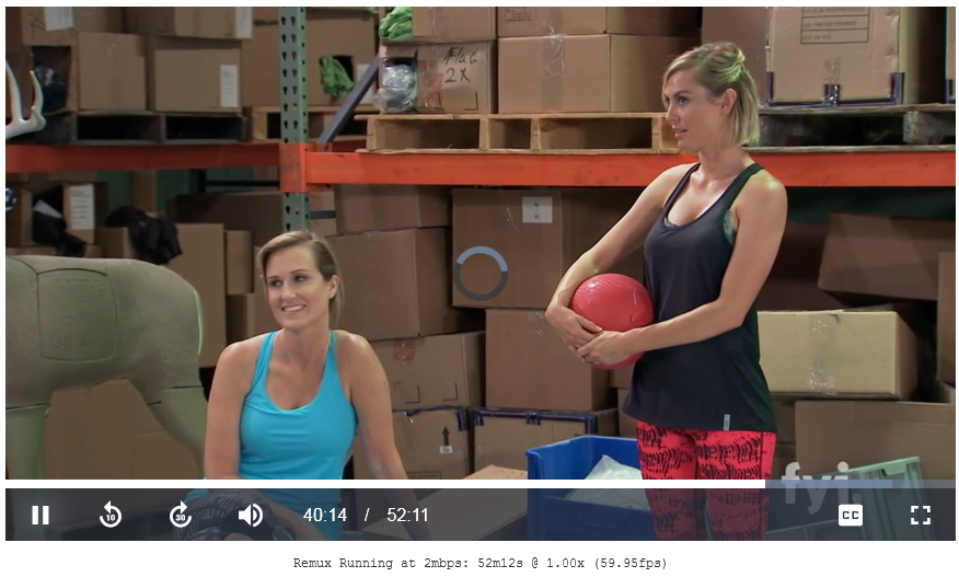

chasing a live cable tv (hdhr prime tuner) local news channel and experienced buffering/pause issues.
Happens during live viewing in the dvr web ui (my channels client), channels dvr recording of the same program has no problem.
For those not in the know...
This means that I've selected a channel to view Live TV from either On Now or from the grid guide from the Channels DVR web UI using my HDHR Prime tuner. Think of this as I've tuned to a cable channel on my Prime and am watching it Live in my browser. Just like a TiVo buffers each of its tuners and you can chase that buffer up to Live (current) time. Only difference is that Channels DVR takes the signal from the HDHR Prime and remuxes it (and whatever else it does?) to provide the video/audio that the Channels DVR web UI browser player can play.
I start viewing by selecting the channel through the grid guide or watch now, then pause at least 10 seconds before playing to eliminate any issues with buffering.
After watching for over an hour (pausing and resuming and skipping forward, at most 30 minutes behind) it reaches a point where it just shows the buffering circle and will stay there forever unless I skip forward 30s and resume play.
P.S. I always pause at least 10 seconds on any Channels live OTA/CABLE/TVE viewing to avoid Channels buffering issues.
Happened again, chasing cable Live TV on a channel and it suddenly stops like it's buffering, even though I'm 40:14 into the 52:11 buffer.
Cant skip forward or backward.
I can select a point on the timeline in the past and play up to the exact same point where it stops again (at 40:14) and acts like it's buffering again.
Cannot click forward in time, no response.
DVR log doesn't show anything usefull;
2020/04/28 19:31:23.795241 [TNR] Opened connection to 1323AADB/0 for ch772 FYIPHD
2020/04/28 19:31:23.796014 [HLS] Starting transcoder for channel 772 from 192.168.1.2 (encoder=remux, resolution=, deinterlacer=, bitrate=0)
2020/04/28 19:31:24.850805 [HLS] Probed live stream in 1.054595573s: h264 1280x720 progressive 2207649bps
2020/04/28 19:31:26.790527 [HLS] Session ch772-dANY-ip192.168.1.2 started in 3.533185767s
2020/04/28 19:31:26.791709 [ENC] Starting encoder for ch772 in /volume1/arkives/ChannelsDVR/Streaming/ch772-dANY-ip192.168.1.2-200318500/encoder-1-717094195 at 1 (1.504656) (encoder=remux, resolution=720, deinterlacer=hardware, bitrate=2207 segment_size=0.01)
2020/04/28 19:31:26.835474 [HLS] ffmpeg: ch772-dANY-ip192.168.1.2-1-copy-aac-2207-128-720-0-0--hardware-false-false-0.01:  [h264 @ 0x3598e80] Increasing reorder buffer to 2

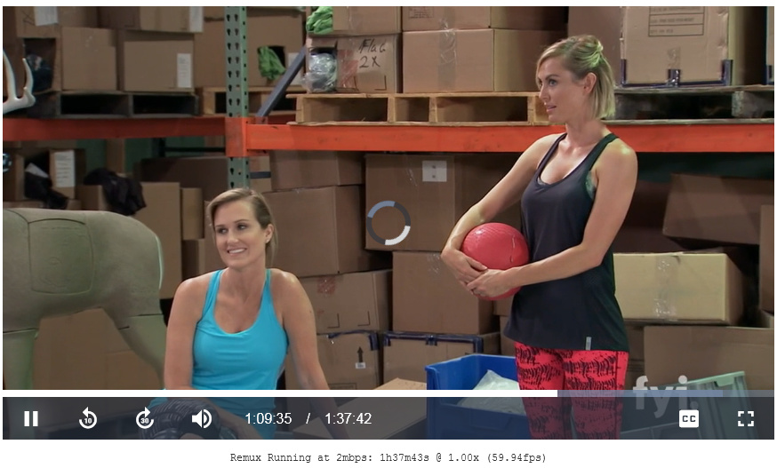

OK, got it to happen.
Was watching LiveTV, started from the grid guide Watch Now.
Watched and would pause when commercials appeared, waited 3+ minutes then play and use 30 sec skip forward to get through commercials, never advancing more than 10 secs behind LiveTV.
It finally stopped and appears like it's buffering at 1:29:36, sent diagnostics b0c6ce34-7bda-4214-a886-e04d1b257c79. I tried skipping back 10 secs and it did, but stopped and appeared buffering again at the same point 1:29:36.
Console logs don't show any error I can tell, see below;

Have you had a chance to look at the diagnostics I sent?
Wanted to add some additional info.
I did the same thing tonight (chasing a live cable channel) with Firefox on my laptop running the same OS and same Firefox browser version as my desktop I reported the issue on.
I don't remember the exact point in time (maybe 36 minutes of 40 something minutes into LiveTV), but it stopped playing and was showing the buffering circle.
I waited a few seconds and clicked the 30 skip forward button and it skipped forward and continued playing.
I then kept clicking the 10 sec skip back button until I was before the previous buffering time and let it play.
When it reached the same time where it had stopped before, instead of stopping this time it just skipped about 6 secs ahead and kept playing.
Repeated the above and it skipped 3 secs ahead and continued playing.
Repeated that again and it skipped 1 sec ahead and continued playing.
I was just trying from my laptop to make sure it wasn't just my PC having the issue, so didn't send diagnostics.
Here are the stats for that session from the Channels DVR log
2020/05/02 19:54:16.517017 [SNR] Statistics for ch747 FOODPHD: ss=97%-98% snq=100% seq=100% bps=3922060,995648-5632480 pps=377,114-535
Maybe was some video or audio or timestamp glitch?
