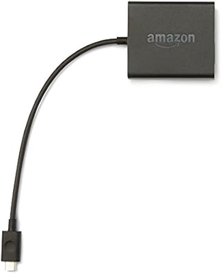

It's powered off one of the Sony Bravia TV's own USB ports, which is marked "5v 500 mA max", through the Amazon Ethernet Adapter. In other words, both the Ethernet Adapter and the Fire TV Stick 4K are powered off the same USB port. It's been running flawlessly for so long, about 14 months, that I had to take a look back there to remember what I'd done.
So yes, it powers on and off with the TV, but that happens while the TV itself is also starting up, and adds no additional delay. It's been started thousands of times with no problem. I don't think it matters what apps you have running.
For all I know, it's the regular restarts that keep mine working well. Aside from that, the best suggestions I see here here revolve around the hardware/software encoder settings, and I would add also maybe your network speed.
While a wired connection is usually better, the ethernet adapter is only 100Mbps. Depending upon your wireless network, you may actually get better network throughout going that route ... my FireTV sticks regularly get 350+Mbps on wireless.

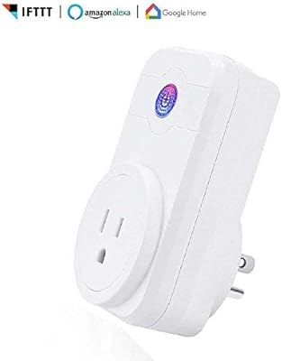

You can do it if you have a smart-plug or smart strip where you can schedule power-off power on.
Something ike this for firestick
