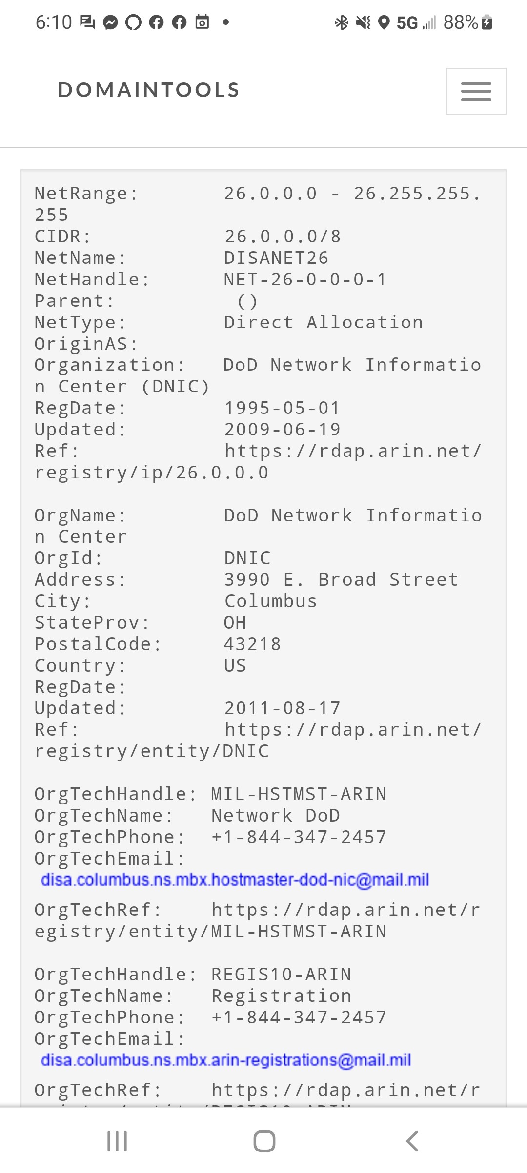

I don't know where these 26.x.x.x IPs are coming from but that may be part of the problem.

@Baseballgal12 do you work for DOD? That ip looks like its to them.
no I was using a vpn I since deleted it
