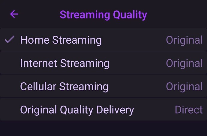

I also have a 1 Gb/s fiber connection and remote streaming works fine with remote quality set to original.
With a high speed Internet like this, there is no need for transcoding.
What are your settings for remote streaming?
Not sure what you mean. Can you explain in more details?
Setting the web viewer transcoding options is what I was referring too.
Adjusting the quality to original quality has made a very marginal improvement but the buffering problem persists.

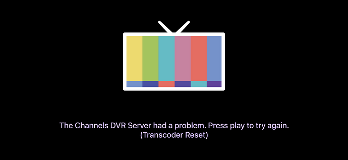

I just got this error.

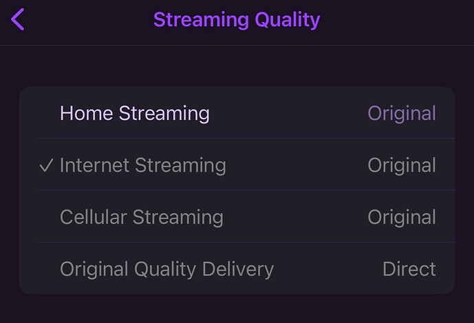

The web interface transcoder settings dont have anything to do with remote streaming. It sounds like your server cant keep up with transcoding. I agree with @mjitkop just set everything to original quality and don't worry about transcoding.
This error shows that you are still transcoding. Make sure your settings look like this on the client
I was just continuing the discussion from the other thread, specifically what @tmm1 asked the other poster.
Nope, all set to original.

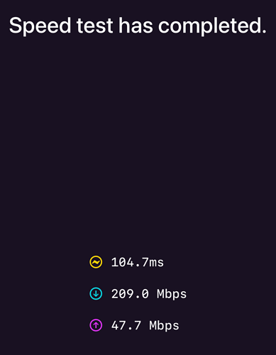

Also do a speed test from the client to the dvr in settings and post the results of that as well

Speed test:
