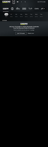

Here's the tve_error_screenshot.png from trying to play AHC.
and Cooking channel
To clarify I get the same “no login found” error when using AppleTV. I just wasn’t getting it in the admin interface. This is using Philo as a provider.

Cooking Channel Website: Works
Cox TV Go: Works
Channels: Didn't Work

Yes, it is fixed. Thanks, developers!
Almost exactly the same scenario with me. Cooking channel doesn't work through TVE, but does on the website (and I can auth with Hulu).
