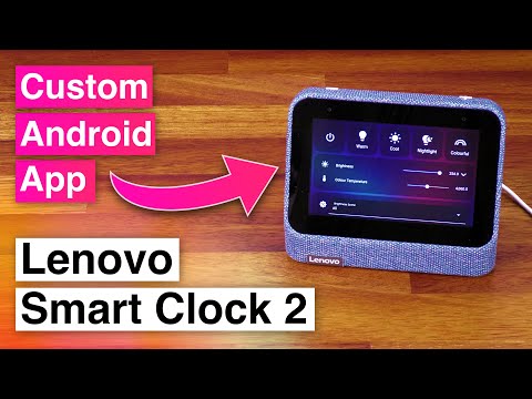

This is fun, the Home Assistant community has discovered our favorite little smart clock and its uber customizability, once ā€œjailbrokenā€ and APKs are sideloaded. It will be fun to see what other discoveries, tips and tricks are shared as it gets even more popular.
Glad I grabbed a bunch of these!
Oh, and here’s a much more thorough and professional video tutorial including details of how to block it from the internet while still allowing it to operate as a smarthome controller:
