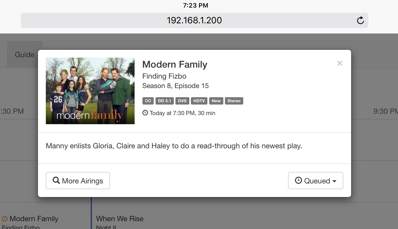

Whoa! This happened to me tonight too. Modern Family didn’t record as it was supposed to. Aman, I should still have the logs if you want to see them.
A few pics from the time:

Okay, I think I figured out what happened here.
Every episode has a unique ID, and the DVR uses that to keep track of what’s recorded or queued already to avoid making multiple recordings of the same episode. The ID for yesterday’s episode was EP011581240210.
In this case, it seems like the guide data was incorrect a few weeks ago. The episode that aired on 2/22 was originally listed as EP011581240210 but was fixed before the episode actually aired. This caused a stale entry in the database which made the DVR think that that episode had been queued up to record, even though the job it was referred to 1) was for another episode and 2) had already expired.
I’ve made a fix to prevent this from happening again.
