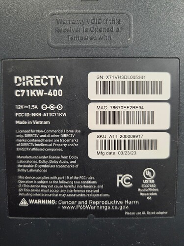

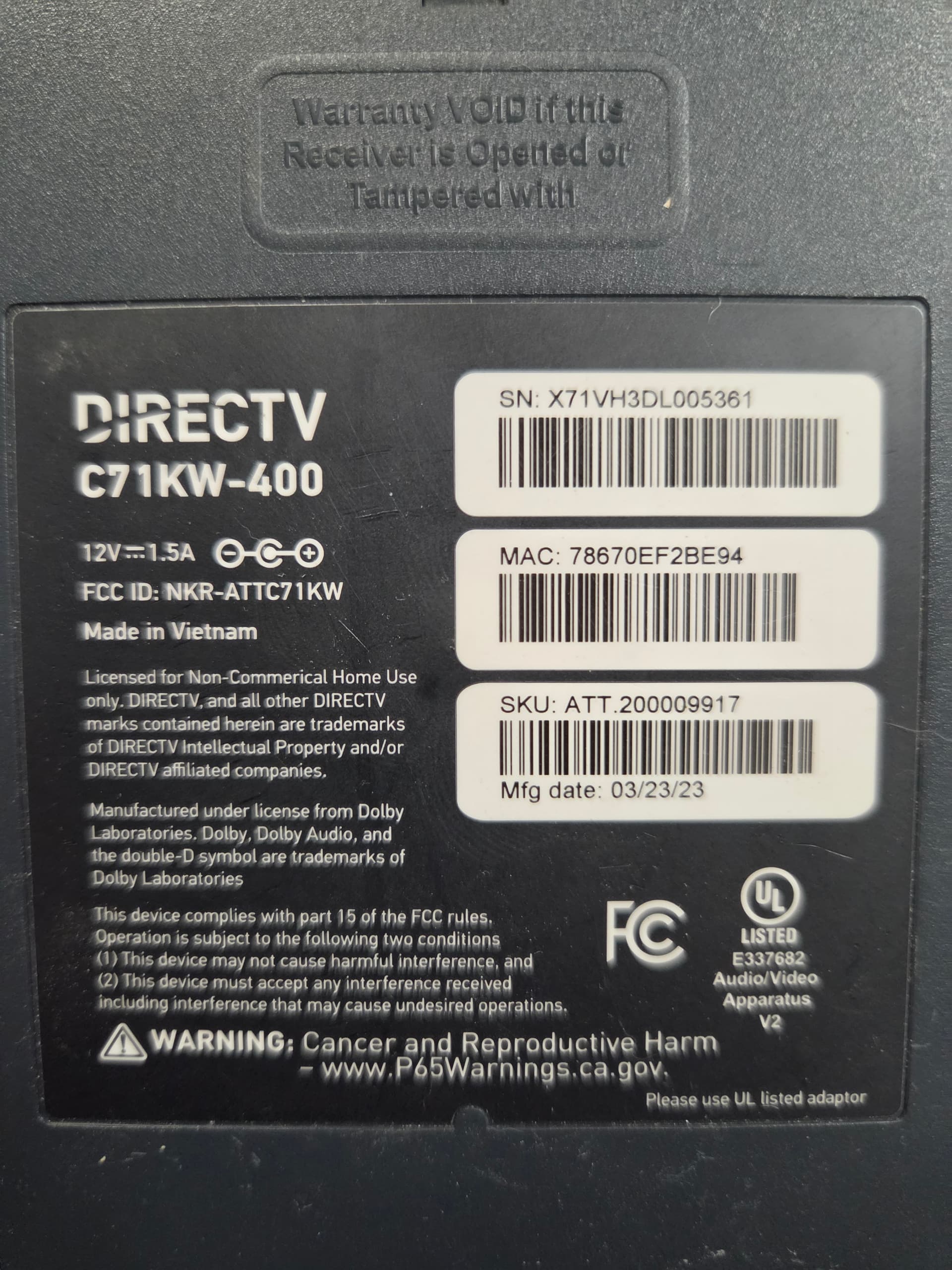

I also got my Gemini box from DirecTV. Officially, they are now giving out black label Ospreys. This isn't even like a Gemini Air or that new Osprey prototype we saw. This is a regular Osprey, just a black label. It came to me brand new with a manufacture date of 2023. I was told by a representative that they discontinued the Gemini Air devices. What is incredibly encouraging is this device that I received is running the exact same Android 11, the exact same open video client, the exact same firmware as the old 60233s I have sitting in my taco tray. So they're clearly not discontinuing this line of devices anytime soon. I think we have another couple of years left in them, guys. :smiley:
look like this?
this one is running the satellite firmware, there's supposed to be a way to get it on streaming, but it doesn't survive a reset, so I haven't even tried yet. maybe your buddAi can get the full streaming firmware for these boxes.
Exactly like that, except the box said DirecTV Stream. Like it looked almost like new old stock.
