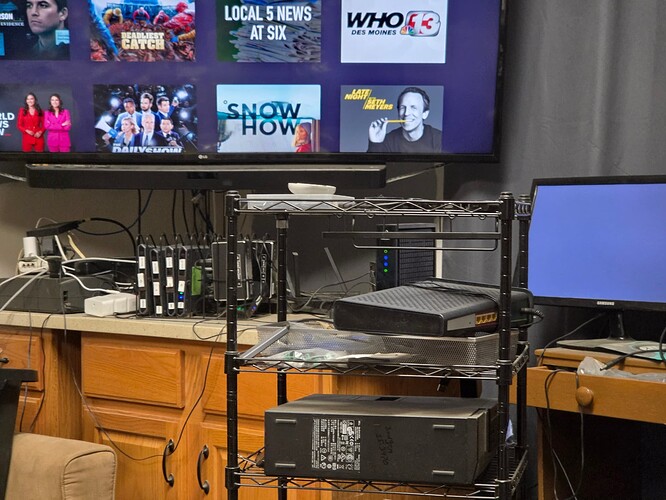

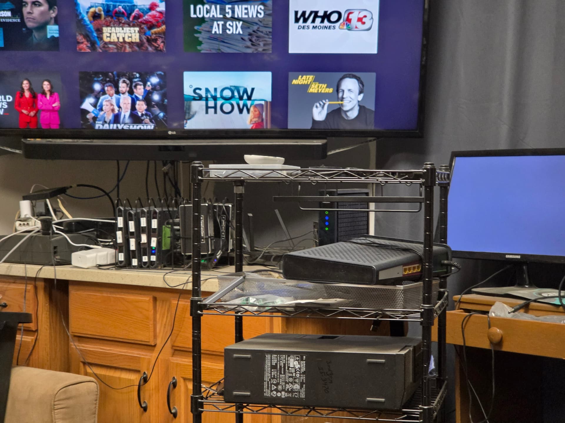

that old dell at the bottom was my emby machine that got the rest of the mess started. (you can't even see my minipc buried back there) the dell has been outfitted with ssd's and 20tb for 8 months, waiting for proxmox
I want to properly label my ospreys now. Right now they're all just painter's tape and permanent marker.
At some point, I have to get a Brother P-Touch to get them properly, nicely labeled.
somehow a year after I left my first full time job (upgrading office buildings from cat3 to cat5) I found one of their p-touch's in a tote. :man_shrugging: that was 25yrs ago and it still works, and the label tape is still expensive but worth it.
little tip, the middle label numbering the boxes is actually 2 peices of magnet tape. the piece stuck to the osprey has a hole drilled in it for IR, so I can quckly pull off the labeled magnet and control any box with an old directv remote.
I heard you could control Ospreys with a regular old white DirecTV remote. Honestly, the P-Touches aren't that expensive on Amazon, like maybe $50.00 or so, and they do last forever, so it's kind of a worthwhile investment. The tape is kind of expensive. It's the whole shaving handles and blades scheme, printer ink scheme, the same thing.
Finally, a setup messier than mine!! :rofl::joy:

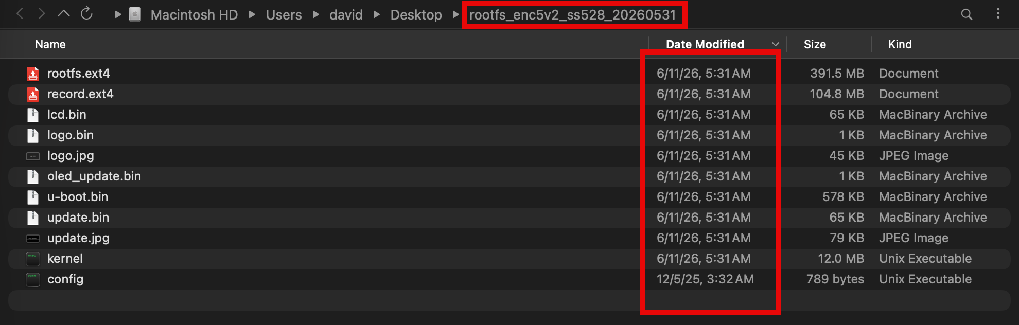

This is a little too salient in terms of timeline to be coincidence. This is the most recent firmware released by LinkPi. I just downgraded to the previous April firmware and so far so good, but I'm still testing and my fingers are very much crossed behind my back. @Shaggylive you've been very helpful throughout all of this. Are you on the older firmware with your encoders?
Edit: I just ran two concurrent streams, one on a downgraded encoder, ENC5-V2, and one on the current firmware. And the current firmware one tore down, and the one on the previous firmware has persisted three tunes.
So, are you thinking the encoder firmware is part of the issue. Way above my pay grade.
I'm on the initial firmware from when I received my Link Pi unless it did it without telling me. Maybe that's why I never see your issues. I'm not big on updating unless I have an issue. Didn't you have an issue in the last year with flashing?

Oh, I almost always upgrade my LinkPi encoders when an update comes out, and I guess that's a mistake because you're running a build from 2025 and I was running just the latest from this past June, and that's when I started hitting issues. The timeline lines up perfectly and the issue of like HDCP and ad related teardowns kind of connect with a bad HDMI link. Since I'm a bit of a mad lad, I have Claude diffing the firmwares and, like decompiling it because I don't really care, and I just want to see what it can find.
