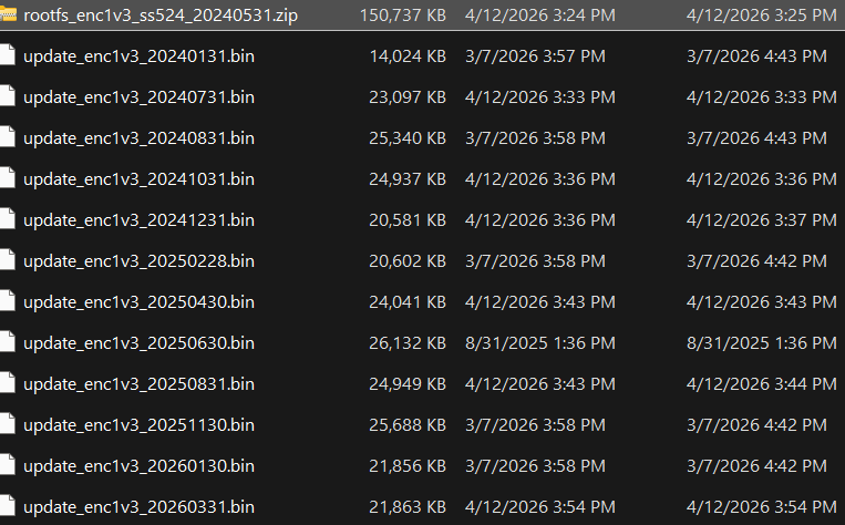

5.1.0 build 20260331
but I did update one to
5.2.0 build 20260531
no difference in my problem yet, but again, mid process here.
I do have an archive of firmware
if anyone needs one of these, let me know and i'll share a link.
