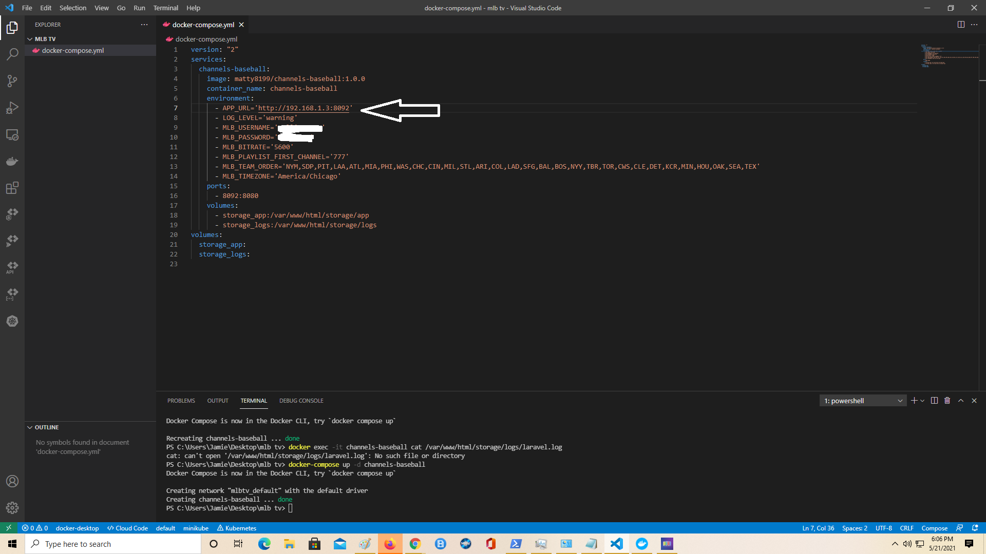

So just making sure nothings off with anything I've entered. Here's a screenshot of my channels dvr server from before putting in the command.
I'm including it just to make sure that nothing is wrong in the compose file shown here
Or that these aren't wrong for the custom channel source and guide links: http://192.0.0.1:8092/m3u

i am still not sure if using localhost or 127.0.0.1 for the APP_URL will work. it might if you're running it on the same server as channels, but i can't promise you it will (because i haven't tested it). that's why i said in the instructions to use the actual server IP there, because i know that will work.
The IP from the DVR screenshot shows 192.168.1.3
@Mulliganman in that case, change the APP_URL env var to this:
APP_URL='http://192.168.1.3:8092'
Like this shown here:
I put in the 127.0.0.1:8089 because I thought that's what you meant. I'm going to delete it from Docker Desktop again and will try to run the compose command again.
yep, exactly like that. you'll need to run the docker-compose up -d command again after changing it.
