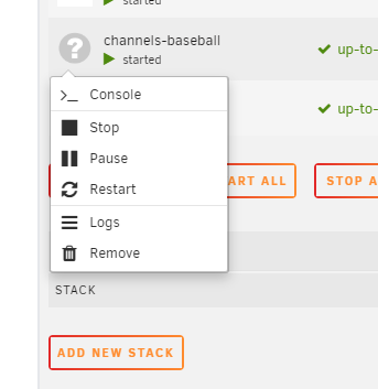

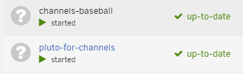

How do I get this set up in Unraid so I can make changes to it as needed, inside Unraid, instead of using a prompt? When I install it, there is not an option to click on a link to edit the Docker settings. It's just a solid name and not linked like all my other dockers. IE Channels, Pluto-For-channels etc...

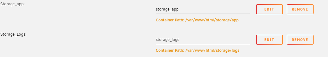

Nevermind. Got it figured out. got stuck with the Paths. But here they are if anyone is interested. The Variables are just copy and paste it's the path that I had difficulty with.

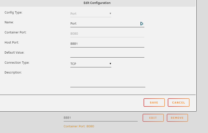

Here is the port configuration if interested. Your port can be different but the container port is the same port as Channels.
