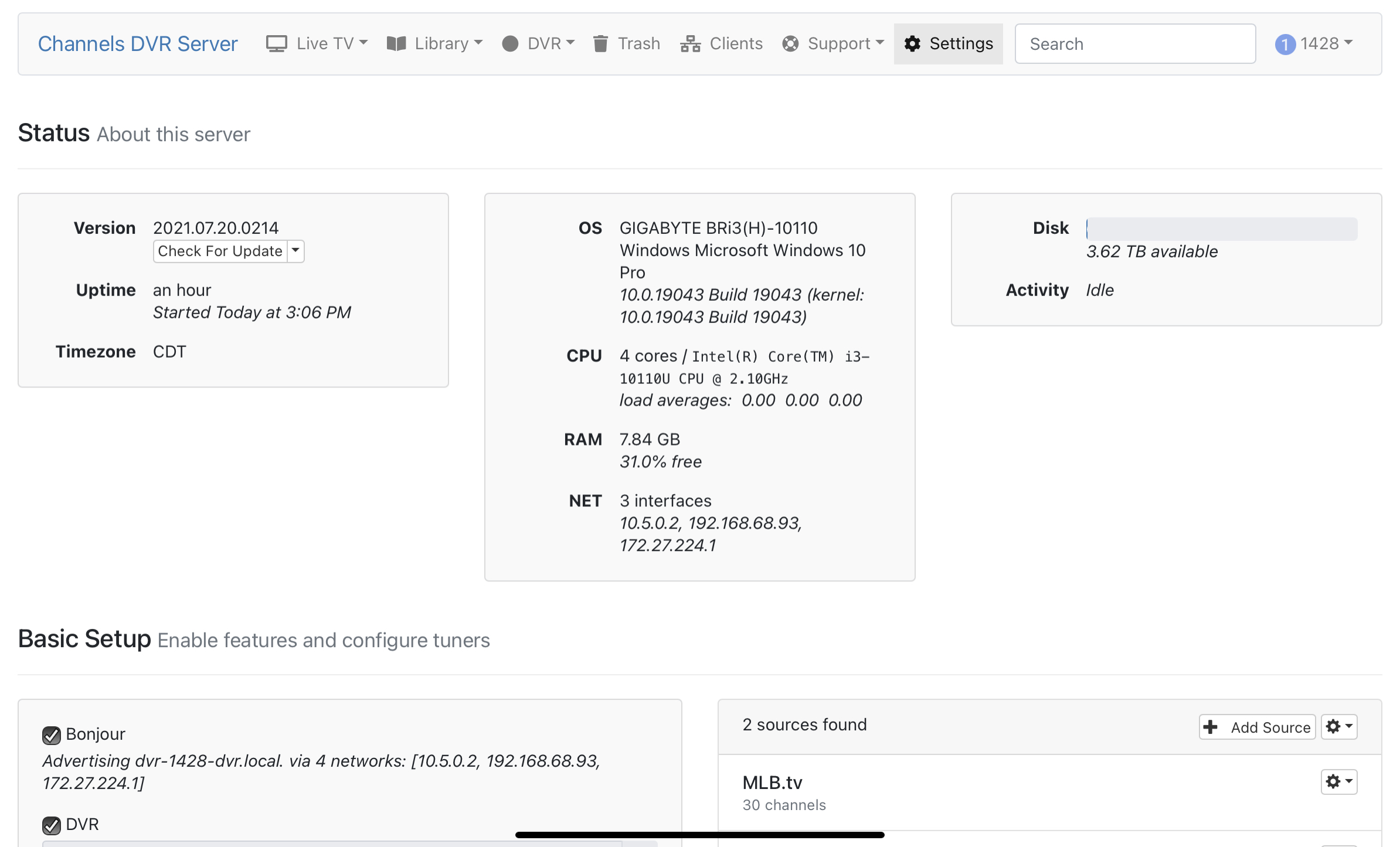

Some additional context: The Closed streams were all user-initiated because the stream had hung. The “Could not fetch playlist” errors were when I tried to pull up the stream after it hung and was shown the error in the photo above.
What device is using IP address 192.168.68.93? Is it set with a static address? Looks like it’s hard coded into your m3u?
I have a headless Mini PC that’s running Channels and Docker.
So the 192.168.68.93 address is permanent for it?
I ask because the error messages indicate connectivity issues to the server at that address. Just trying to make sure it’s not changing IP addresses.
It's permanent – hard-wired into a gigabit switch and assigned by my router.
So both TVE and m3u streams hang?
Something (at least in the MLB docker) is closing the connection as if the docker container hung or a firewall/virus scanner is preventing access if that's the IP:port of the container.
dial tcp 192.168.68.93:8080: connectex: No connection could be made because the target machine actively refused it.
Did you check your Docker logs and the Docker Container logs for errors?
Possibly Windows Docker issue

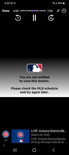

That seemed to help! But I'm not there yet. Now when I tune to a live game in Channels, i get the following screen that says "You are not entitled to view this stream." Is this a known issue? The stream works in the mlb.tv app.
What issue? Have you paid your subscription? It is a known issue that If you don’t pay, you don’t get to play.
Or it thinks it’s a blackout?
The Mets fans are all over this thread right now! Probably because SNY is broken and we're trying to figure out alternatives.
I just subscribed to the 7 day trial and the stream i am trying to play, plays both in the MLB app on my phone and on the MLB.tv app on my Apple tv. But no luck getting any stream working in Channels for the first time
No idea. I can’t do anything until free mlb from T-Mobile next week.
Are you located in the NYC metro area? It may be a still be a blackout. See if you can view other teams without issue. If it is a blackout issue PM me (and anyone else that has the issue) and I will help you correct it. No VPN's, modified code or anything illegal. (I'm not going to give instructions here because the author of the docker container asked me not to so I want to respect his wishes but I will gladly help with in-market issues).
7 day trial brings you right up to the tmobile Tuesday day
But he said it works in the mlb.tv app, so that wouldn't explain it...
