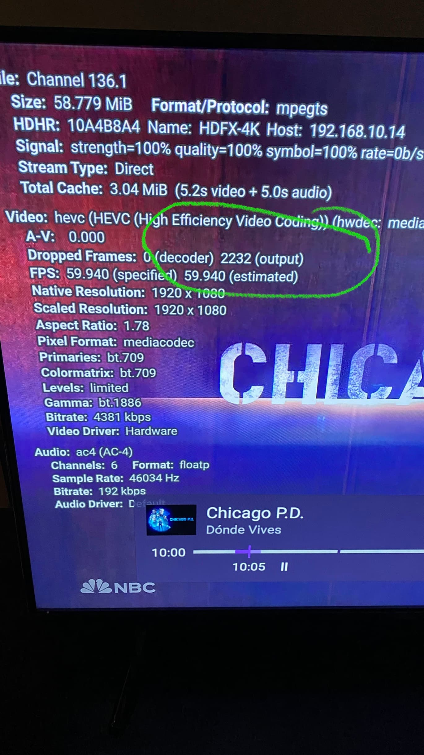

I have a couple of Fire Stick 4k devices on my network that I use with Channels. I also have an Apple TV 4k that is on my main television. I do not watch the Fire Sticks that often, but I have noticed the past few times I have watched any 1080i content from my HDHomeRun tuners it looked choppy. I turned on show stats and it is dropping a lot of frames. Several hundred in a very short period of time. I have tried switching from hardware to software decoding with the same results. This does not occur on 720p channels or on 480i content. Those channels play just fine. I can also view the channel in the native HDHomeRun app and it looks fine. This is something new that occurred after the latest update to the Fire TV interface. Before the last update, everything worked well. I was curious if anyone else has noticed this or if it is just me. I would appreciate any input.

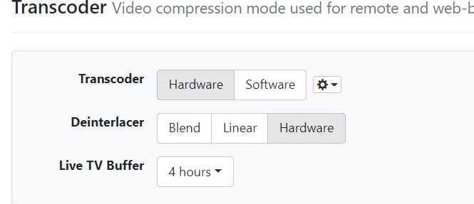

Did you check the web server to to use Hardware de-interlacing ?

At least I know I’m not crazy now! When it was on version 4.4.1 everything worked fine. When it changed to version 4.5.0 that is when I started noticing the issue. It only does this on 1080i channels. If you are just watching news or a show without a lot of movement, you do not notice it so much, but if you are trying to watch a football game it's horrible. You are correct the picture is jittery and looks like it is "tearing" if you keep watching long enough on mine the screen will eventually go green with audio only. The only recourse at that point is to reset the firesitck. 480i, 720p and TVE channels do not exhibit this behavior. Recordings of 1080i channels will do the same thing. If you go up and enable show stats, you will see that it is dropping hundreds of frames in a very short time. What is interesting is that the native HDHomeRun app does not do this, so I know it is something with channels. I have a CBS and NBC affiliate that are both 1080i and I watch a fair amount or programming from those channels. If I record a show from either of these channels and put the recording in Handbrake and re-encode it as MP4 and strip the interlacing out, they play fine. Firestick was may main device when I first started with Chanels. I moved my main tv to Apple TV and it works flawlessly on that platform. I do not want to put that kind of money out for every tv that I own though. Right now my firesticks are on extra tv's that are not used a lot and it is not a huge issue at the moment, but I sure hope they figure this out in some future update. I am assuming this has something to do with how channels is accessing the hardware decoder. I have tried switching to software decoding and that is a little better, but the end result is still the same. Let me know if you figure anything out.

On my firestick I only have an options for Video Decoder and it is set to Hardware at the moment. The Video Driver setting is only on my Apple TV. I have tried Software decoding with not much different results. In the beta version of the app, I have had a little bit of luck enabling Legacy HDHomeRun streaming. That will stabilize things for a bit (like about 15 min.) then the picture will start to look choppy again and sure enough it is dropping frames on the output like crazy. Right now I am watching a motorcycle dirt race on NBC and at times it looks like it is in sow motion. I will submit my diagnostic logs if that will help.

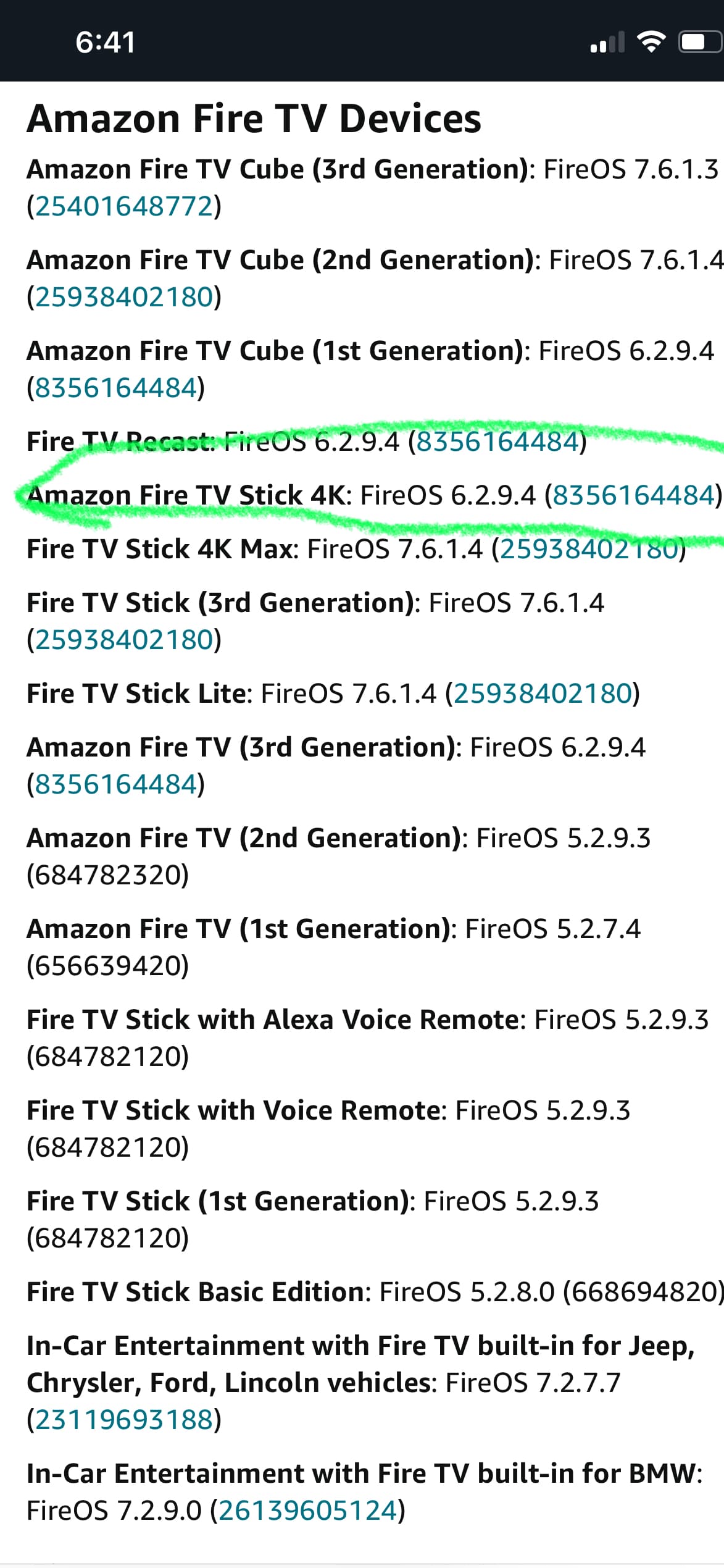

Looks like there may be a few updates since the original version. I just checked mine. I am running the latest version 6.2.9.4 NS6294/4239. I remember it working fine when I first got it and then did updates, this is when the problem started. Not sure what the last “working” version was though.
Change log from AZ:
https://www.amazon.com/gp/help/customer/display.html%3FnodeId%3D201497590
