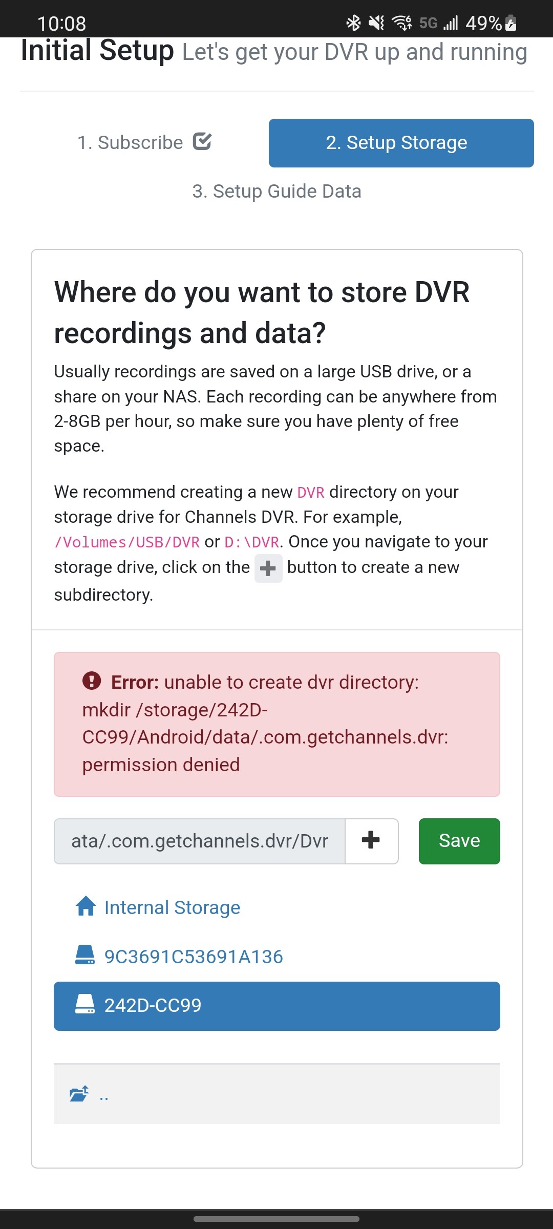

I see you have two drives attached to your SHIELD?
@stevecccc Do you also have more than one drive attached?
Installed newest prelease, and submitted dianostics. 6ded5587-dbc0-42f4-b262-b4707ffc39a0
Yes I have two external drives, my main drive has always worked, and is a Samsung 500 gb SSD
FYI, both external drives give a write error, only internal shield storage will allow me to continue

Looks like it changed the storage path and can't find it ..
Recording 2969 (TV/FBI Most Wanted/FBI Most Wanted S03E11 Hunter 2022-01-11-2200.mpg) missing: stat /storage/emulated/0/TV Shows/TV/TV/TV/FBI Most Wanted/FBI Most Wanted S03E11 Hunter 2022-01-11-2200.mpg: no such file or directory
Yes, more than a few times. I wish it was that easy!
Uncheck the DVR checkbox, edit the box below to remove the double /TV at the end. Just leave one /TV instead of /TV/TV
Can you try using a different path, matching this pattern. You might need to click + and enter each part until it builds up the entire thing.
/storage/XXXX-XXXX/Android/data/com.getchannels.dvr/DVR
Curious if that gives you the same permission error or not.
Got it... working now...thanks.
