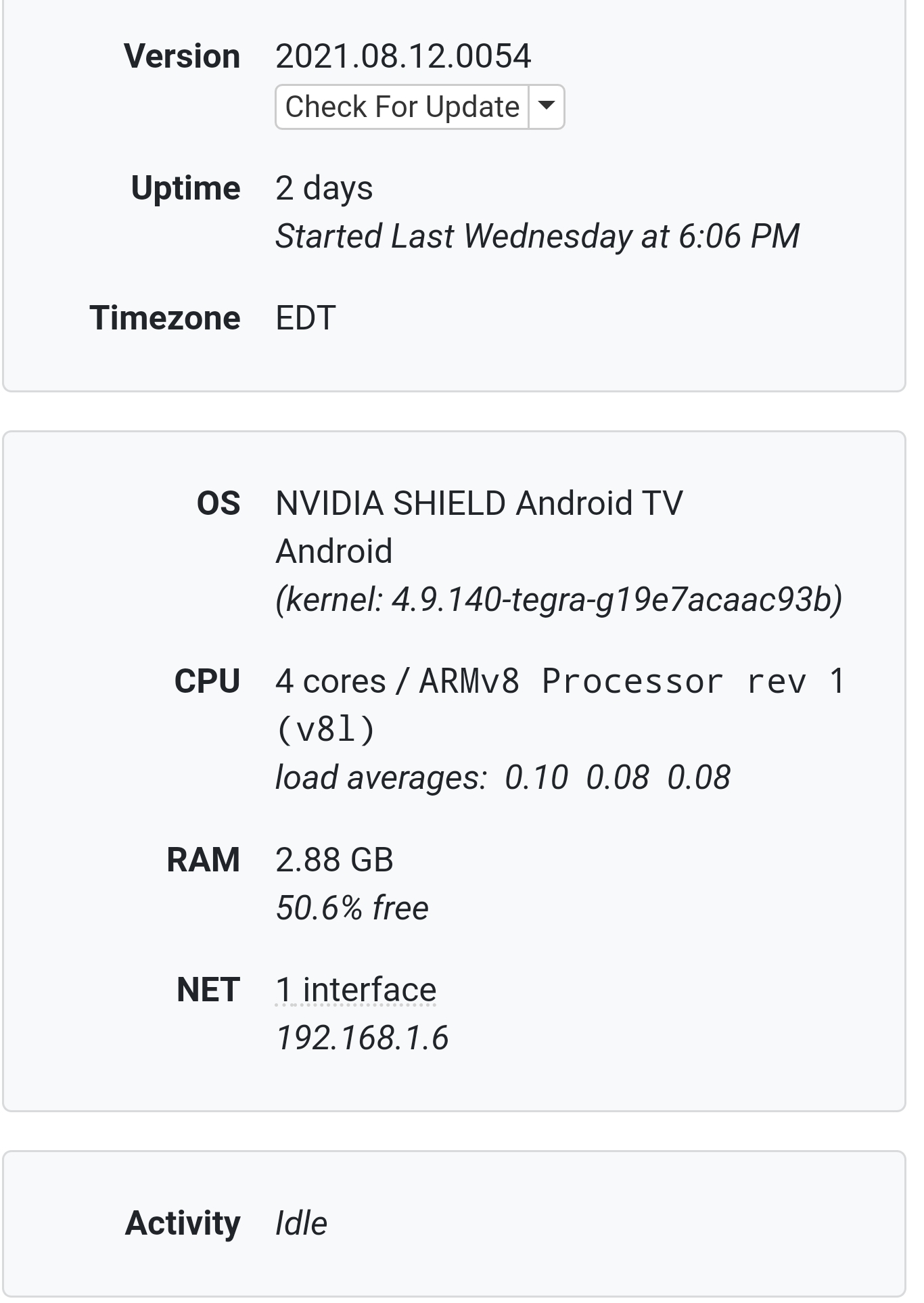

On the DVR Server web UI (accessed from a web browser), Submit Diagnostics is under Support > Troubleshooting
In your case, that should be here:
http://192.168.1.6:8089/admin/troubleshooting
Thanks so much. This is the first time I've had real problems.

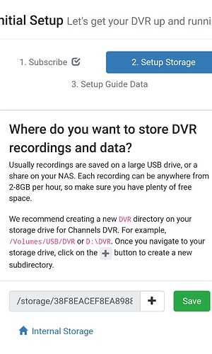

The path to your dvr is incorrect it seems? Uncheck the dvr checkbox on web UI, then click the ... and make sure the path is set to where your recordings are stored.
Ok. I'm lost again. There is no check box for DVR or anything else except for storage.
Is it on step 2 storage? You need to pick the correct storage location and hit save.
All I can see is internal storage. How do I switch to my external drive? What is so weir is that it say its been up for two days and I can see all the movies I recorded in the past.

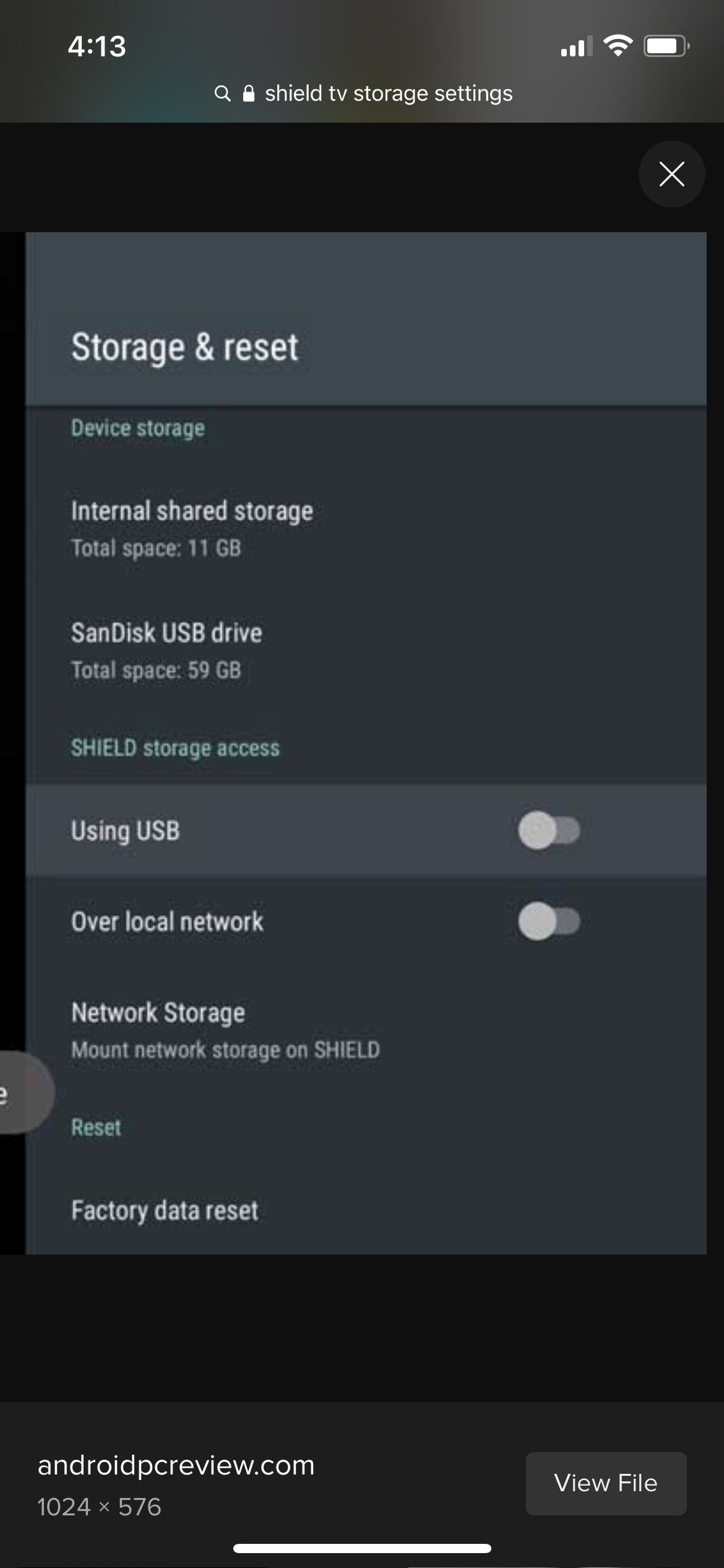

Can you plug in your external storage to the shield and post a picture of storage and reset under shield settings. Like this
