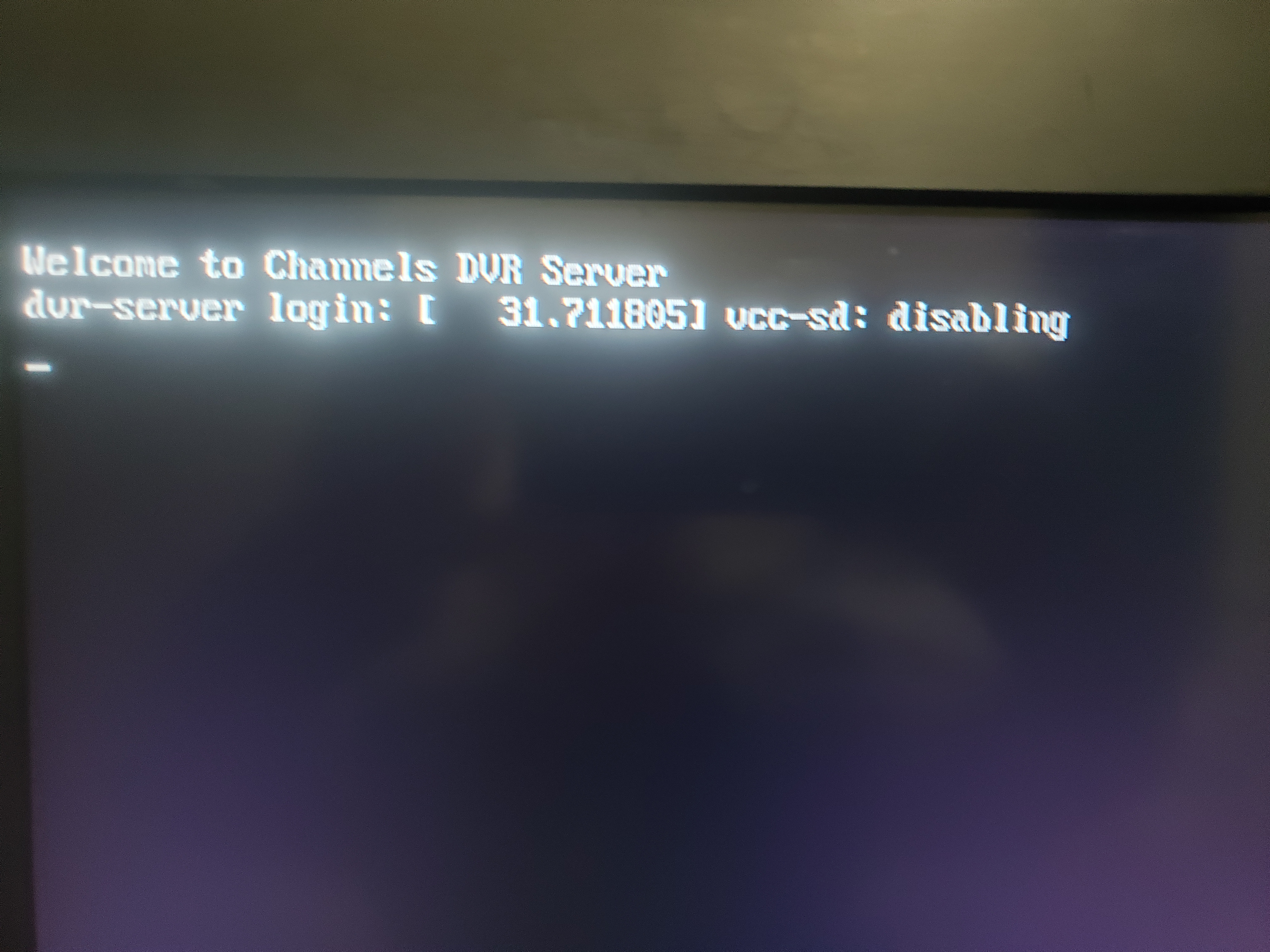

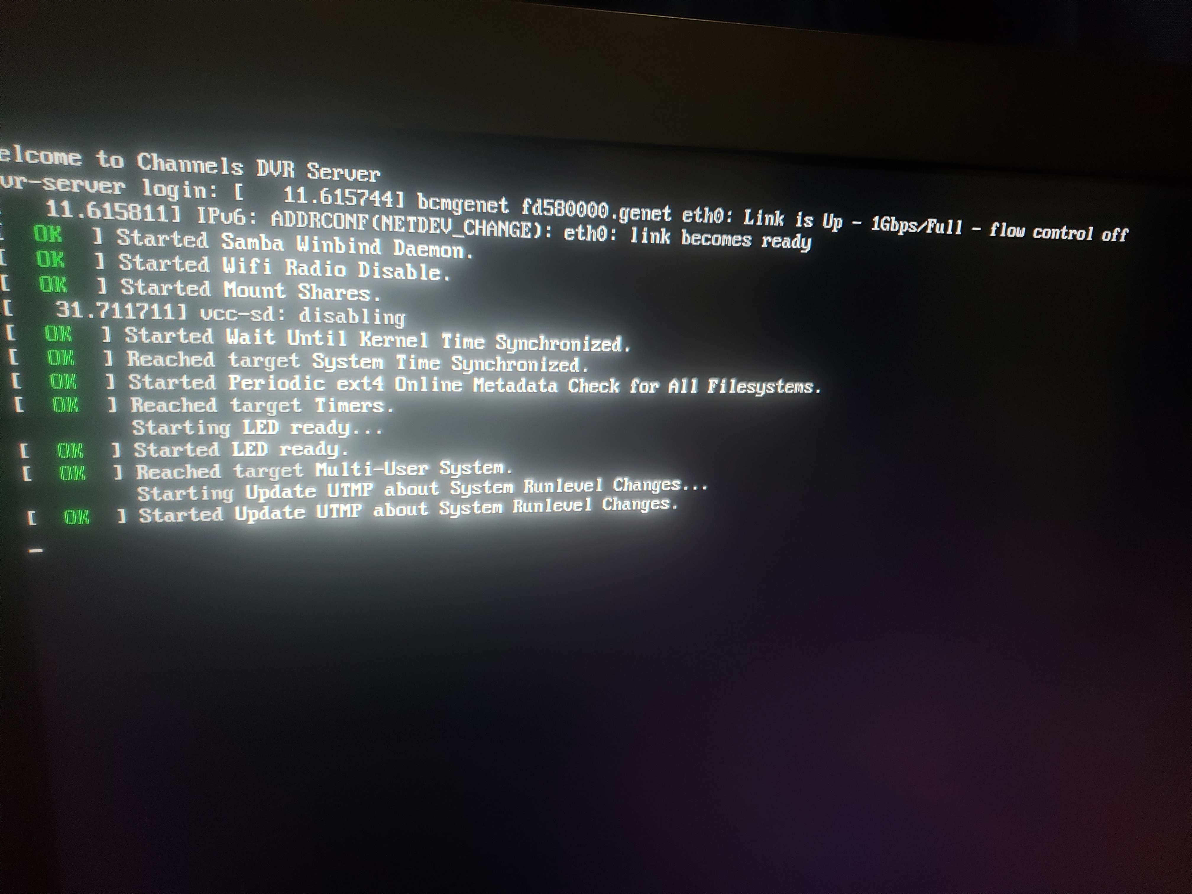

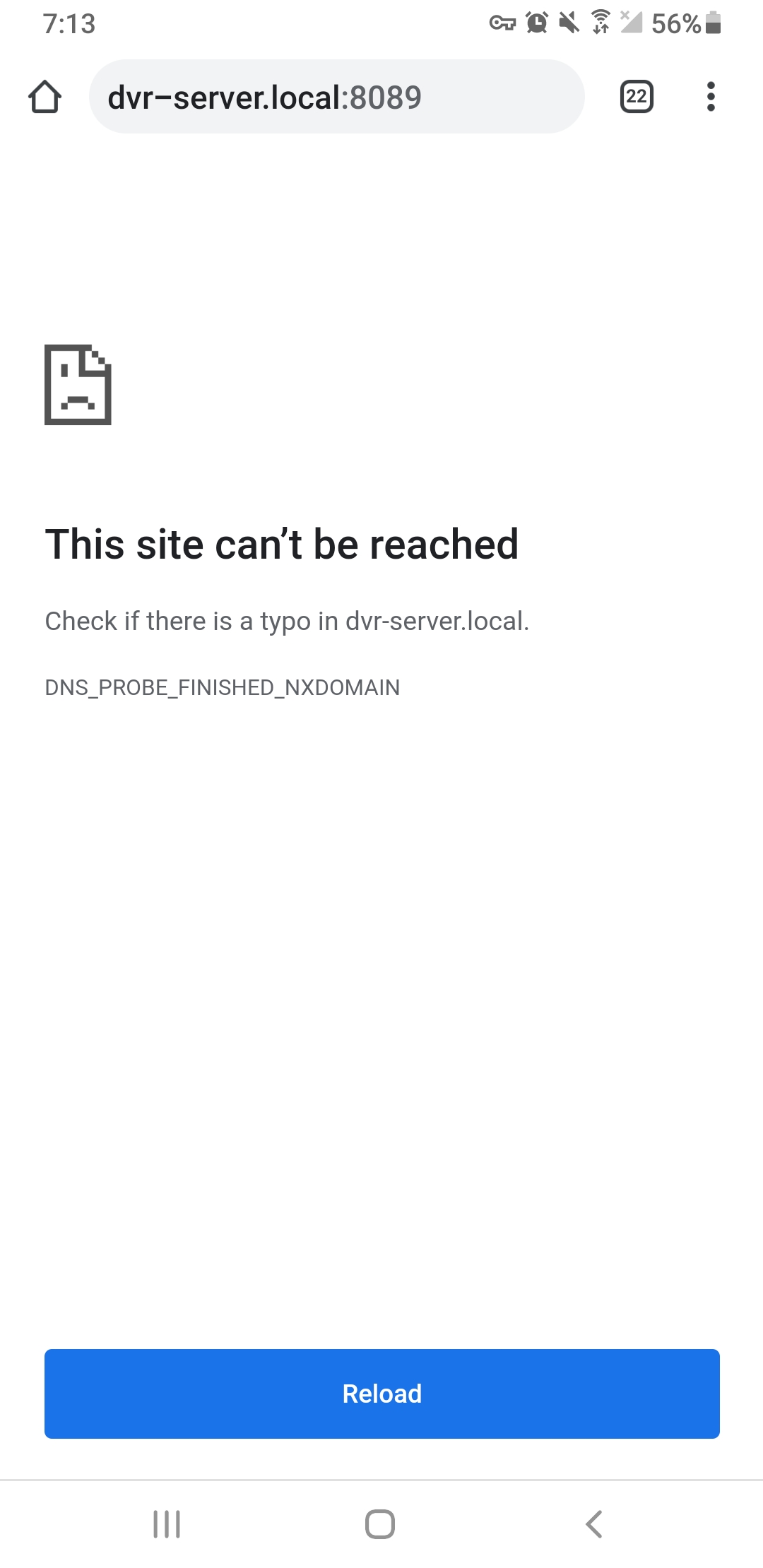

This is becoming a pattern the 3rd time it hasn't worked when ingo check it. I run it headless on my raspi but I go to check it and this is all I get. Why am I paying $8/mo when it fails 66% of the time? Connected Ethernet too. I don't want to have to reinstall AGAIN
I’ve been running channels dvr under Ubuntu for a couple years.
It’s stable.
Perhaps it’s your Pi?
My pi turns on just fine and I swapped out my USB drive to a SD card and the other card works just fine too?
Can you login to your router and find the IP assigned to your Pi?
Yes
Found it
192
It goes to admin page but the dvr-server.local:8089 still doesn't work
Just use the IP then. The other url doesn't matter.
You can click Connect > At Home in the Channels app also and enter 192.168.50.129 after you finish setup on the admin page.
how do I watch on app on firestick then or on my phone?
Click Connect, select At Home, enter the IP
great thanks
