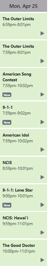

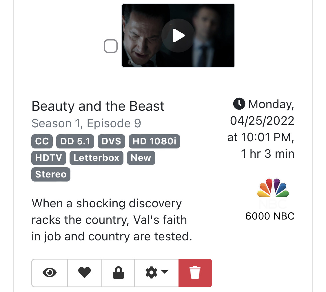

Endgame Episode 9 did not record
For some reason Endgame episode 9 did not record ... I wonder if it did not have Original airdate ... Can someone post a screenshot of the recording details if they have it. Good thing I also record it using XFINITY Stream on my firestick.
This is my pass below ...

Recorded here:
Looks good guess I will never know why it did not record the show before it recorded .... thanks for the details. I have plenty of tuners .. normally I never check because I watch on my alone time.
You could check the Log
Too late it aired 04/25

You see what happened, right?
The scheduler scheduled the recording job for The Endgame (EP041338490009) as job id 1650949230-1
Then a few seconds later, overwrote that scheduled job with the one for Good Doctor (EP026966280090).
Assume it's because of your creative use of the powerful advanced pass and it was never forseen that could happen.
Thanks someone is going to have to explain why it did that ? as I have no clue and makes me wonder what others episodes I might be missing since I do not watch right away.

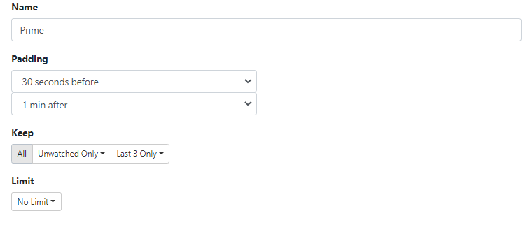

Do you have a negative pre-padding of 30 seconds on that pass?
Wondering why the record start time is 10:00:30PM instead of 10:00:00PM.

Ah, so the guide must have it starting at 10:01:00PM.
It wasn't technically a missed recording. It appears to be a problem with how the scheduler creates scheduled recording jobs. I don't think anyone ever thought a pass would schedule two different recordings at the same time.

To ensure this doesn't happen again, break it out into separate rules. Only put a single channel/time combination in a rule. Otherwise, you end up with weird things like the job being overwritten when guide updates happen.
