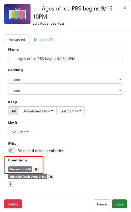

This is how it chooses channels to record from a pass
You can also modify your pass to record from a specific channel.
Then verify by looking at the Schedule

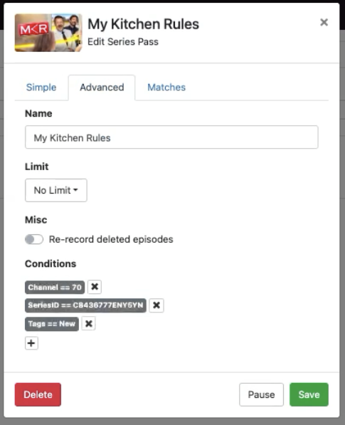

hmmm ok odd, I have it set to record with channel 70, yet it shows me the details of 72/74 etc,

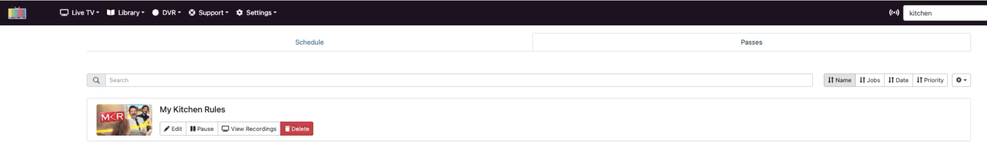

please excuse my noob-ness, but what do you mean by "check the schedule"

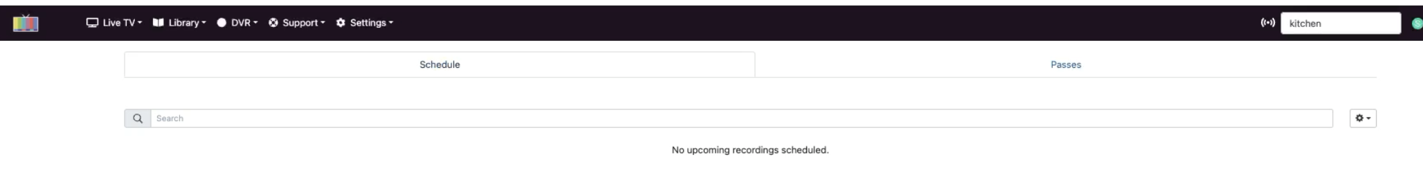

If you mean under the DVR menu, it shows nothing under schedule, but does under passes
Yes, that's the Schedule.

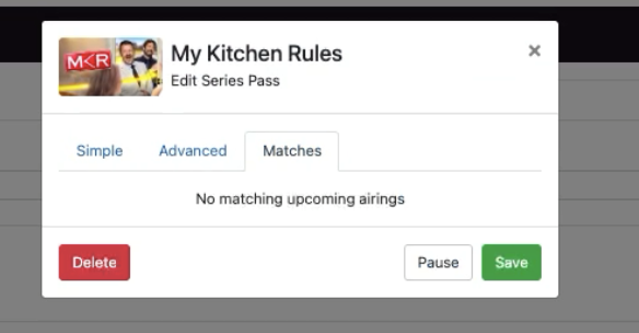

What does it show in the Matches tab on your pass?
If it's blank, you need to correct your pass.
Im guessing it should show something here....

That SeriesID doesn't look right.
just tried again, still no matches.. It's weird, like there are matches - it shows in the guide when I search!
Try changing the pass to use
SeriesID == 8436777

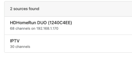

Did you select a guide provider for your HDHR tuner in Channels DVR?
What does it look like in the DVR web UI under Settings > Sources
setting Series ID didn't change things.
as I have the DVR service from HDHomerun, it auto detected the EPG data when I set channels up
Screenshot 2026-09-24 at 12.43.33 pm
Hmm, that must be something new.
I have to pick my guide provider.
