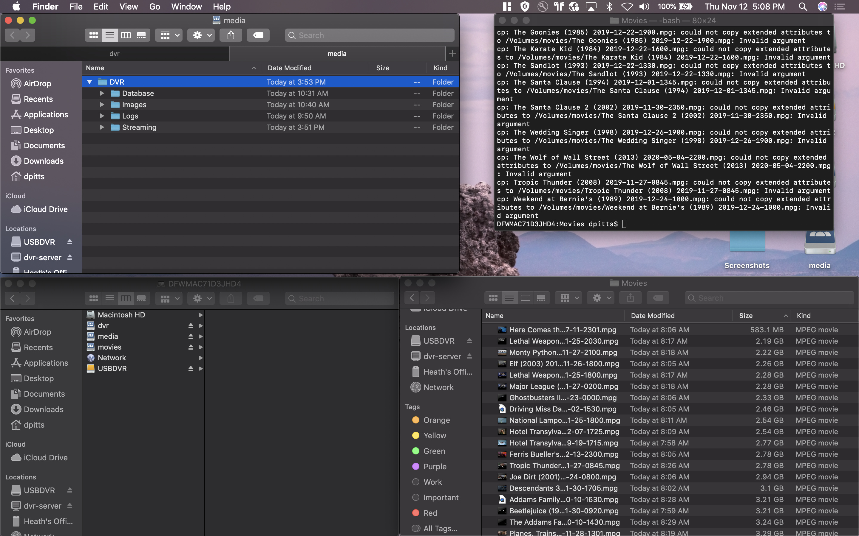

Installed the Pi 4 image and restored my database. Now I’m needing to copy the files back over. Enabled SMB and connected via a Mac to the DVR share. TV and Movies don’t show in there so I mounted them manually. Currently copying items to TV but I cannot copy items to movies. I receive “The operation can’t be completed because an unexpected error occurred (error code -50). I am connected as a guest when asked for credentials. I have verified I can create folders in the SMB share but cannot copy a single movie. Anything I’m missing?

Can you screenshot what you're seeing?
There is one SMB share called MEDIA. Under it is the DVR directory and under that should be everything including TV and Movies.
Doesn't show up under terminal either
Also just verified that the movies and tv shows I copied back to the Pi play perfectly. Manually mapped a share to tv and also to movies to copy them. Even after watching one it doesn't show up. Seems to work though

Had a show that recorded this morning. Worked without issue and detected commercials. Those directories still won’t show over SMB though. Doesn’t seem to be causing any issues and I was able to fix the Imports issue from my log file
