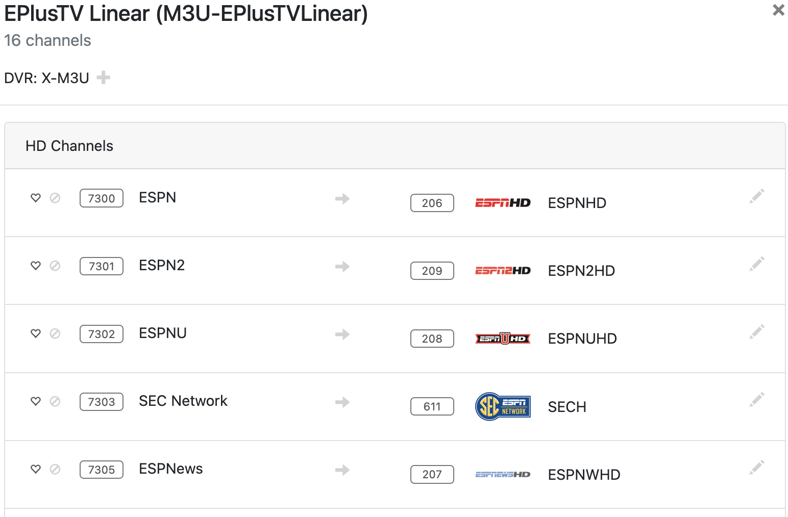

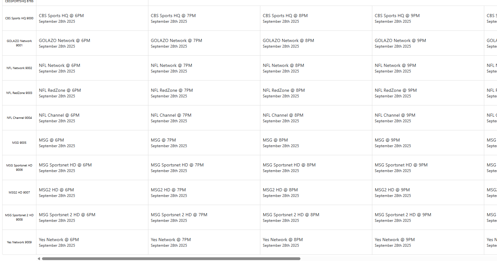

My E+ channels are working, however the guide only shows the network name, and no info about hte games/shows. I've rebuilt the EPG in E+TV and in CDVR I've reloaded the M3U and refreshed the XMLTV but same issue.
Any idea?
thanks!
Make sure the linear channels are mapped in Sources-Manage Lineup
yep, that was it, thanks!
