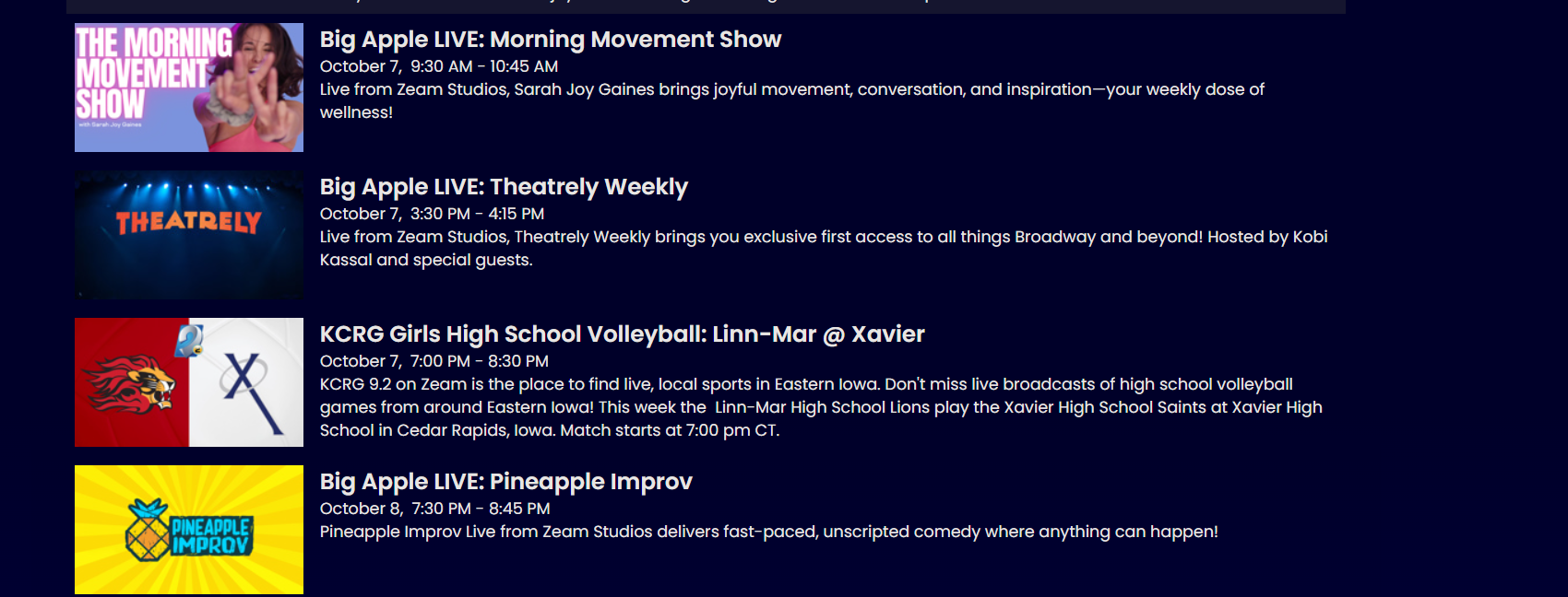

Thanks so much! I haven't checked zeam live event yet but looks like its loaded up for tonight. I noticed there were some non sports events, I havent seen if they scrape yet, maybe you could add trigger word ban to not scrape?
Improv, Theatre, Show

This is already possible in E+TV. Using the title and category filter boxes in the web interface, you can filter out any events you don't want in your guide.
