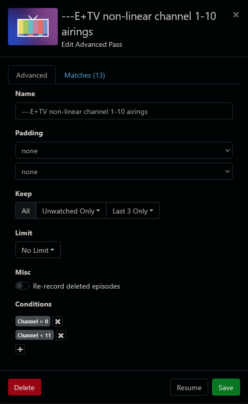

Causes issues in Channels DVR, like where it thinks GAME 1 is the same as GAME 2, or generic guide data for a show makes it think every airing is the same one and so won't record it again.
I don't have that issue with other sources for the channel that use Gracenote guide data.

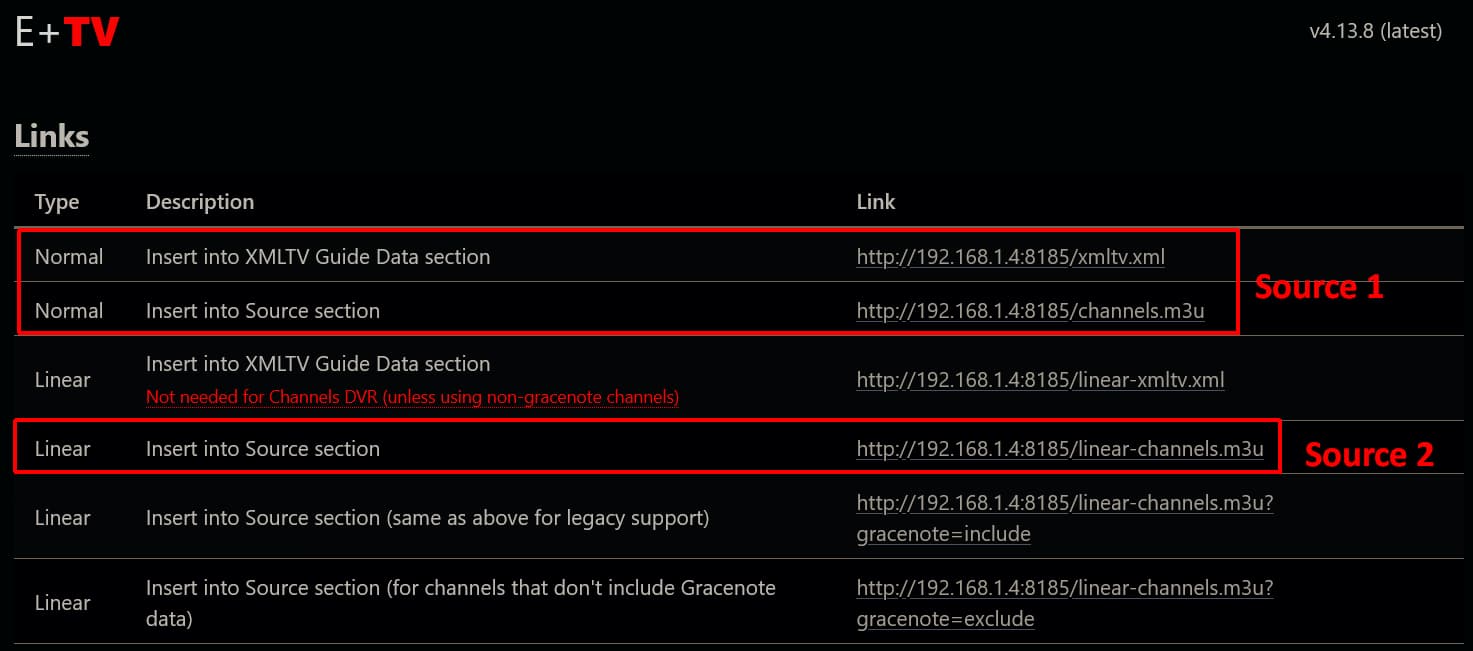

EPlusTV doesn't get Gracenote guide data, it just gets whatever the provider provides (in this case, the Fox Sports web site). But like other linear channels, I suspect you could manually remap it in Channels DVR to use your local station guide data instead of using the EPlusTV provided guide data. Only the sporting events would work but it might improve your recording experience for them.
Problem is we cannot get our Local Fox channel with Channels DVR TVE, since it doesn't work.
And we cannot get it as a linear channel in E+TV.
I can get it with Gracenote guide data using a HDHR tuner in Channels DVR.
Don't know how I could map the Gracenote guide data to an E+TV Normal channel?

That's for linear channels, not normal channels.
I don't get my (so called Local Fox) channel via E+TV Fox Linear channels, only the Normal channels.

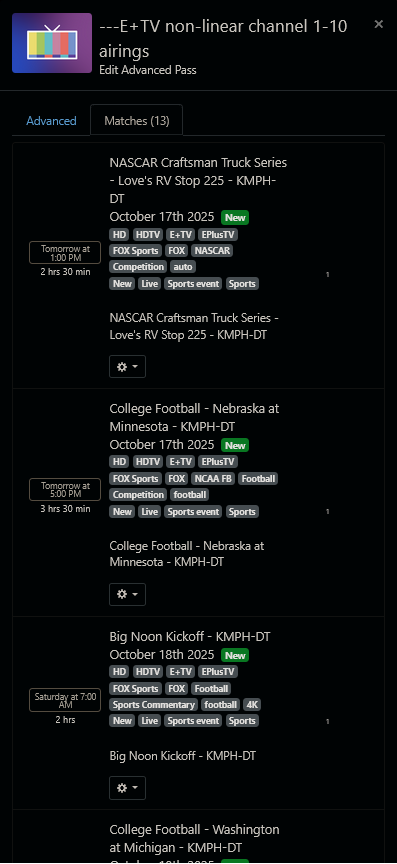

Here's what the airings look like in Channels DVR
