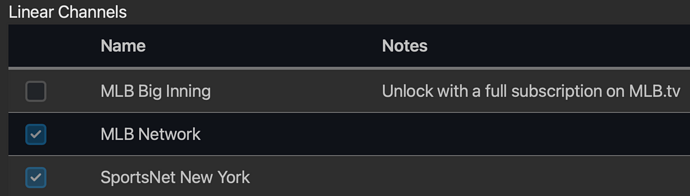

@m0ngr31 all of the sudden the container is telling me that I am not subscribed to Big Inning. I've tried to reauthenticate a few times and it still won't work. it works on mlbserver and everywhere else. thanks.
Do you have only free games enabled?
yes. interesting. only works with that disabled?
Yes, but I need to update it so it actually checks
