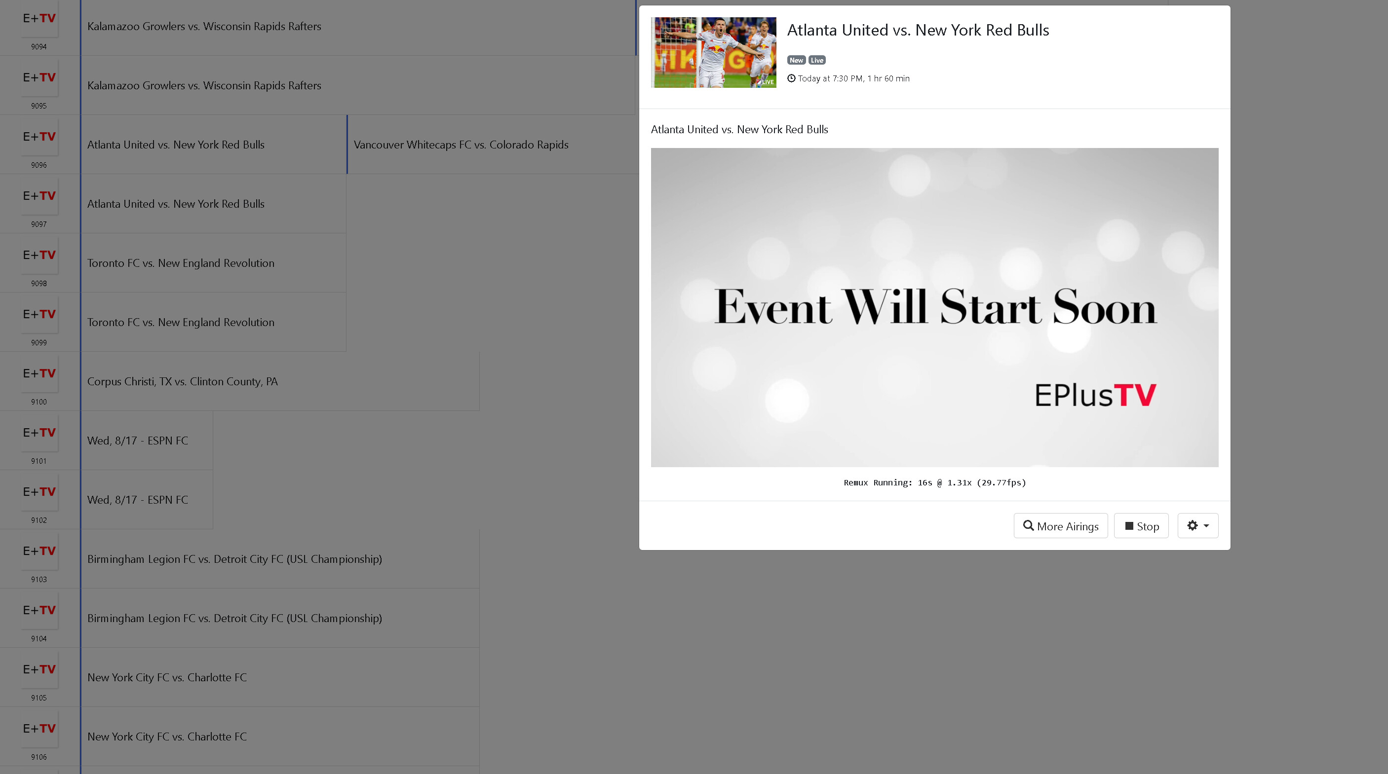

I just installed a new VM with Lubuntu so I would have firefox on the docker host to first login into ESPN with. I was able to log into ESPN via firefox but with the docker image I was not. I received the one-time ESPN passcode to my email again.
The docker image was able to get all the guide information but when I click on an active event in Channels -- I get The "Event Will Start soon" with then receiving an email from ESPN.
Is anyone receiving this also? I do not get prompted with an email when I use a browser to log into ESPN and watch a ESPN Plus stream. I thought by installing on a fresh docker host and also have a browser available on the docker host I could authenticate properly.

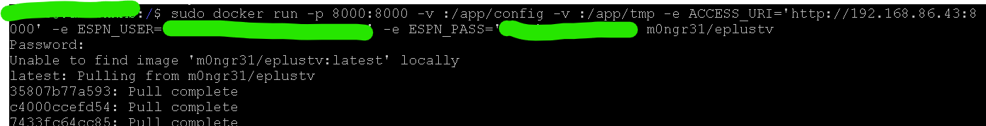

sudo docker run -p 8000:8000 -e ESPN_USER='YourUsername' -e ESPN_PASS='Password' -e START_CHANNEL=700 --name ESPN_Plus m0ngr31/eplustv

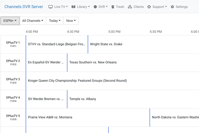

I just got mine up and running today on an intel mac. I was not sure it was working on the docker side, but once I put in the m3u and XML everything worked. I also set up the "channel collection," as recommended by Maddox at the top of the thread, so only the active live streams populate the collection. Happy to have this in time for football to start back up!

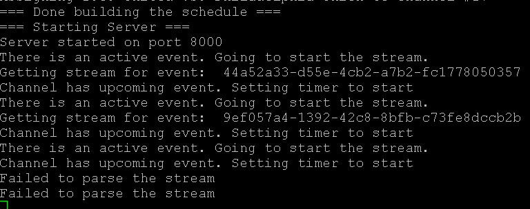

I've just tried to install this a few times but no matter what I do it doesn't seem to work.
Everything shows up in the guide but when I try to watch something it gets hung up on this screen:
This is what is showing in the SSH window.
Yeah that started the other day. I couldn't get a stream to start at all. So it seems something has changed to make it worse than what it was. Prior to I could at least watch maybe 10 minutes before it would drop. Now it will not even start. I ended up removing it as a source. It needs work.

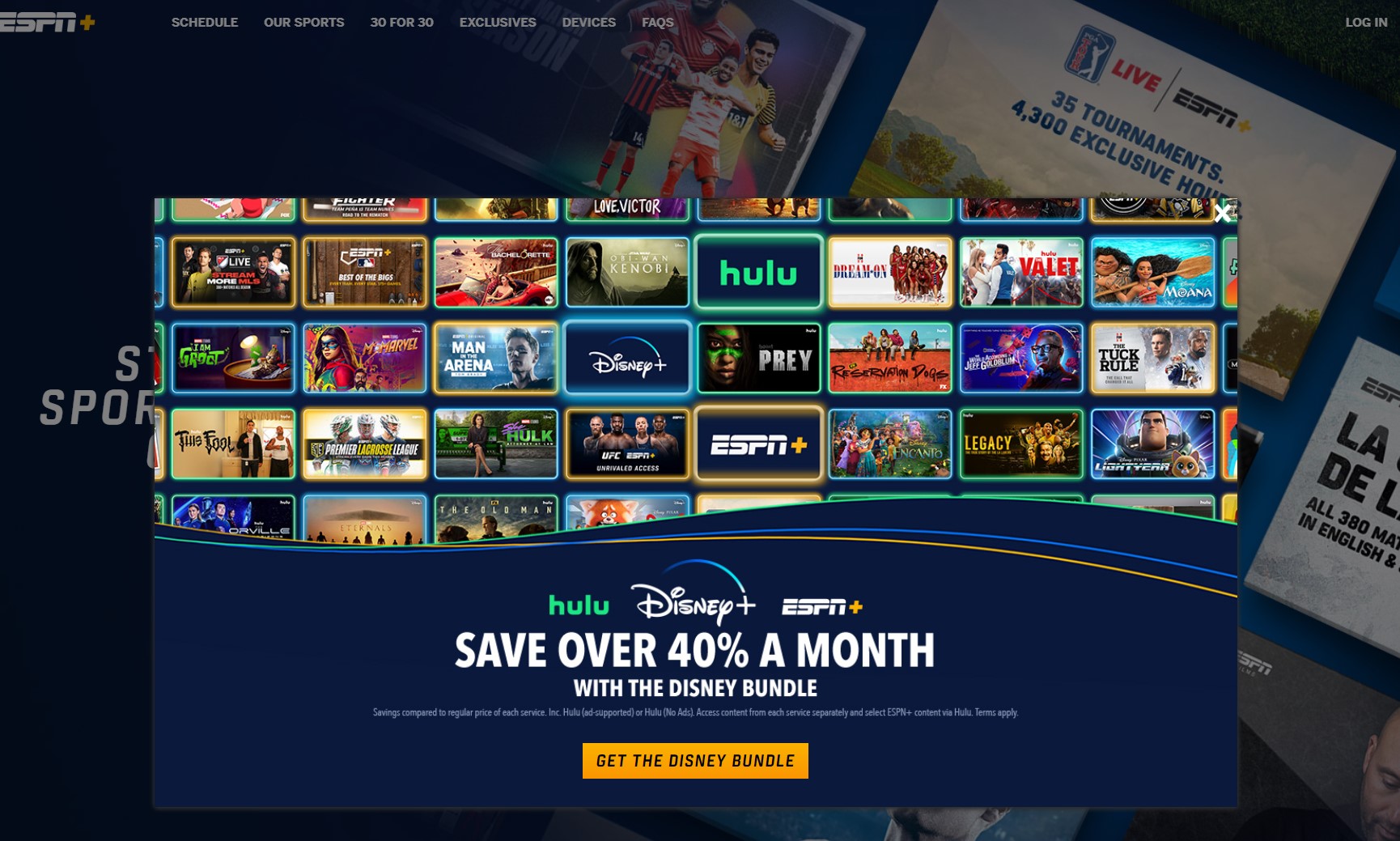

I was playing around with a new docker image this last weekend and I also see the "Event Will Start Soon" message. My docker image which I created a few weeks back still is working fine. I don't remember a few weeks back receiving the message from ESPN "Save over 40% a month" as a splash screen. Could this screen be blocking getting the stream to work?
I am not sure how to troubleshoot this from within the docker container. I am also using VLC to test and when pointed to my original container the stream works but not with the corresponding "channel" with one of the new containers.
Any ideas if this could be causing it the stream not to start?

  • using espn+ you can create custom channel in channels dvr that will populate and update the schedule guide with sports that are live?
