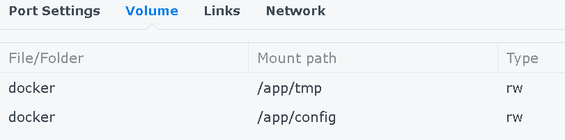

I can get the streams to work installing with the synology docker application but I can't get it to show the guide data in channels. When I try to add the volumes the thing crashes. I know how to do it through SSH but I'm not home and won't be any time soon so I have to go through quickconnect.
Could someone who has it working with guide data saved on their system please take a screenshot of their volume tab so I can copy it?

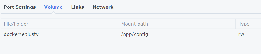

I did have this working a while ago. But I can't seem to get it to work. I believe it has to do with the recent changes in synology 7.1 and the /tmp folder access. Trying to figure out how to get around it. Or I am really missing something obvious. It can't create the folders in it. It tells me that it is a permissions issue.
I ran into permission problems on Synology when I was first learning about docker.
On your Synology, use the /volume1/docker directory instead of /tmp
Like /volume1/docker/eplustv
-v /volume1/docker/eplustv:/app/config
Make sure to first create the directory eplustv in /volume1/docker
I missed that. Duh. You are correct.
I know I created a folder in the docker folder for it. I will try to give it a whirl again tonight. Then I will post the error I get.
Getting an Error: EACCES: permission denied, open '/app/config/state.json'
Its like it isn't allowing it to write files to that folder.
