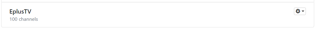

Trying without volume this time. Seeing a bunch of channel stuff this time.

Is it possible to create/ use your espn+ subscription as a source ? Or must one just docker set up?
I’m only using a mini pc running channels as it’s only function…
Im homecoming to create a source, then use the strode to create the custom,channels… or have I got it backwards?
Thanks all
You have to use the docker container. The EplusTV uses your ESPN+ login to scrape the guide and links from the ESPN+ website and build custom M3u and XML files which is serves using http to your Channels DVR. If you have sufficient disk space and memory, you can install docker desktop on your mini pc and run EplusTV on the same machine. It'll likely be slowed down a good bit by the overhead of docker, but it may work well enough to run just that docker and Channels.
