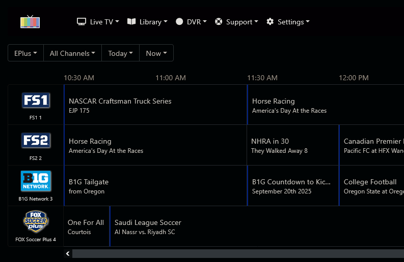

Using YTTV credentials, I see the FS-Soccer Plus linear channel programming, but it doesn't play.
FOX Soccer Plus is in the m3u

Trying to play it in Channels DVR errors out
Channels DVR log
2025/09/20 10:42:08.352690 [ERR] Failed to start stream for ch4: M3U: Could not fetch playlist from 192.168.1.4:8185: GET: http://192.168.1.4:8185/channels/213.m3u8: 404 Not Found
2025/09/20 10:42:08.359762 [HLS] Couldn't generate stream playlist for ch4-dANY-ip192.168.1.8: M3U: Could not fetch playlist from 192.168.1.4:8185: GET: http://192.168.1.4:8185/channels/213.m3u8: 404 Not Found
Eplus container log
2025-09-20T17:42:08.350790269Z Could not get a playlist for channel #213. Please make sure there is an event scheduled and you have access to it.

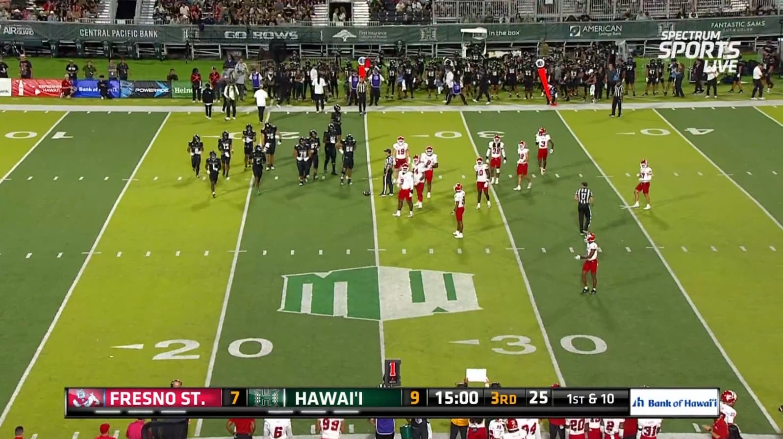

Tony, can confirm spectrum sports/hawaii/mountainwest have their own m3u8 that should be able to be added to he eplus tv, it doesnt have unique token, they always broadcast for it. Tested 2 weeks
