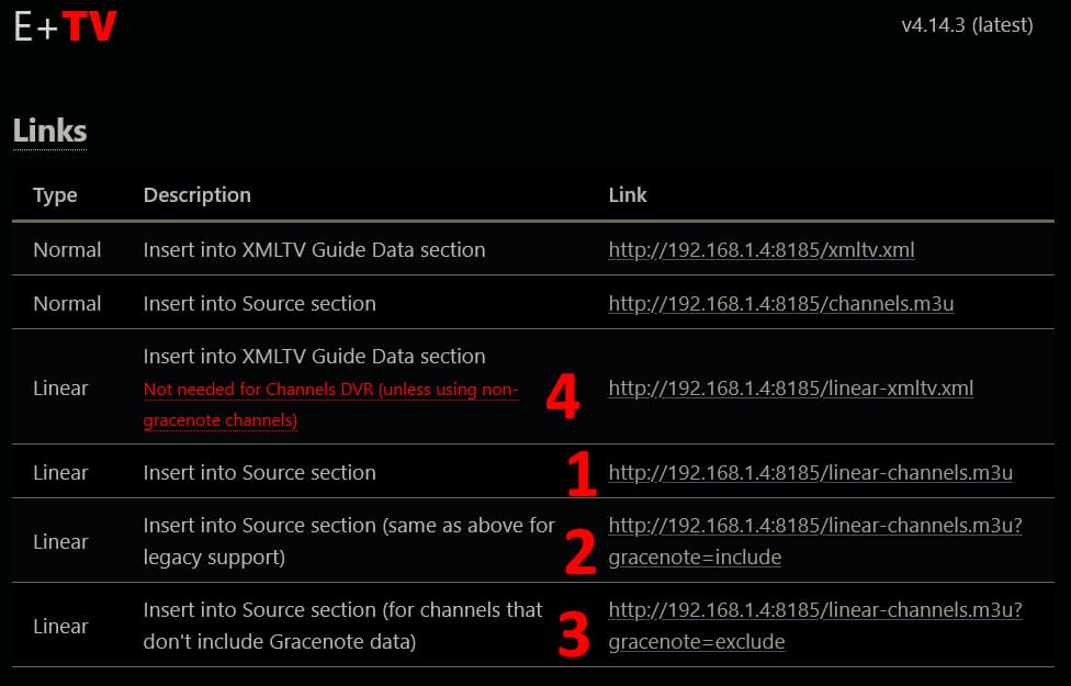

Problem with Fox One Linear channels and XMLTV guide data.
Since the Gracenote guide data is wrong for some channels, I wanted to use a 2 source method.
One source for channels with Gracenote guide data
A second source for channels using Fox One guide data (linear-xmltv.xml)
It's not working.
1 and 2 contain the same information, including the gracenote/tms station id tvc-guide-stationid=
3 is empty (just contains the line #EXTM3U)

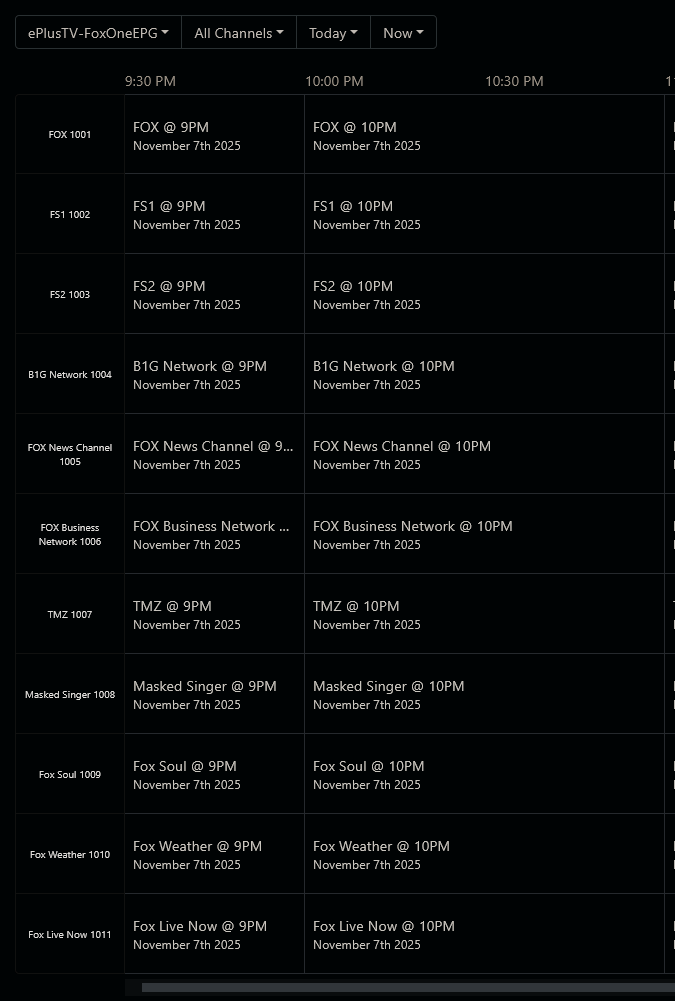

4 is the Fox One guide data that I'm trying to use

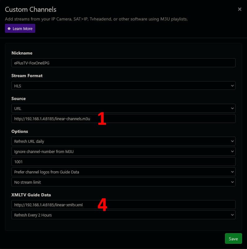

So as an example, I want the Fox One (not Gracenote) epg for The Masked Singer channel
I add a custom m3u source to Channels DVR with the following settings
Since the linear-channels.m3u contain the gracenote/tms station id tvc-guide-stationid=, Channels DVR ignores the linear-xmltv.xml epg.
Can we also get a linear-channels.m3u that doesn't contain the gracenote/tms station id tvc-guide-stationid= that could be used with Fox One linear-xmltv.xml epg.
Right now to work around it, I download the linear-channel.m3u to a file, edit the file to remove the gracenote/tms station id tvc-guide-stationid, then copy and paste it into the Channels DVR custom m3u source settings as a Text Source.
Since masked singer channel is not working correctly, it should be able to have the gracenote id taken out of the code. It just has to be stripped for the channel in two places and then the gracenote=exclude should work. I will test it out.

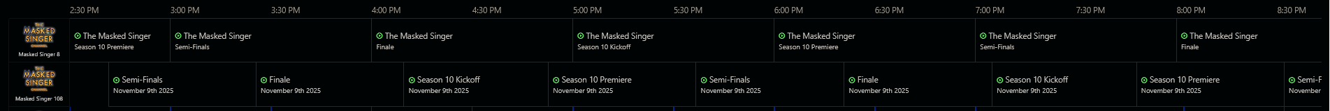

It's an unusual channel as it plays ad-less episodes (average 44 minutes each).
Gracenote epg lists each episode as 60 minutes, so recording with gracenote epg gets you parts of two or three episodes in the 60 minute time slot.
I tested it out and it it worked, adding it to the non-gracenote m3u. It will then pull the guide data from the xml. I made a PR for it so once Tony approves it can be safely added.
This has been merged in v4.14.4
Thanks @GenericChannelsUser and @tonywagner
It's working.
