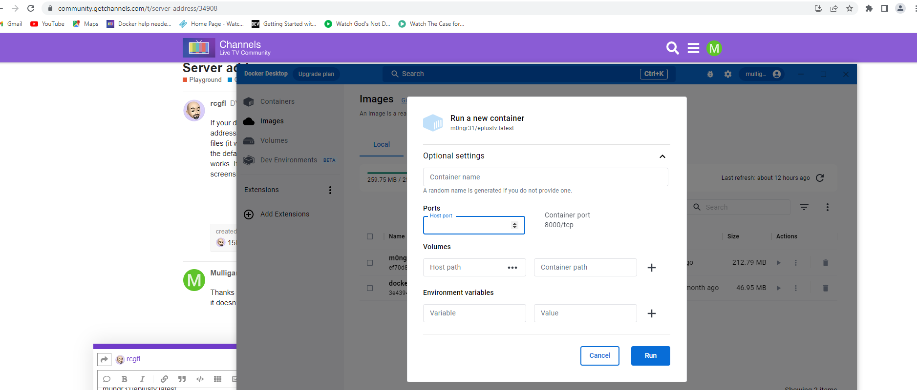

The next screenshot shows the container port is 8000

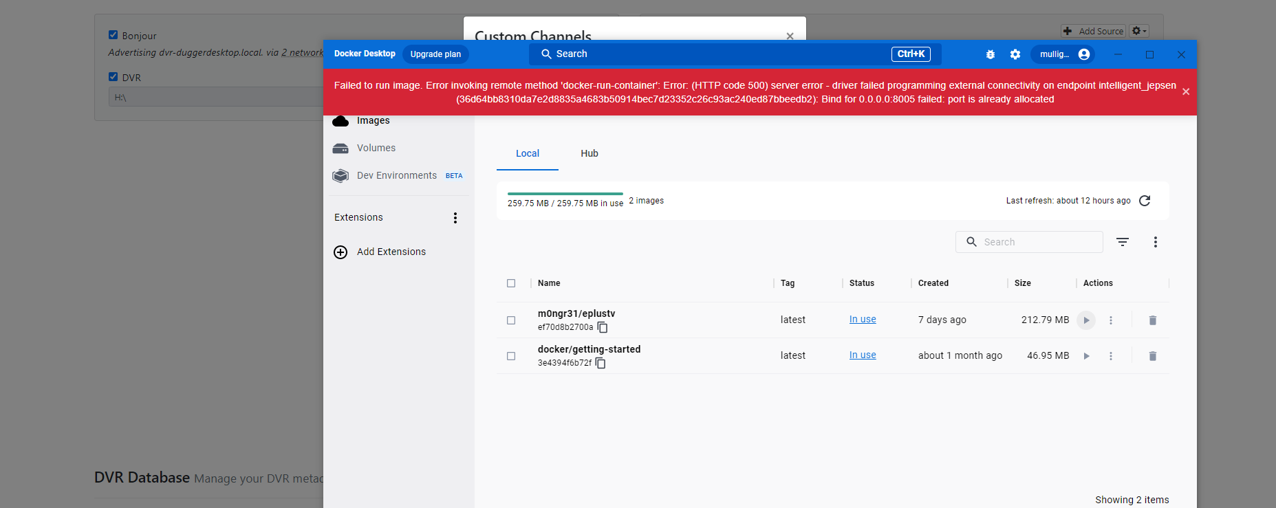

If I try to change the docker port path to 8005 to match the m3u and xml info like shown here:
I get this message shown here:
It looks like you have something else running on port 8005.

If the docker is running on the same machine as the channels server then your ip is correct. As you know the port for the docker defaults to 8000. You really only need to change this if you have something else using port 8000. The error message is telling you you can’t set up the docker to use port 8005 because you already have another program using that port. If I were you I’d leave it at 8000.
on a side note when I used docker on windows I had to use the windows machines IP not the docker provided IP to get it to pass through.
