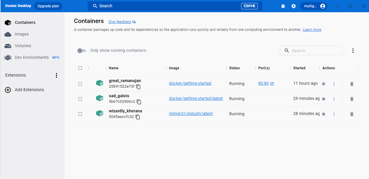

Is there a simple to use guide for getting both to work for somebody using Docker on a Windows machine who isn't a coder? I ran this command: docker run -p 8000:8000 -v config_dir:/app/config m0ngr31/eplustv
I and others have made several posts above about how to do this in Windows. Just search for "Windows" in the thread. I can see right away that you are not following the directions for the config directory.
Please ignore the previous screenshot. I appear to have something working but not sure if everything is right or not. I'm going to try to wade through that list. How can I post the log? I appear to have something working for ESPN+ looking at the logs, but doesn't appear that Fox Sports is there. Not sure what's next or incorrect.
The default is to not include Fox Sports. You have to tell it to include Fox Sports programming.
-e FOXSPORTS=true
You should read the documentation for EPlusTV... EplusTV
I have been there but I don't see any mention of that or the full command line to run in with Fox Sports
Under the docker setup -> environmental variables, you have options of adding to your command line to include additional options such as Fox Sports. If you wanted fox sports (which by default is set to false, meaning if you don’t explicitly call out that variable it will default to false) you would add in your command line (w/o quotes) “-e FOXSPORTS=true”… if you look at other commands people have used in this thread, everywhere you see a -e that is an environmental variable they are enabling or disabling that is likely different from the default set up by the author. Hope this helps!
