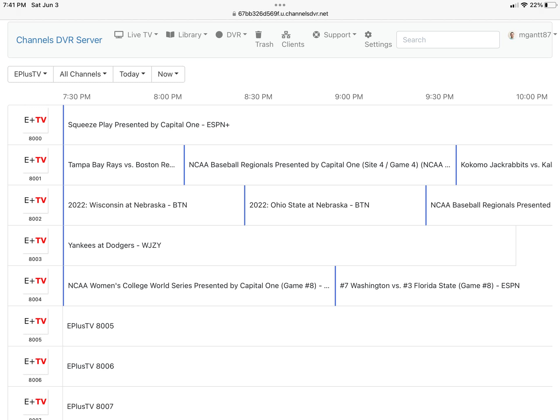

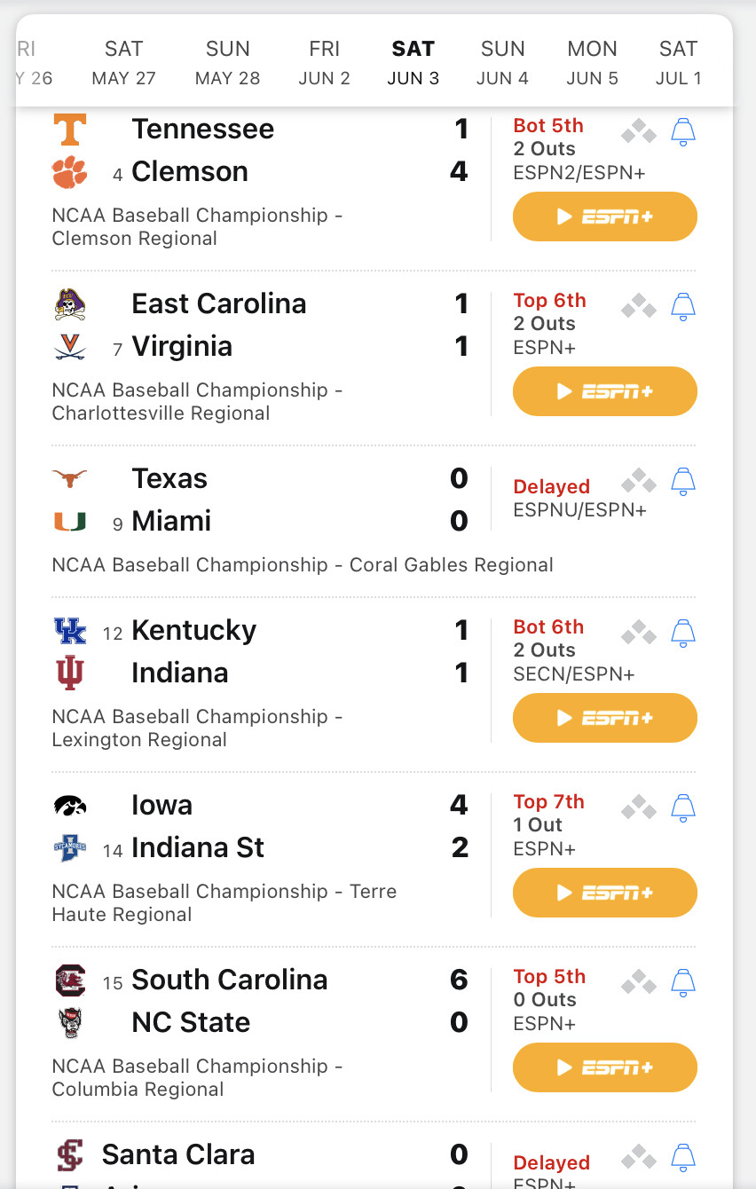

Also, I’ve had hit or miss success with ESPN+ events showing up in the app. For example, right now there are many NCAA baseball games on ESPN+ right now, but the guide in Channels doesn’t show most of them. I just restarted the EPlusTV container and redownloaded the guide data in channels right before these screenshots. Any suggestions on this?
I’ve tuned to all of those games from the “On Now" tab in the last 15 minutes. A lot of very competitive games right now!!!!

Do you have the setting for Linear turned on? (It is set to off by default so if you didn’t set the EV then it is off.) Beyond that it could be an authentication issue. Your screenshot showed Fox sports events were populating correctly so maybe it is an issue with the espn authentication during set-up. The only ESPN+ event I saw was “Squeeze Play” - strange that it came through but others didn’t.
The linear variable is set. I didn’t think that mattered though since ESPN+ isn’t part of the linear networks. Typically I see many more events than the screenshot but every time I have checked, numerous events are missing. I wouldn’t think it is an authentication issue since I’m able to see some events and view them without issue.

Linear shouldn’t matter but when I had it enabled it ended up skipping some events in my case. Once I switched it off I got the full event schedule back.
