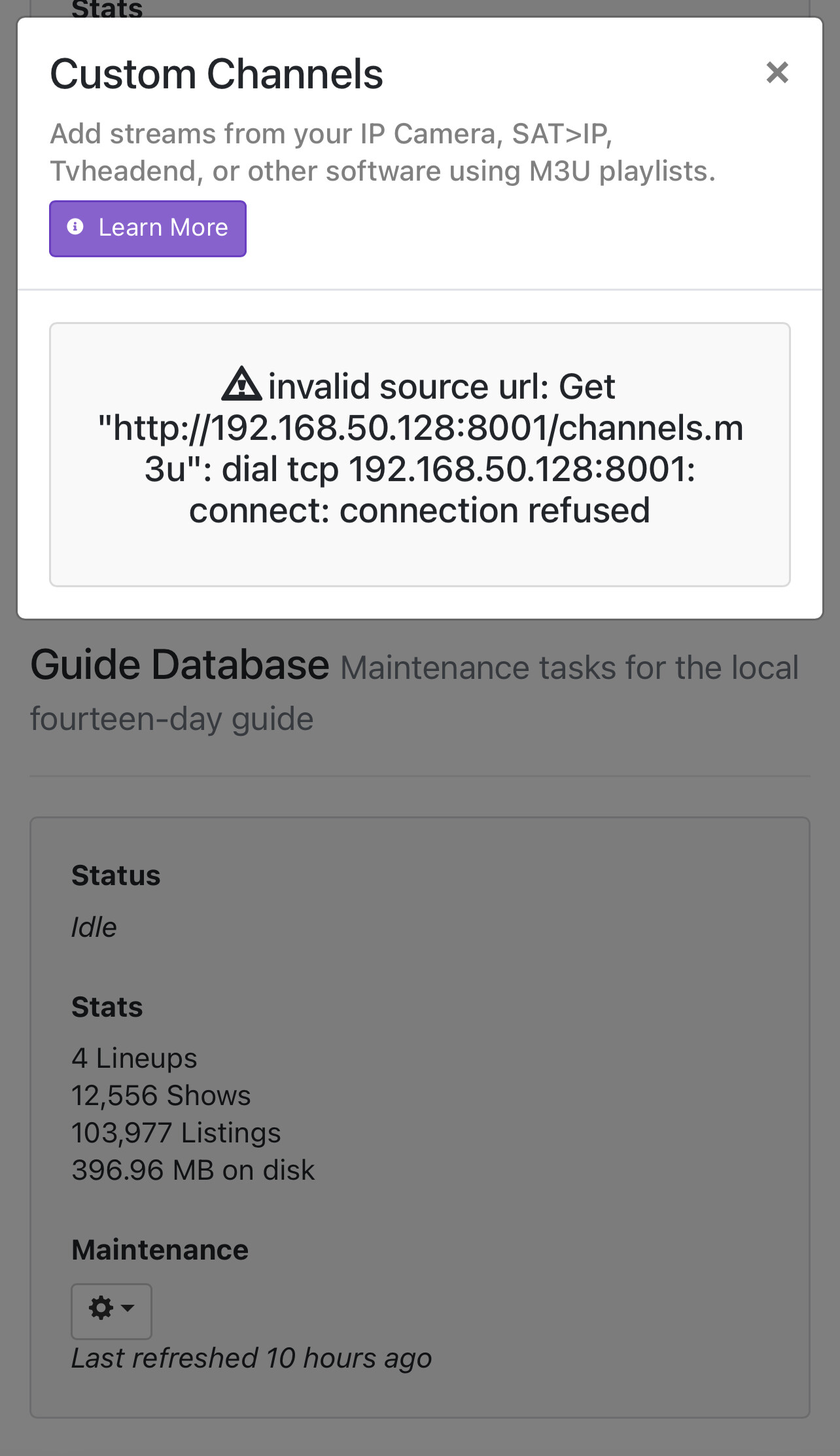

I am doing this but mine says connection rejected.

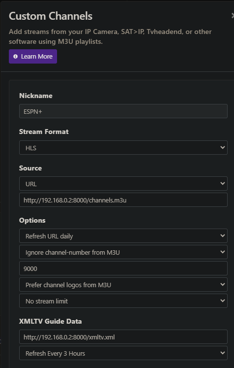

I keep getting this error. Any ideas as to why? The IP is correct for my Synology and I changed the port to 8001 in hopes that would have solved the issue it’s having.
Take a screenshot of the docker setup. What’s the port there?
Ok was able to get it working. Had to use the local port not the container port. Problem I have now is that it shows all the channels just 1-150 and nothing else. Guide dosent show any shows till 10pm.

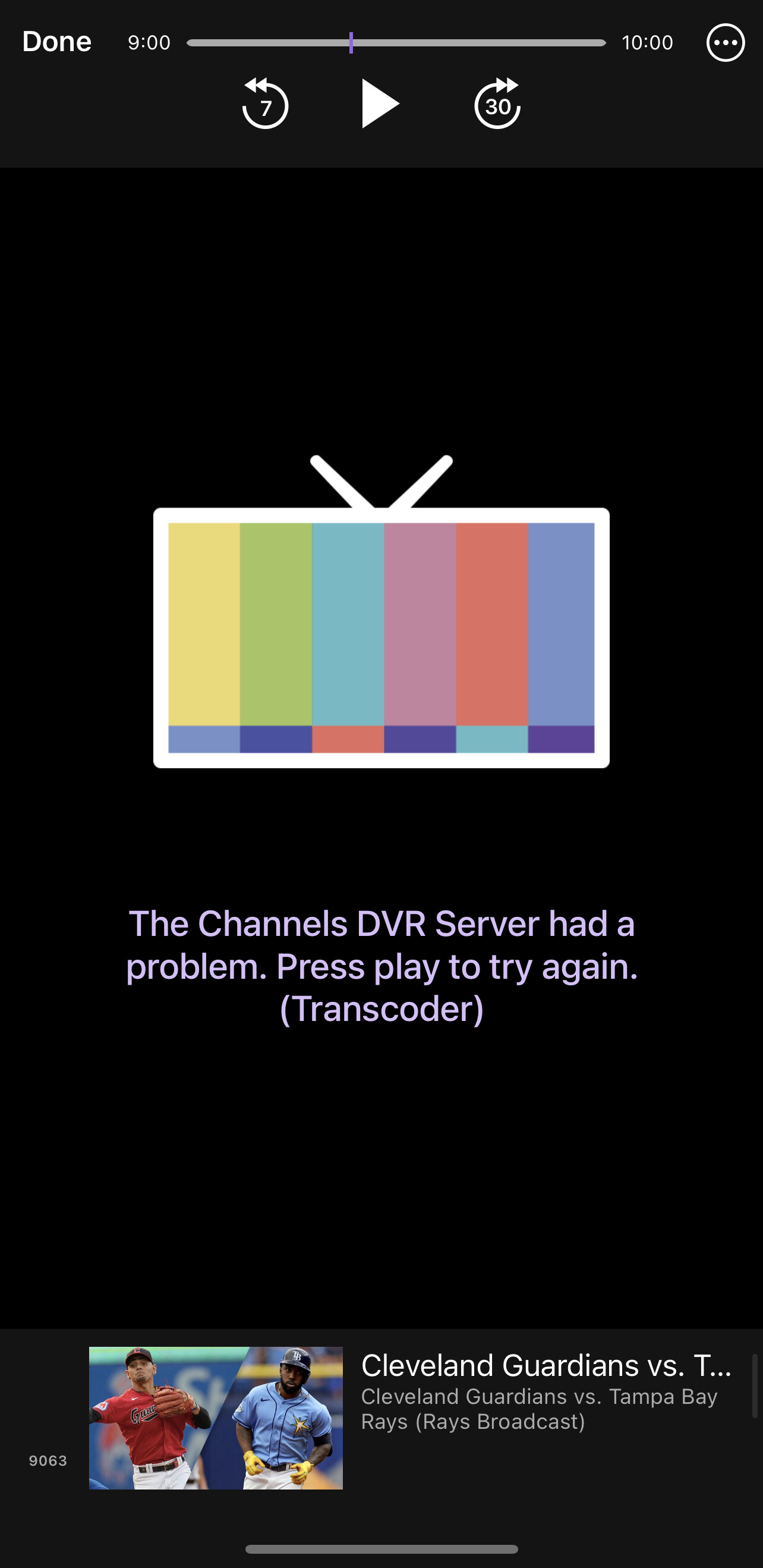

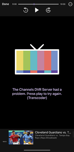

Also when I try to play a show I get this error but only on the streams from this container.

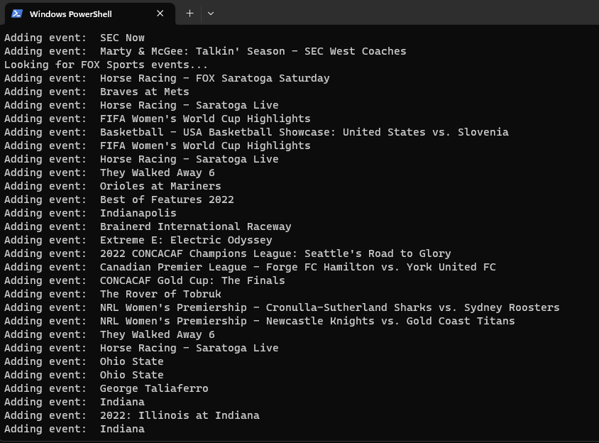

Playing around with this and have had some success.
Installed originally and saw only EPSN+ content (no Fox). So uninstalled and ran the following install script in ssh into my Synology NAS:
docker run --restart unless-stopped --name EPlusTV -p 8000:8000 -v config_dir:/app/config -e START_CHANNEL='7000' -e ESPN=TRUE -e ESPN2=TRUE -e ESPN3=TRUE -e ESPNU=TURE -e SEC=TRUE -e SECPLUS=TRUE -e ESPNPLUS=FALSE -e FOXSPORTS=TRUE -e FOXSPORTS_MAX_RESOLUTION=UHD/HDR m0ngr31/eplustv

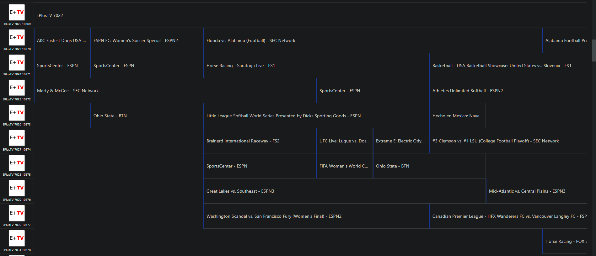

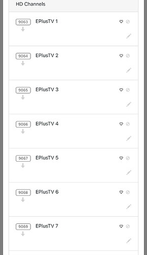

I went through the steps to link both Fox Sports and ESPN (using my Hulu Live TV Credentials). Now I see what appears to be just ESPN, ESPN2, SEC content only, but not seeing the other content I was getting previously. Also, no FOX channels are populating in the custom channels even though I know they were downloaded in the app (see various screen shots):
Edit, after taking the screen shot I do see 1 Fox Sports program listed under ESPN+ Channel 7031 10378 in the above screen shot, so perhaps I am getting Fox Sports content and it's just mapped under an ESPN+ channel logo? Is that intended?
Also, I'm wondering if by linking my HULU TV credentials and not my ESPN+ credentials, am I not getting all the ESPN+ content? I'm not seeing the golf and foreign soccer content I was seeing when I did my initial install before trying to capture Fox and the SEC/ESPN channels in addition to the ESPN+ content.
TIA.
Double check your env vars. You have ESPN+ as false and another one as "ture". All the channel artwork is E+TV, which is the project name, not ESPN+. So FOX or whatever can appear on whatever channel is free at the time an event is scheduled.
