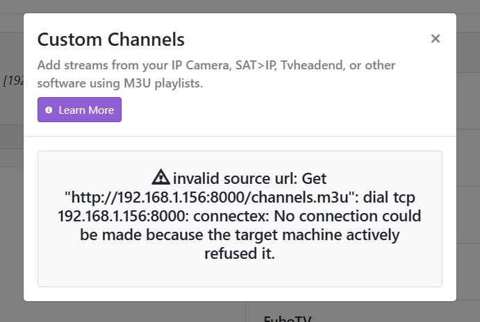

Hello, would someone mind helping me figure out what I am doing wrong. I loaded the Docker on my Windows 10 machine and had no problem running it. I cannot add ESPN+ as a custom channel. I continue to get the following error. Thank you

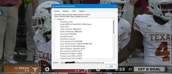

Why is his verizon ESPN 4k 1080p. Also my buddies ESPN 4k was 1080p
I assume that the IP of the machine where the container is running is 192.168.1.156 and that you set the port to 8000.
You may have some firewall setting or antivirus that is actively blocking that port.

As far as I know only 1 ESPN4K, 2 Fox 4K, and 2 Peacock exclusive 4K for college. All are 1080p afaik upscales (but still decent). Also, ESPN isnt upscaled on YoutubeTV for pc or Verizon Fios cable card as seen above as screenshot only 1080p.
It is upscaled for Verizon FiOS. Just because the screenshot wasn't in 4k doesn't mean it isn't upscaled.
*I crossed out the ip because its a tailscale address.
Thank you for your reply and suggestion. The machine where the container is running is 192.168.1.156 and port is set to 8000. Since there is not an antivirus on the machine, I turned off Windows Defender and after rebooting the machine, I still get the same error message.
Any other suggestions?
Sounds like it's not setup right or your firewall is blocking that port. Can you post the screenshot of your eplus setup on your docker and in Channels?
sorry for doubting , I just wasn't sure. My friends youtubetv stream was only 1080p. Could you upload a clip or something so I could look at the quality difference? If not that's fine but thanks for confirming it was 4k at least in some sources.
That's pretty sweet would love to have that on dtv stream. Is that a dedicated ESPN 4k channel you get with fios?
Thank you again for offering assistance. I went back through all the previous posts and found one where the host port was changed from 8000 to 8001. I figured I would give that a try and that did indeed work for me.
Yeah it's channel 1496 on fios
