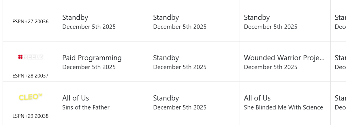

Still batting just about 0 on lane guide mapping. Recording gets set to a channel, records, and it's a completely different program.
Is there any way to dig in on the lane population, to see alignment?
it refreshes daily at 0300am and events could change channels unfortunately... are u setting your DVR up far ahead of time? does live channels match up?
Nope - same issue "live" vs recording - the mapping just ends up being incorrect.
These are on passes - so it will set a recording whenever it hits the guide data. I even tried a db refresh / reload guide in channels after stopping a "bad map" recording, and it didn't change the channel number.

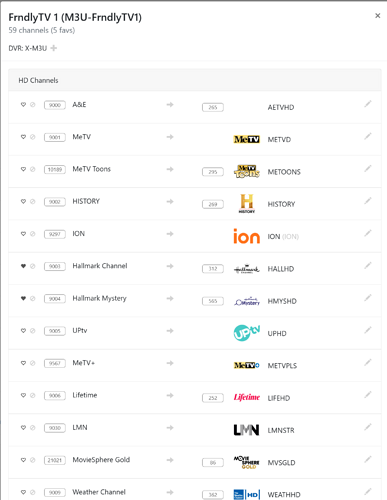

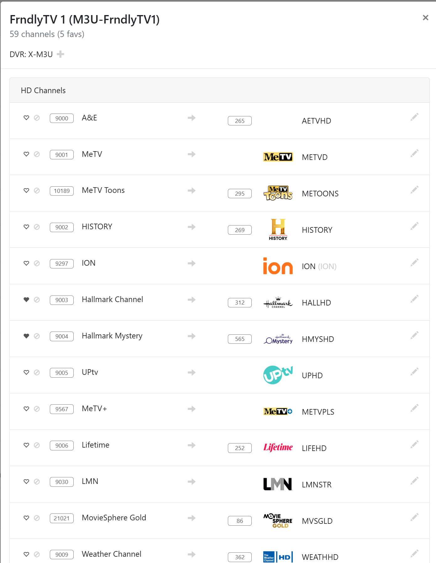

Hmmm - I'm thinking i may have channel overlap somewhere:
These are the only 2 though. Let me see if i can find where these are coming from
Uh. Yeah. No idea why preferred channels from this are all over the place. Will give them their own range now from Channels:
