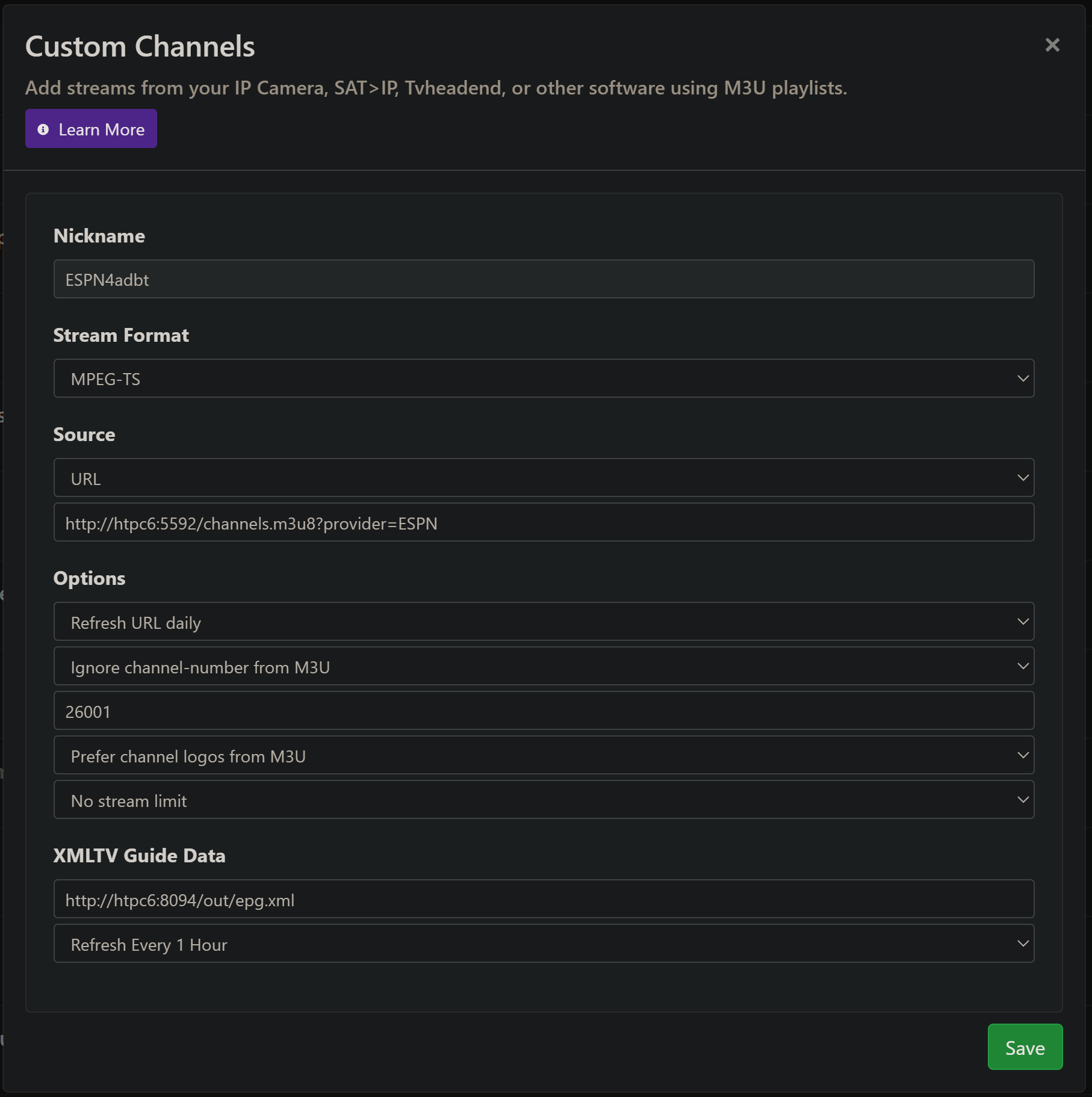

Driving me mad here. I'm so close.
I have only 1 channel that appears on source ESPN4adbt with guide data, but 150 channel-less slots on the actual ESPN4adbt source, and 150 valid channels, with no guide data, on the ADBTuner source. This is after a refresh AND trying a nuke/reinstall of the ESPN source, including the ADBTuner ESPN channels on the reinstall
full disclosure - i havent tried bnhf's stack yet, so not sure if it's his or mine giving you fits. do you have filters set maybe?
No filters set. Also tried a stop/db nuke/start.
Best guess is that the source insertion for ADBTuner only might be in play.
I've only tested with Ignore channel-number from M3U set and my own starting channel number, so try that if you haven't. You can also try using a starting channel of 20010, if that's available for you, as that's what's baked into the XML. These changes can be made right in the ESPN4adbt Custom Channels Source.
You can also try using the CDVR Delete and Recreate Database option under Guide Data - Maintenance, in case there's an issue with that. And, as a last resort, you can see if matching your channels to guide data under Manage Lineup works -- though hopefully it won't come to that.
Yep - i think the 20010 nailed it. That worked on my pre-one-click setup too, but assumed it was deprecated in one click.

Yep - we may be good here. Was able to start a live viewing on now-good data. Thanks!
Would you like me to add a preferred starting channum as an env variable? Guessing your project is fragile to that number (20010) but something I could add for ESPN4CC4C easily.
