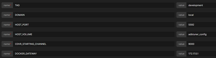

@hancox Can you post the current Docker Compose you're using for ADBTuner?
version: '3.9'

The compose looks fine. Both ADBTuner and ESPN4cc4c are running on the same system right?
If so, you'll probably need to hardcode a URL to reach ESPN4cc4c into each ADBTuner channel definition. host.docker.internal should work for Docker Desktop for Mac -- so I'm not sure what the deal is...
In each one of your 40 ESPN+ ADBTuber virtual channels you'll need to modify this value to something that works on your setup:
http://host.docker.internal:8094/whatson/1?dynamic_url_json_key=deeplink_url
Using the IP address of your Docker Host would be the safest, in place of the host.docker.internal part. Hard coding the URL was, of course, what I was trying to avoid. :frowning:
EDIT: Others are reporting this working, but I'm not sure if any are on a Mac.
Semi-confirmed - the curl command from within adbtuner gave a good reponse when replaced with my hostname.
Stupid question though - why couldn't this just be replaced by a DOCKER_GATEWAY env var? Am I missing something?
Not a stupid question. I'm just about to test a couple of things on a Mac Mini myself. I'll get back to you shortly.
@hancox
OK, try setting your DOCKER_GATEWAY env var value to host-gateway.
Like this (in Portainer-Stacks Editor, Environment variables section, Advanced mode) :
DOCKER_GATEWAY=host-gateway
This just worked for me on a Mac-Mini-M4 running MacOS 26...
