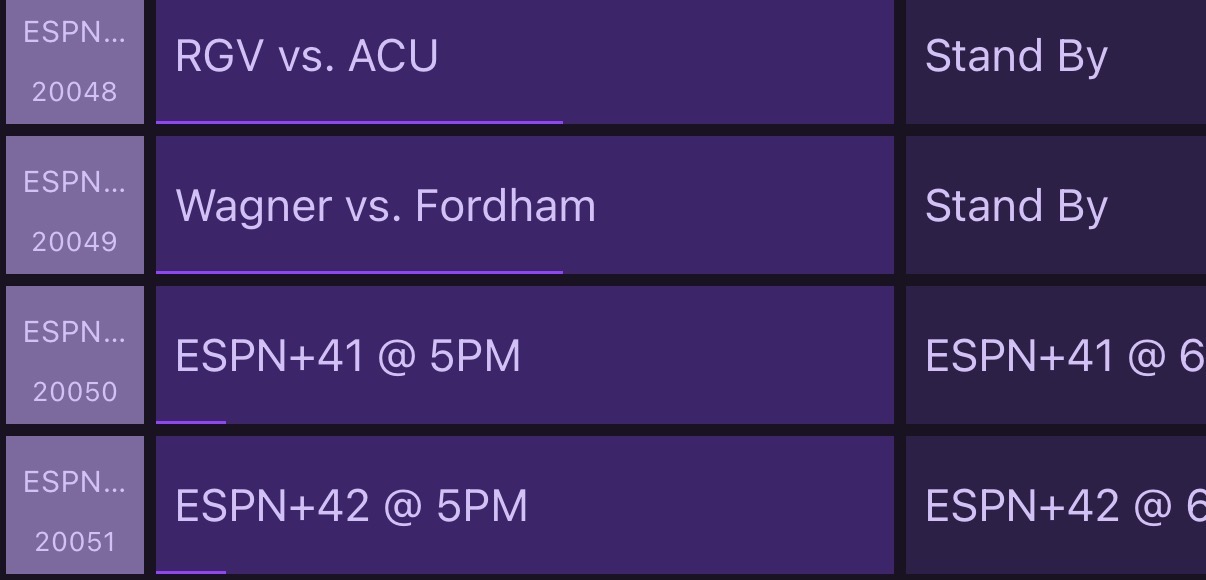

Yeah, think we'll need a way to change this. Haven't had time to dig in. But right now there must be more than 40 events happening because my Cincinnati/Dayton Men's College Basketball game isn't in the guide.
Did a quick test adding 2 channels (LANES=42) in container and editing ADB m3u. Source updates and guide shows extra channels but doesn’t populate with event info.

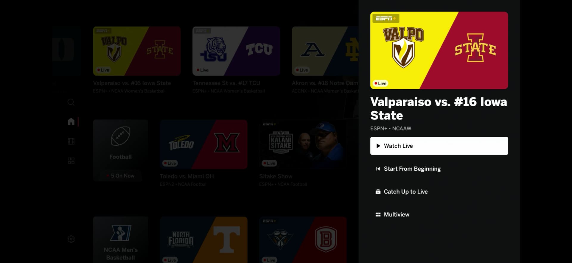

New container along w/ ADB tuner (ESPN+ Deep Links - Show Tuning Process), no Chrome Capture and a Firestick Max. Behavior has changed when selecting a channel from guide:
ESPN app opens,
Watch main screen comes up and holds there for maybe 8-10 seconds,
selection window moves down ?2-3 rows and over 1 column. This opens a pop-up menu for the event and stops there.
Same sequence occurs irrespective of channel selected and pop-up is not for event in the Channels guide.
Yep...same here. Not too sure what happened there. Pls assist @bnhf @KineticMan

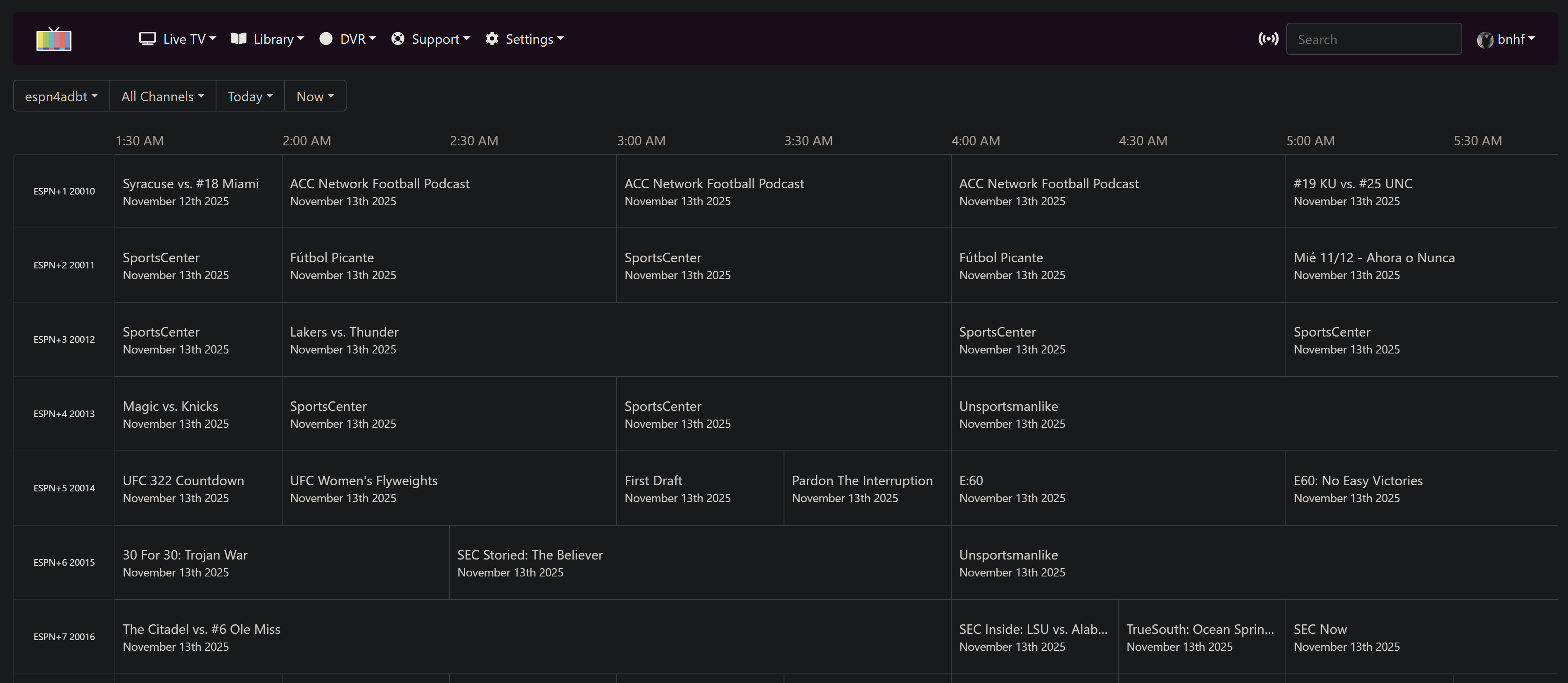

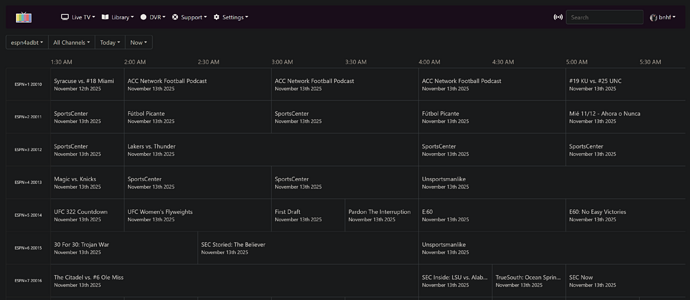

Here's my current guide data showing 7 channels with events:

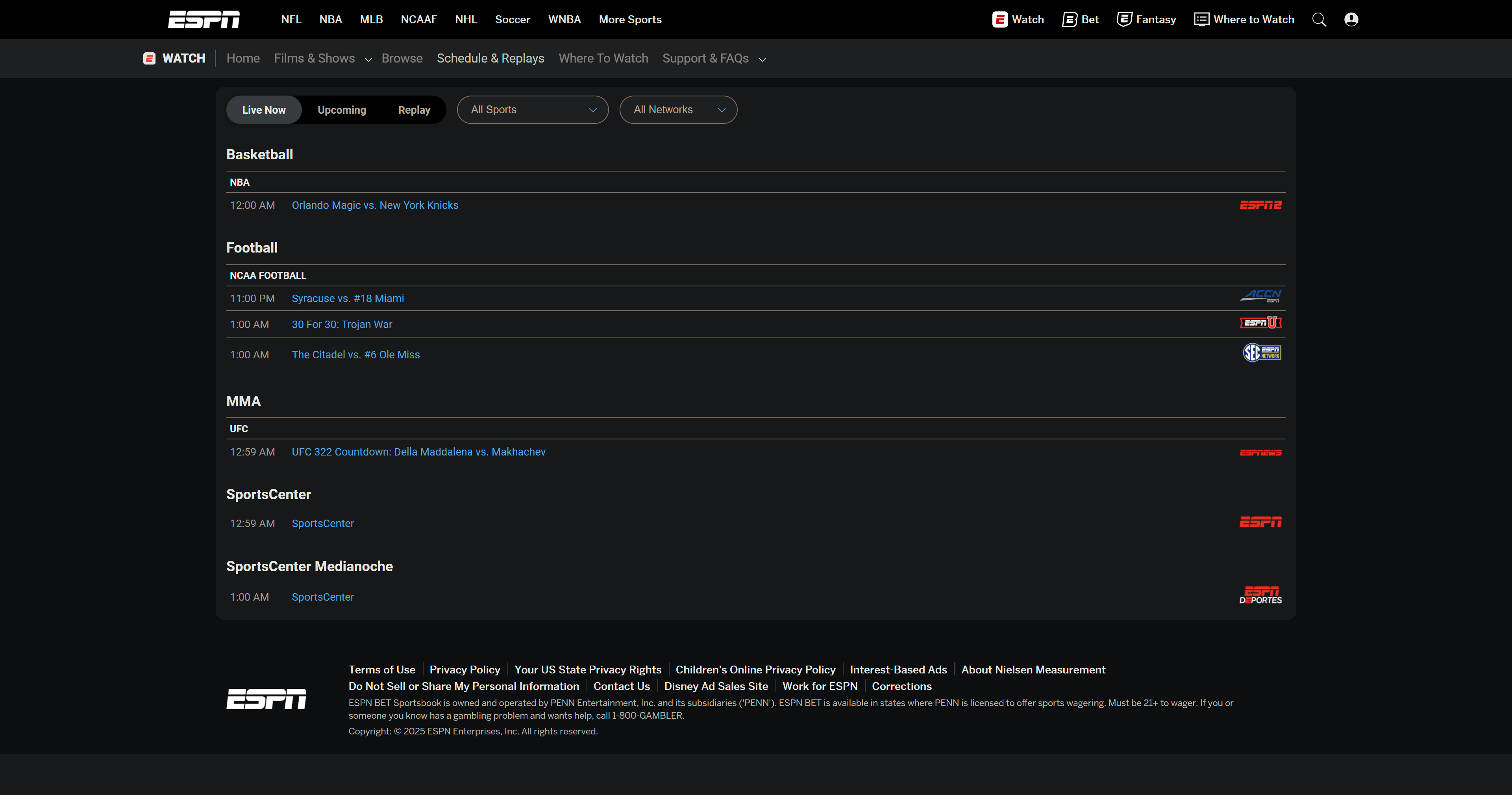

Those are the same 7 that show in the online ESPN schedule for the current hour:
However when I curl for deep links, they all show event IDs but no deeplinks. Is that because they're not ESPN+ live events?:
