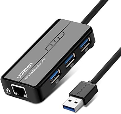

Does anyone know of a USB-C hub that would allow ethernet and external drive hookup at the same time. Would love to have ethernet for the Channels DVR server and not wifi.
Thanks. That looks like the perfect solution.

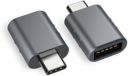

I have used this ethernet hub with TiVo Stream 4k and Amazon 4K Stick with different OTG adaptors. (Ethernet is part of device, hub supports storage)
This adaptor with USB-C (for TiVo)
This adaptor with USB Micro (for Amazon)
