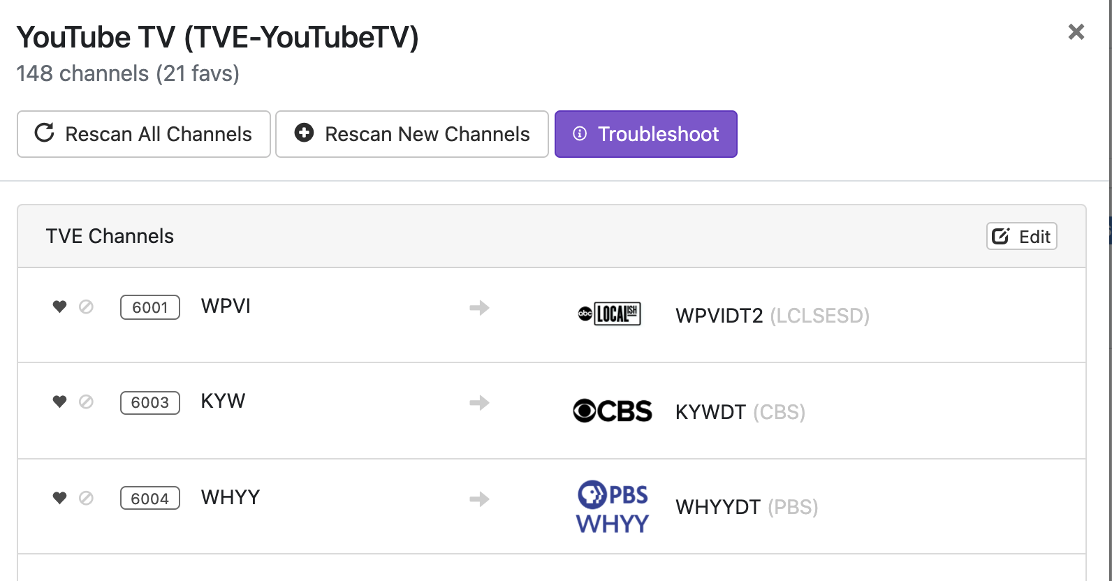

trying to remedy locast shutdown, I enabled locals for TVE today, with youtube tv. for ABC it pulled in a sub channel instead of the main channel. I'm able to login with youtube creds to watch at ABC.
ABC is crucial as WPVI can't be picked up with my antenna.
I added locals after upgrading to 2021.09.10.1459

Do I need to re-scan the channels? They are still mapped to the wrong station.
Try Settings > Guide Database > Maintenance > Delete and Recreate Database, followed by a restart of the server.
Yeah, did that. Still have the wrong mapping on both NBC and CBS via TVE.
I need diagnostics then, its not working as designed. It should have picked up the new Station values automatically

updated to 2021.09.10.1721 turned off local tve and re-enabled and now it's working.
CBS here in Raleigh WNCN is still showing as WNCNNFL even w/ 1721.
Logs have been submitted as 28cc5b08-623b-4240-b4ad-2a08c6423886 .
Looks good now. Thanks!
