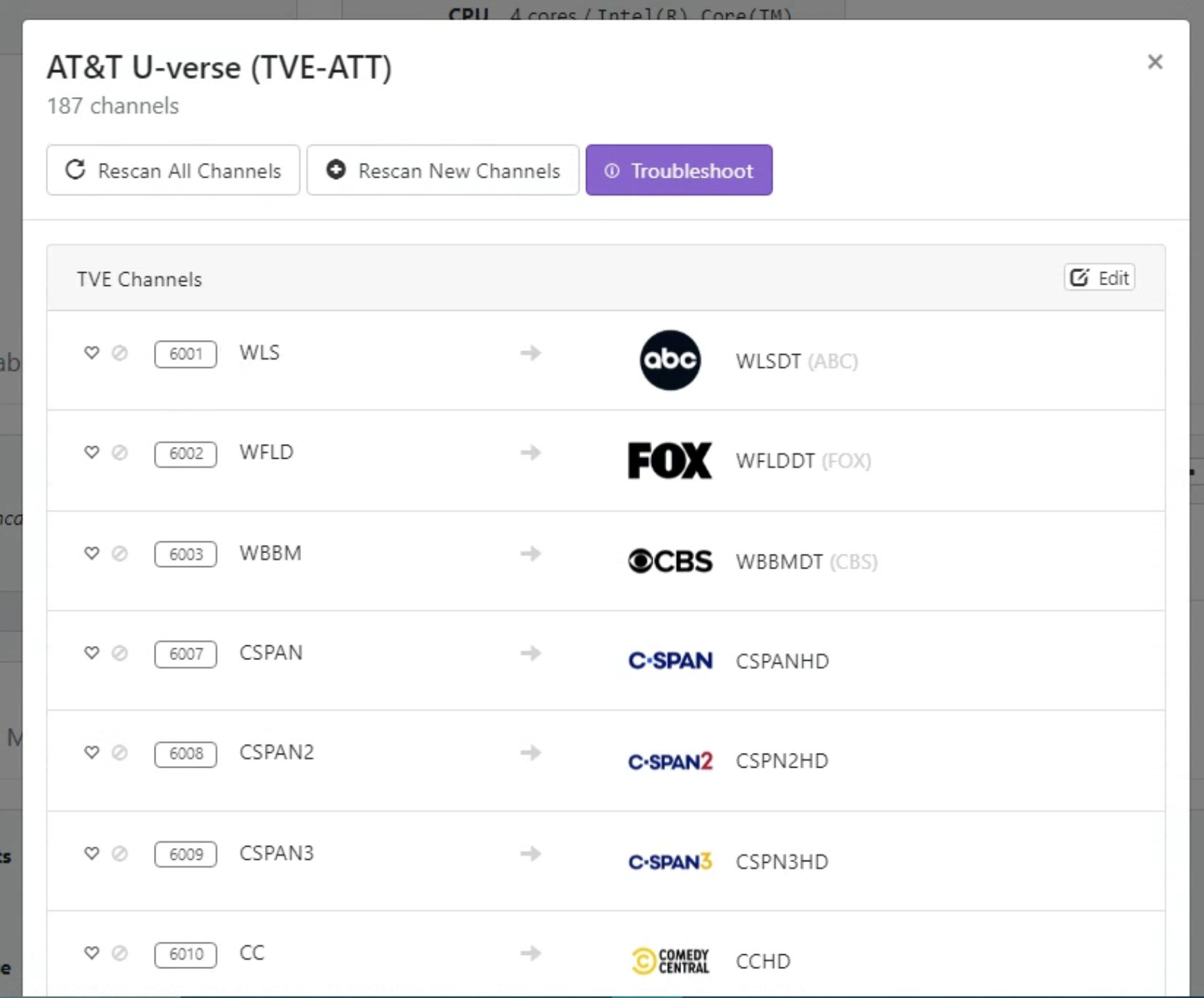

Is anyone having issues with NBC? I am able to stream it fine by going to nbc.com/live but it never finds it when I rescan.
Make sure you're running the latest prerelease version of Channels DVR, then try this, substituting nbc for abc
I tried this on chrome, edge, Firefox and Brave. When I login to NBC I only get NBC New York. I am in chicago. There is nbcchicago.com that has a live stream but requires no login.

Yeah, sorry I worded that wrong. So I can stream the NY through NBC but channels won't give me that correct?
I was getting the NY station in Channels DVR when NBC thought I was in NY.
Try following my linked post above and see what channel 6000 gets you.
