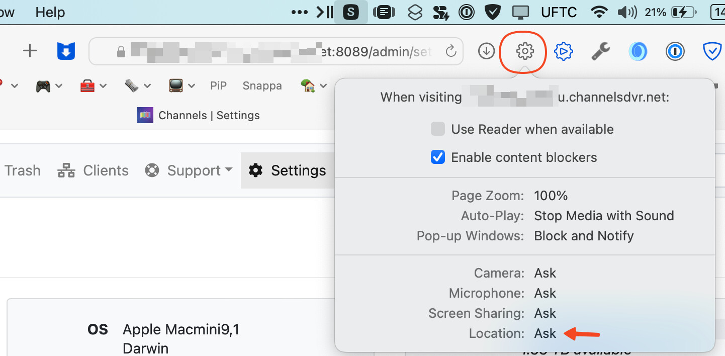

I just tried to turn that on and get a red triangle that says Local Networks via TV Everywhere
Your browser failed to retrieve your geolocation: User denied Geolocation. any idea how I would fix this?
I was doing some other digging around and noticed that there is no use either is there a way to get that?Sorry for all the questions I'm pretty new to all of this
What web browser and computer platform are you using? Windows, Mac? Asking because you probably have some privacy setting enabled that doesn't allow the software to share location, and this server, as a website, needs access to that location information, so it can determine what local channels you're allowed to stream.
Hopefully that gets you going in the right direction to figure that part out!

If the server is running on a macOS Ventura system too, check under:
Apple Menu > System Settings > Privacy & Security > Location Services
Earlier macOS instructions here: Allow apps to detect the location of your Mac - Apple Support
Also check the webpage permissions, change this to "Allow," might help?
We're veering off-course from the topic here though and this type of troubleshooting probably warrants its own thread. I hope this helps!
sorry I did get to figured out. thank you for all your help
