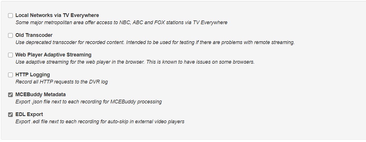

Did you try unchecking Local Networks via TV Everywhere ? That way it will not try NBC I do not have that checked as I use Connects for locals.
You're missing the whole point.
You can't check or uncheck anything until you've added the TVE Source to Channels DVR.

Did you see my snapshot above ?
You have Never even setup your DVR did not know that good luck .. I always setup my tuners first.
