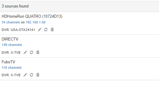

After some time has passed, access to TVE streams stops working,
i.e. shows stop recording.
to date the only resolution I have it to remove the source and add it back.
after which the shows will again successfully record for some as yet determined period of days.
It seems authentication is not automatically refreshed on its own nor when a source is re-scanned
also i did not capture screen shot but performing a refresh
The number of channels went from 100 + to about 45 channels.
first set of logs below are from a channel scan
second set are during the adding source back.
