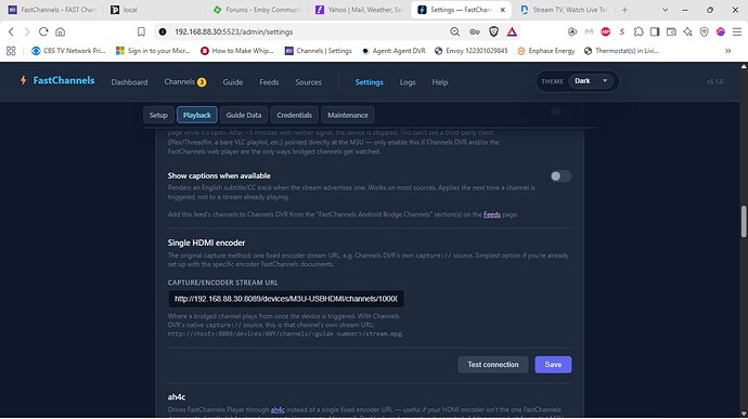

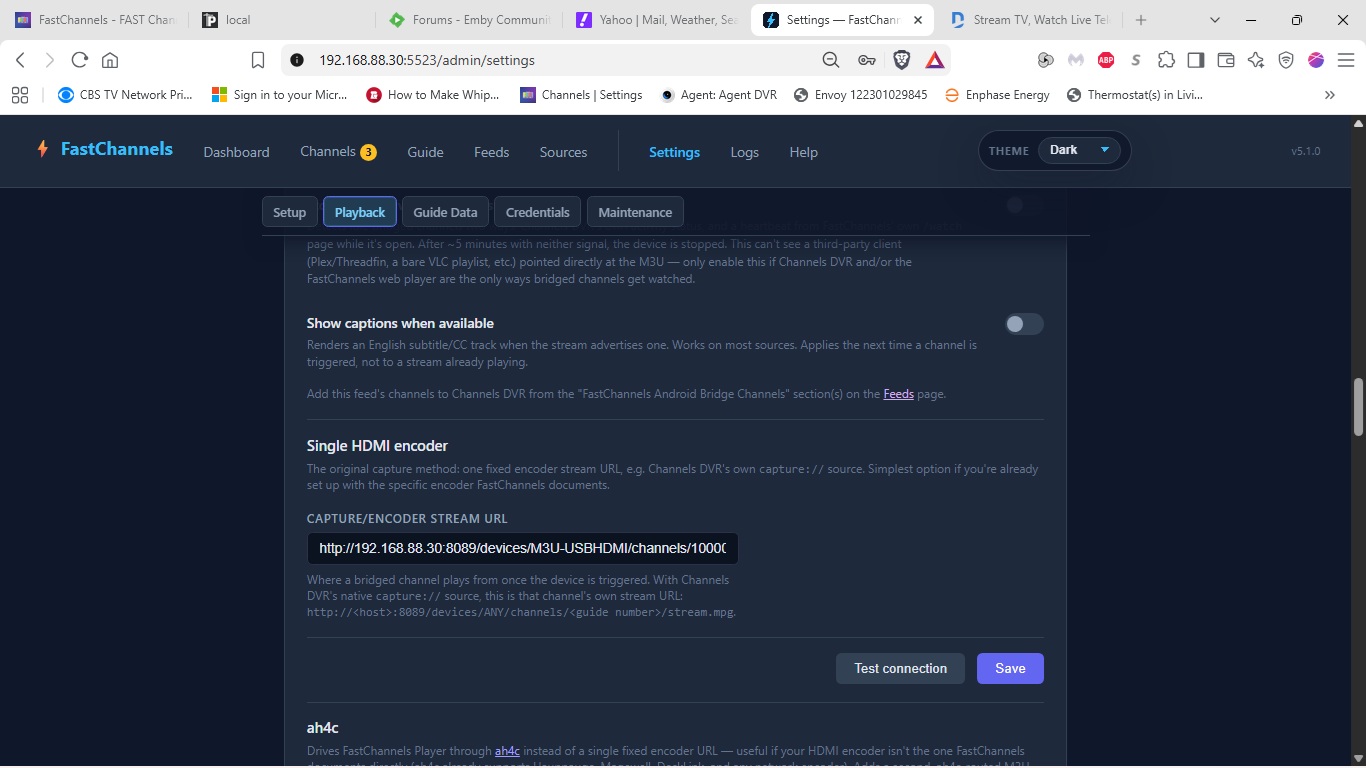

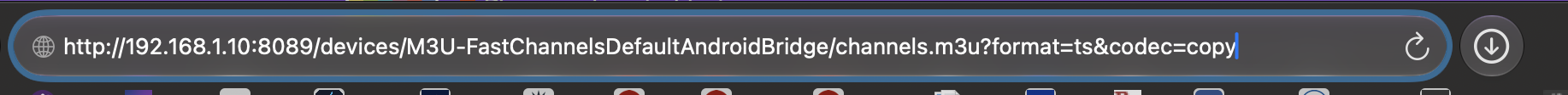

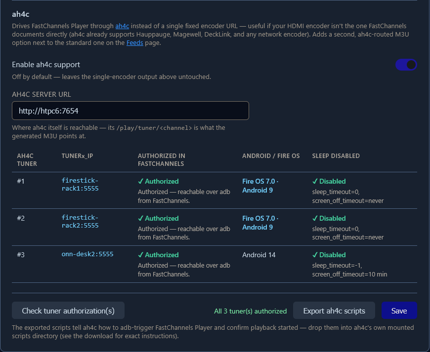

ah4c is not involved then. Put your "virtual encoder" URL (as we've discussed at length previously) in as the Capture/encoder stream URL value, and turn off the ah4c bridge.
That's what I did. I also removed the ah4c server url.
Does the "Test connection" button work? What do the FastChannels logs show when you try to tune?

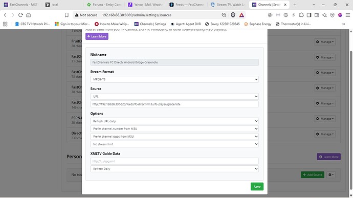

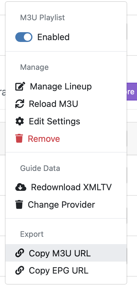

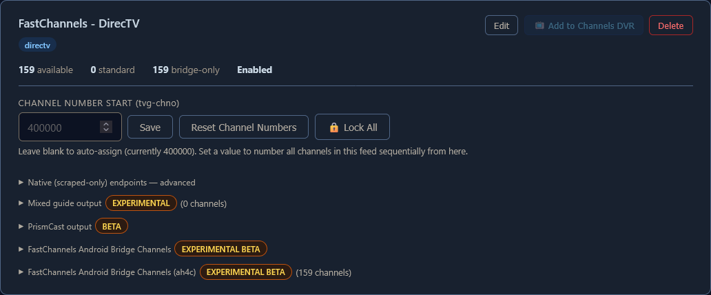

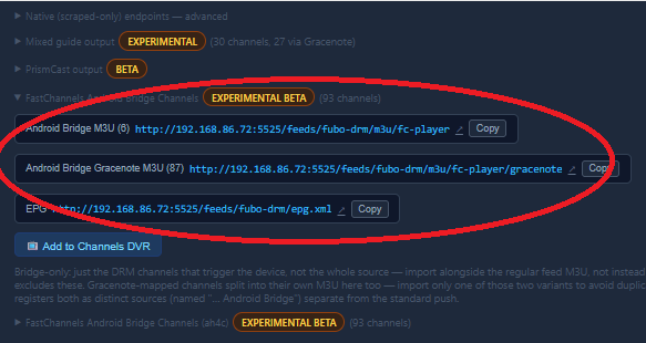

I'm not seeing the #EXTINF info. Here are screen shots of what I did:
FastChannels and tuning works great...just not getting the video back. Since I don't see the #EXTINF data, I can't figure out what number to use (ex: yours is 70092):

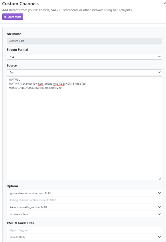

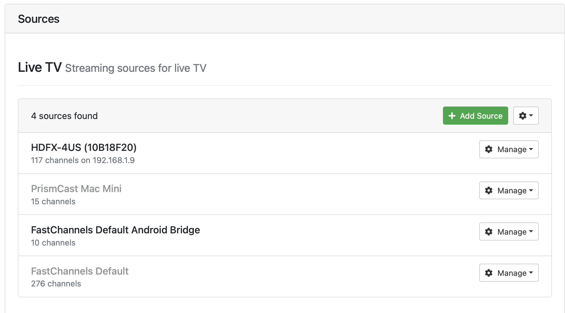

oh! you have to setup the camera as a seperate source. that's the missing link. see posts 1, and 2 here for setup. (ps don't disable the source like he recommends - i found it problematic).
edit: here's my setup (on ubuntu fyi)

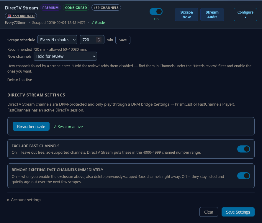

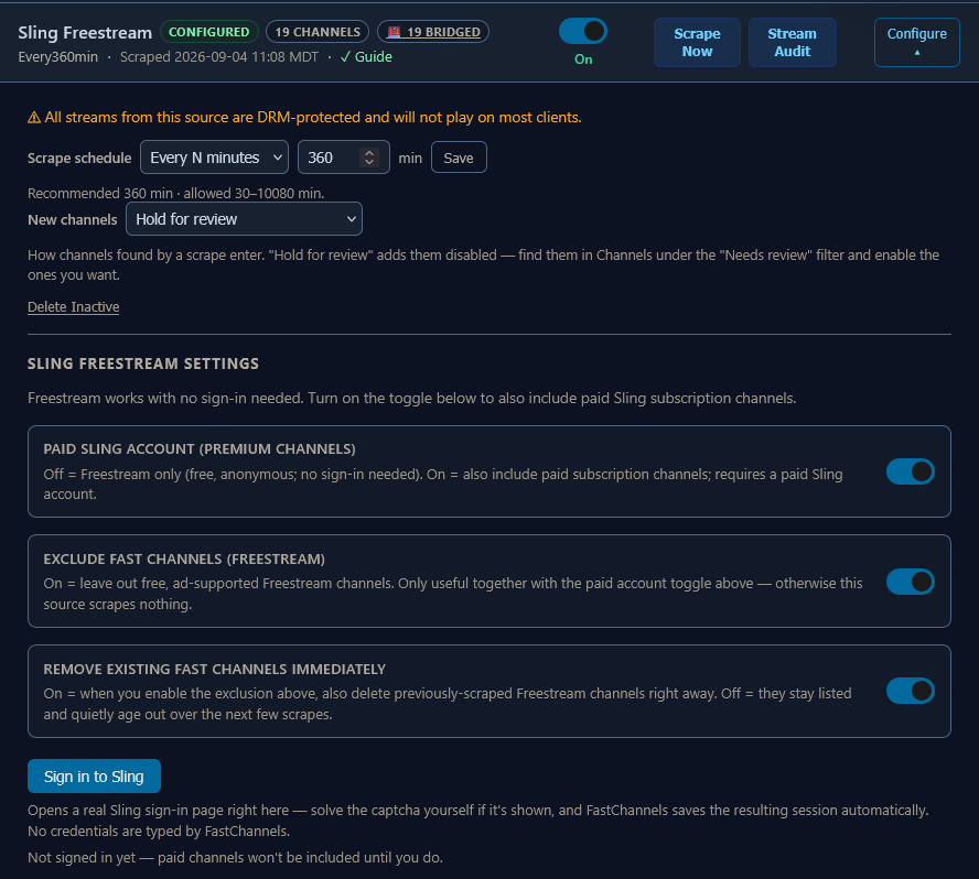

I added an option to both DirecTV and Sling to be able to exclude FAST channels. This is done through toggles, and each also has an the option to purge the identified FAST channels immediately, without waiting for them to "age out".
Also, DTV is one of the few (only?) sources that provides correct Gracenote Station IDs via their API, however those IDs were not being utilized. They are now the first choice where DTV is concerned, only dropping back to the community map where they are not provided (this is typically only the case with some legacy channels that only show-up for satellite subscribers).

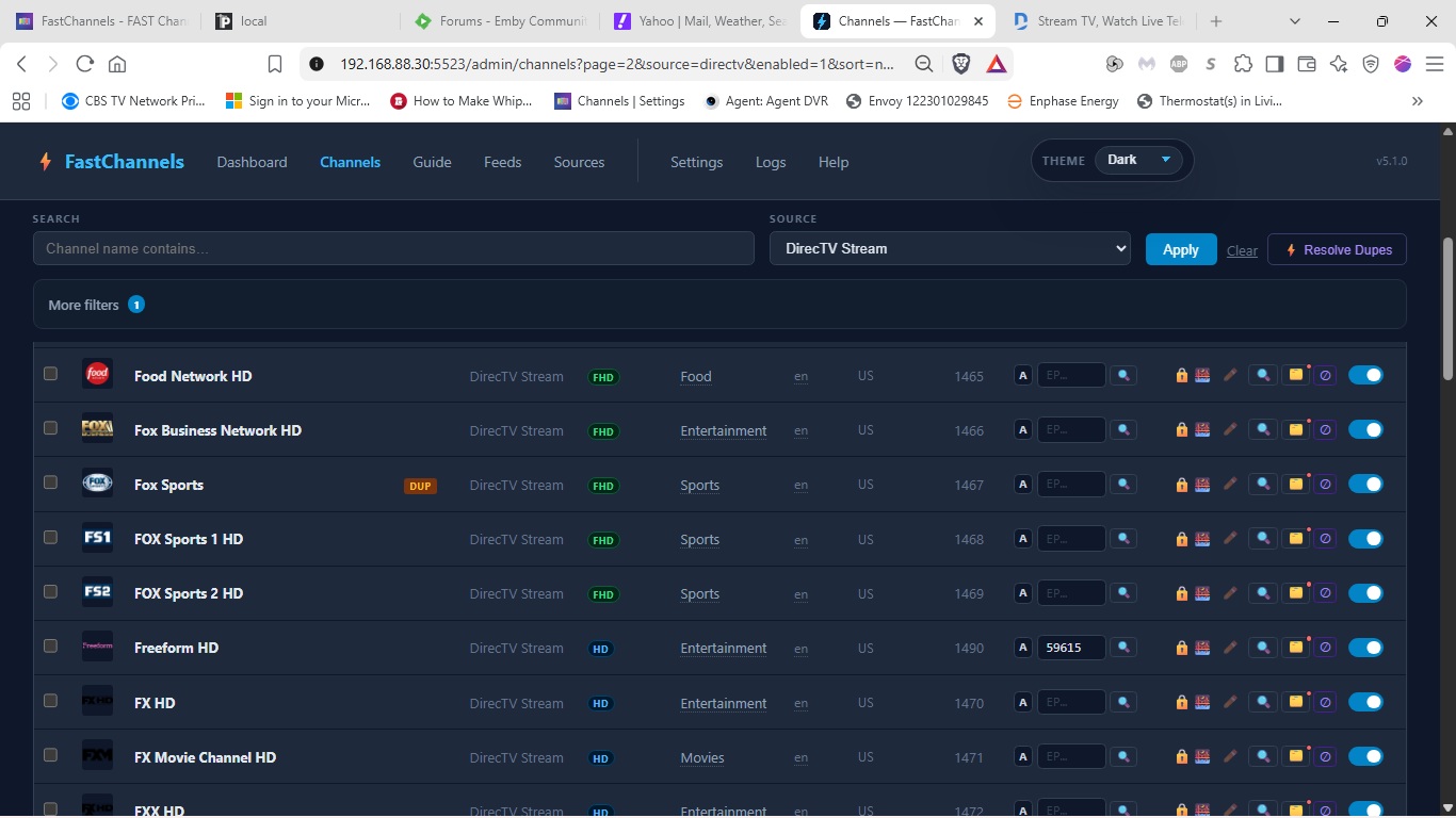

But it still does not tune a channel. I've tried Espn2 and the app tried channel 881, my directv guide shows it as channel 209. I also tried Freeform, the app tried to tune 4211, my guide is showing it as channel 311.

@bnhf has said the Directv Stream channel numbers do not match up to the Directv Satellite channel numbers (which is what I subscribe to). I checked the fastchannels.db in \data\docker\volumes\fastchannels_db_data_data and Freeform shows its channel id as 4211 which is not correct for my sub.

Well I don't understand then why any channel I've tried doesn't match my channel number. I've just tried Fail Army which FC has 1000963 as the channel id and my Directv guide shows it as 4301.

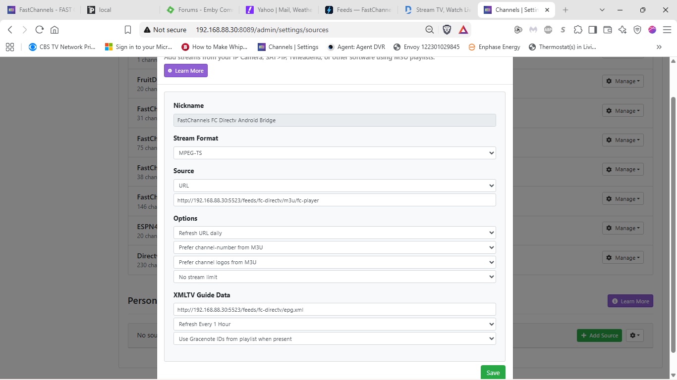

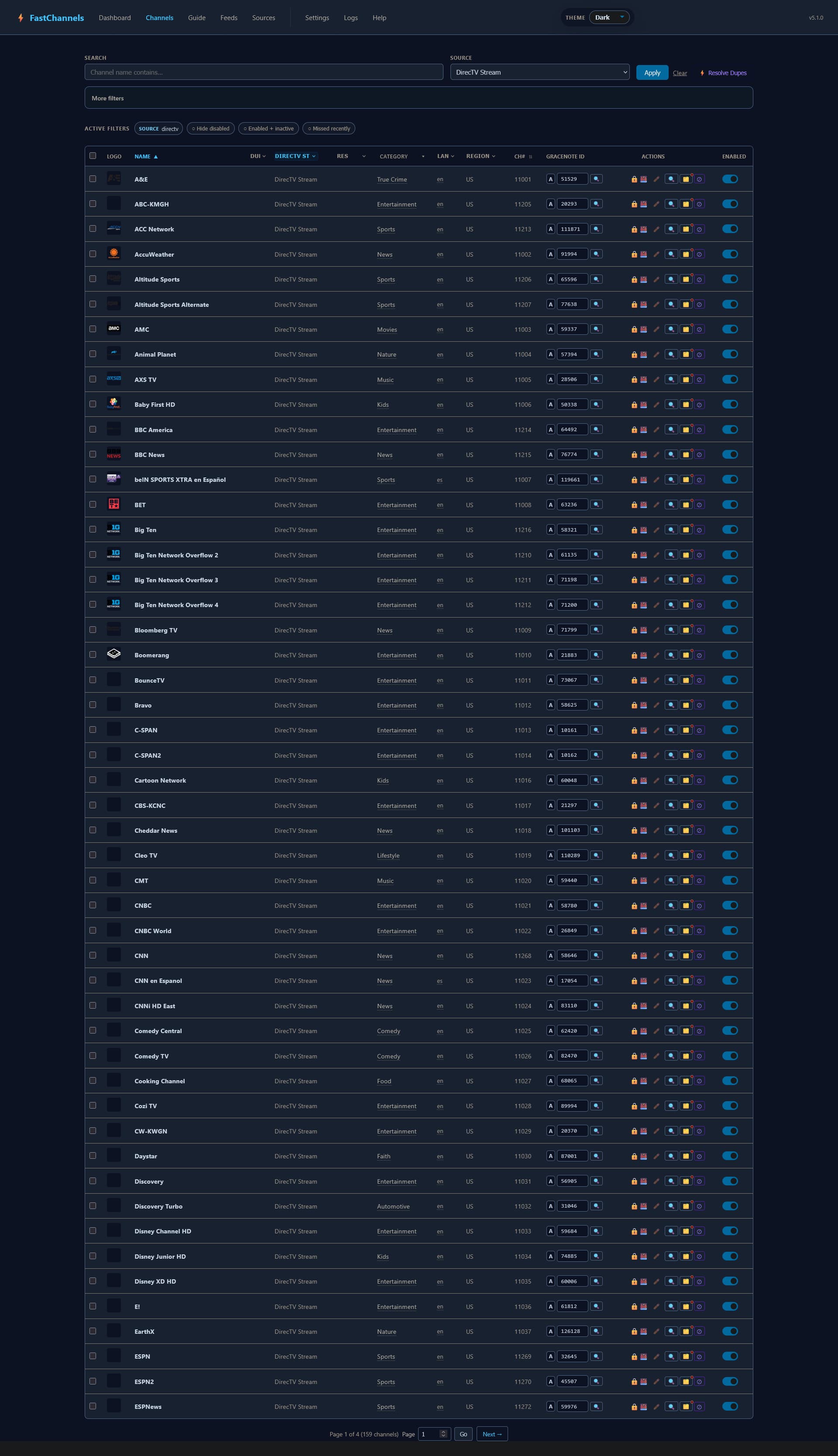

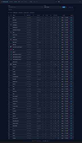

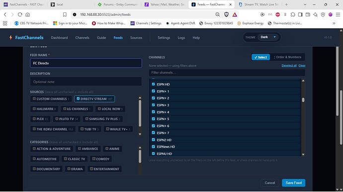

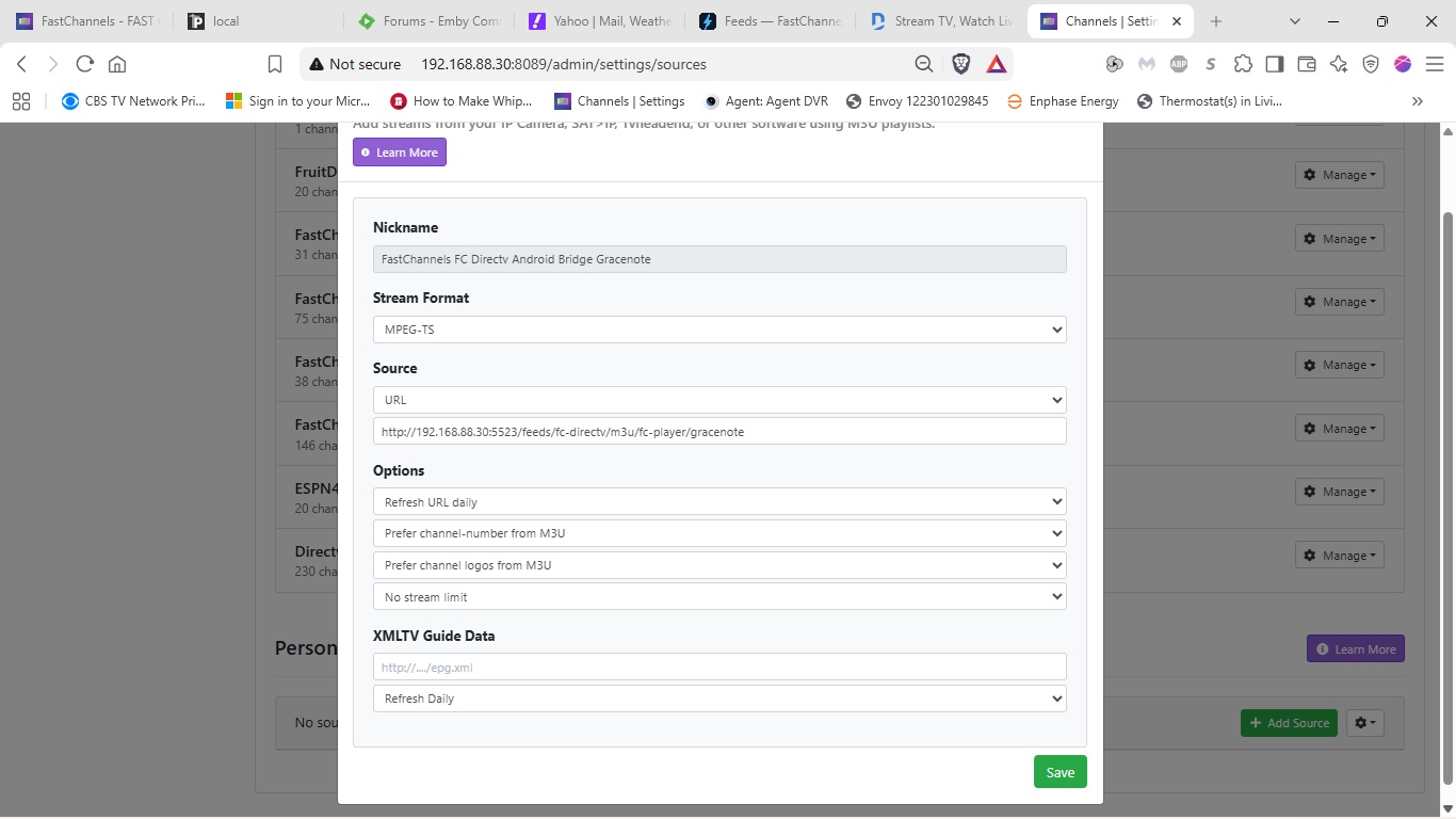

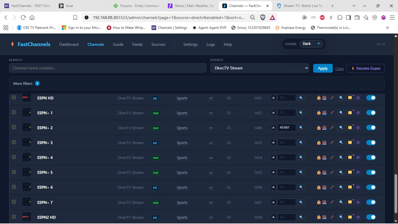

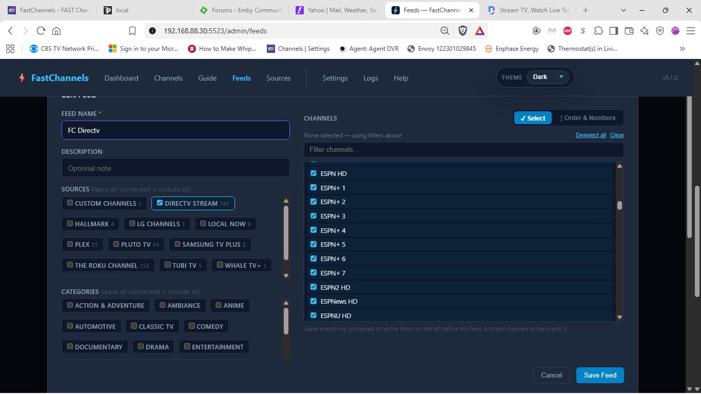

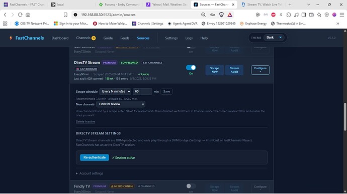

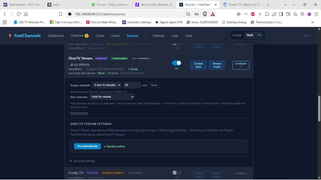

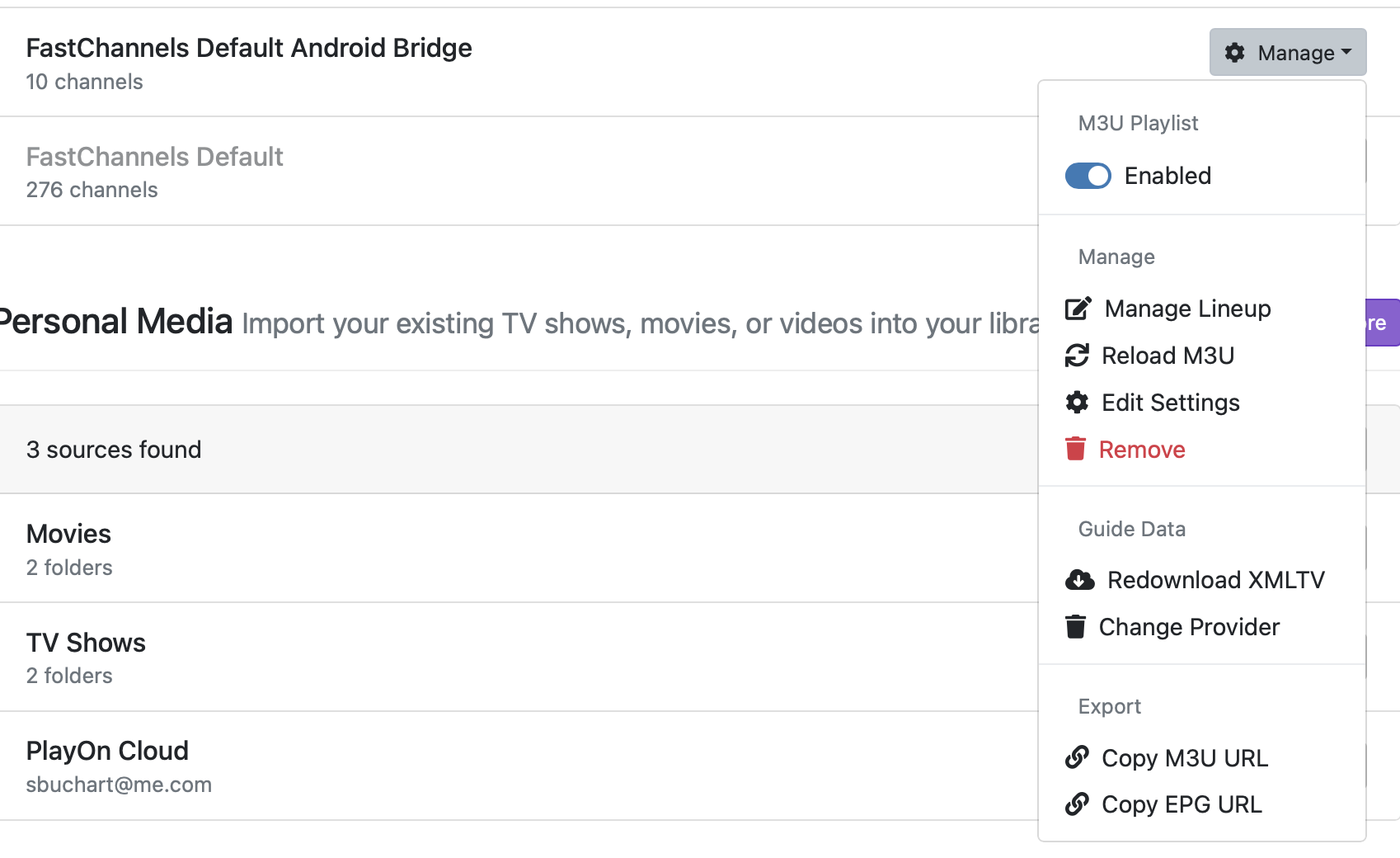

At this point I think it would be helpful if you started posting some screenshots of your FastChannels setup. Obviously, something is very wrong, but without more information on your configuration it's hard to tell what. I'd suggest screenshots of your FC Sources setup for DirecTV, the HDMI bridge, and at least a few pages of your enabled FC Channels for DirecTV.
You will probably have the same issue with YTTV. Google is insane with their Widevine.
Here you go.
@daldana7296

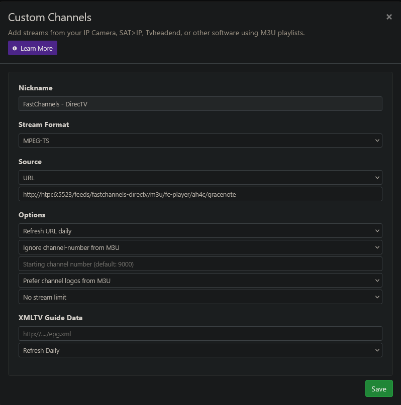

For example, here's my whole "suite" of screenshots:
Custom Channels sources.
Everything looks dialed-in there. At this point, one has to wonder if there's a deeper issue related to you being a Satellite customer. This is probably something @KineticMan will need to look at.
