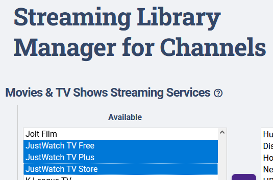

I'm not seeing a FAST service nor mention of it in any of the articles; only seeing the On-Demand stuff. SLM has already picked those up as new providers...
... but I might have to do something special to get their deep links (assuming JustWatch's app is actually set up to accept deep links). The streams themselves are DRM, so SLM Streams are out of the question.
EDIT:
Stream Link generation is now working as of SLM v2026.10.21.1113. Haven't tested if they actually open the app, though.

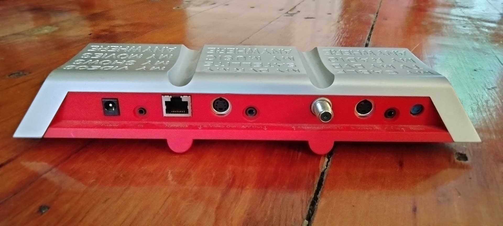

I'll give you one. I still have an operational legacy Slingbox with composite analog video out from the cable box feeding it, as well as have Slinger able to restream its "raw" feed. So I have access to Spectrum that way without DRM. That stream however is seriously "raw". It needs to be restreamed with ffmpeg to add critical metadata to the stream thereby make it consumable and recordable within either Channels or Emby. I've done that reprocessing with physical files I saved from Slinger, but tried and failed using a Docker container to restream it in realtime. I'm now eager to tackle that again. And make Custom Channels within FastChannels (see how I came back full circle? Hehe) that will tune my cable box to the correct channel using a Slinger URL request in the .m3u file for the channel.
Eager to hear everyone's favorite Docker containers I should also run. Thanx!
oh man .. I think I still have my old one somewhere in the box of old electronics. That'd be a fun project to dig out -- maybe hook it up to a HDMI encoder or something?

needing this instead of an HDMI encoder (which may have DRM issues): GitHub - GerryDazoo/Slinger: Reuse SlingBox hardware without SlingBox Servers · GitHub
However if you hadn't gotten your admin password from that old device using the Sling org's Username+Password authentication before it was shutdown...
Slinger/sb-pwd.md at main · GerryDazoo/Slinger · GitHub [preview removed]
...I'm not sure if you can use Slinger. Tho consider me a neophite with all this stuff; maybe it can be attained another way if you don't have it already. Then I assume a component video encoder is needed, which I do have.

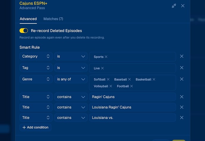

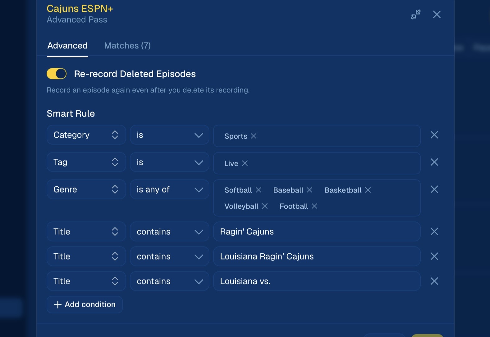

The ESPN filters really helped in managing the number of required channels for a specific sport and I really appreciate that. Right now I'm concentrating on (1) pass but would affect others passes that I use.

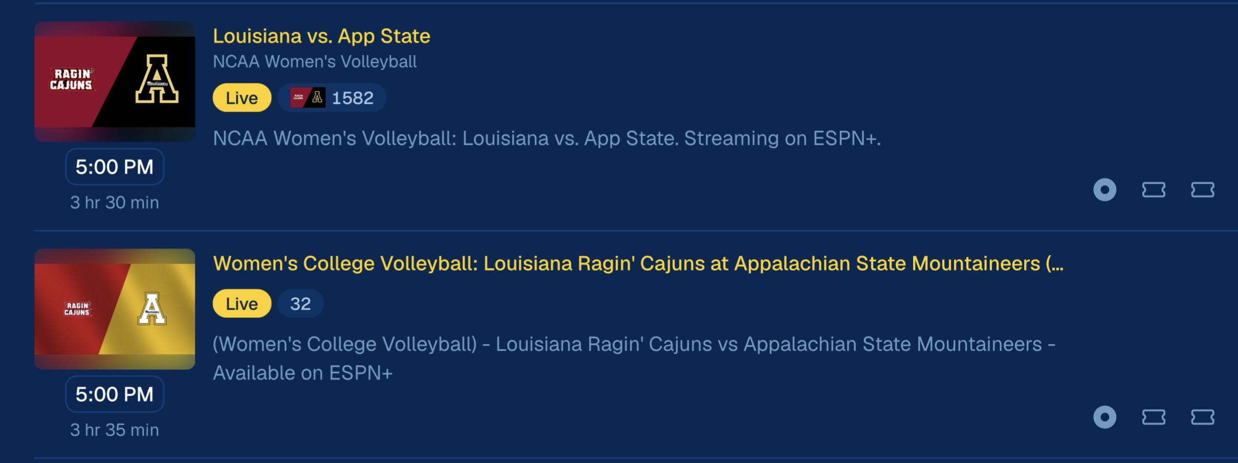

This screenshot is from my CDVR schedule for this evening. The game is the same for both. The top entry is using FC and the lower is from FDL/ADBTuner. My preference is the FDL look. Both are scheduled thru an advanced pass with the criteria in the 2nd image. I had to add the "Louisiana vs." Title rule to add the FC channel to the pass. I could have used just Louisiana but I didn’t want to hide the other 7 state schools.
The passes are easily managed with a little intervention but I'm hoping for a future non- intervention type pass. This is great work!!!
